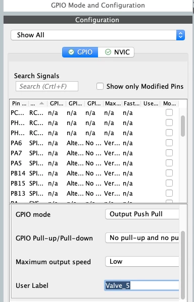

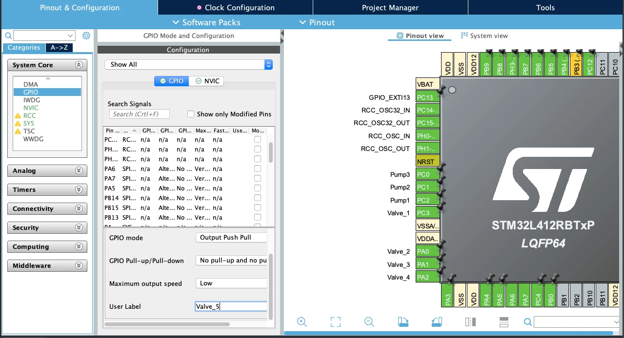

Possible New Bug in CubeMX 6.1.1 when naming USER labels on IO pins
After updating to the latest release of CubeMX (6.1.1) I am seeing a bug in how the naming of IO pins with User Labels.
0693W000008GCgXQAW.png0693W000008GCk0QAG.pngWhen typing the User Label in, the field auto selects the text and erases the value typed in. This did not happen in the previous version.
This is on macOS with Mojave (10.14.6) on a Mac Book Air 2015.
The work around is to use the arrow keys to un select each time a new character is typed.

Hello @C Austin​
I think there was an update issue, so could you please uninstall and re-install the CubeMX from site ?
Hope this will solve the problem, I'll be waiting for your feedback =)
Thanks, Khouloud

I downloaded and installed CubeMX from the link provided, and this problem is fixed.
Thanks!
