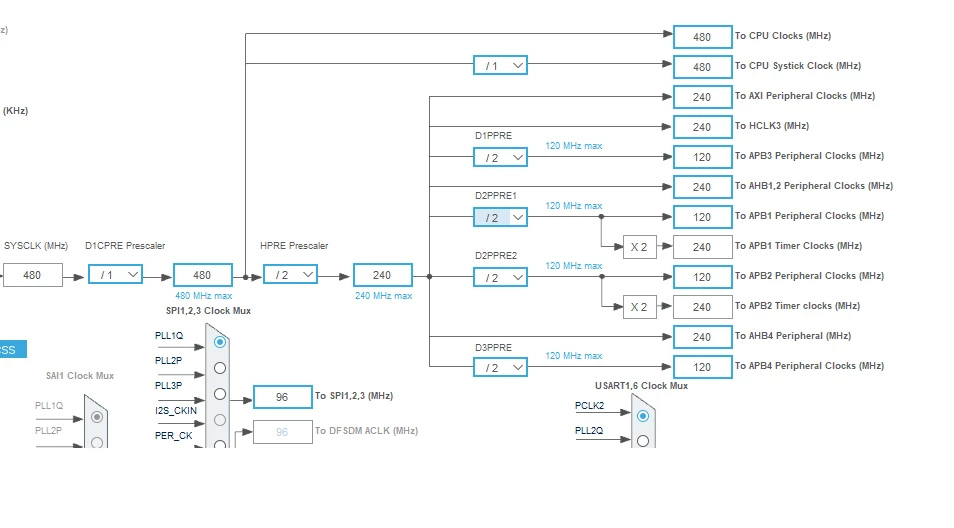

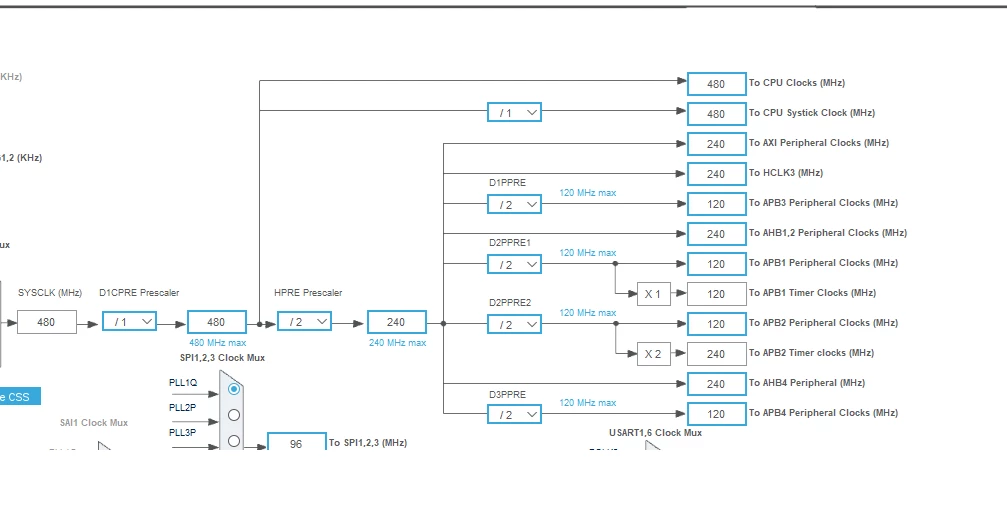

I am writing to report a concerning inconsistency I encountered while migrating an older project to the latest version of STM32CubeMX (v6.17.0).
Background: I recently reopened a project originally created about two years ago with STM32CubeMX v6.8.1 for the STM32H742VGTx MCU. My goal was to review the Timer 4 settings to use them as a reference for a new design.
The Issue: Upon inspecting the Clock Configuration tab, I noticed that the APB1 Timer Clock was displayed as 120 MHz. Based on my original project notes, this value should have been 240 MHz.
When I calculated the Timer 4 period using the 120 MHz figure, the resulting timing was twice as slow as it should be. While checking the documentation, I confirmed that Timer 4 is connected to the APB1 bus. In the CubeMX interface:
  • The D2PPRE1 divider was set to /2, resulting in an bus clock of 120 MHz (which is the limit).
  • However, the Timer Multiplier was stuck at x1, leading to an APB1 Timer Clock of 120 MHz.

  3. I tried to resolve the issue, I manually changed the D2PPRE1 divider from /2 to /1 (which triggered a red error highlight due to frequency limits) and then changed it back to /2. After this "reset," CubeMX correctly recalculated the values, the multiplier automatically jumped to x2, and the Timer Clock returned to the correct 240 MHz.
Concerns: This behavior is quite alarming. If a developer needs to make a minor change and regenerate code for a legacy project, such "silent" shifts in clock calculation could lead to critical timing errors in production code without any explicit warning.
I have attached screenshots showing the state before and after the manual refresh. I kindly request the CubeMX team to investigate why these multipliers occasionally fail to update correctly during project migration or when loading older .ioc files.

While trying to figure out the issue on my own, I realized that the problem might not be caused by the new version of STM32CubeMX, but perhaps by the older version I was previously using.
I backed up the .ioc file generated by STM32CubeMX v6.8.1 and opened the project in the latest version of CubeMX. I applied the method I described earlier to change the multiplier from x1 to x2 and saved the project. Then, I opened the new .ioc file (saved with v6.17) in Notepad and compared the differences between the two files.
In the older version's file, I noticed a line: RCC.Tim1Mul=1, which does not exist in the new file. This specific parameter is not something I can manually change through the GUI. However, this discrepancy exists.
In the old file: RCC.Tim1Mul=1 RCC.Tim1OutputFreq_Value=120000000 RCC.Tim2OutputFreq_Value=240000000
In the new file: RCC.Tim1OutputFreq_Value=240000000 RCC.Tim2OutputFreq_Value=240000000
I’m not entirely sure what the underlying issue is, but everything was correct when I first created the project; the code is still running and there are no functional problems. It seems there was some kind of bug or inconsistency between CubeMX versions during the migration.
