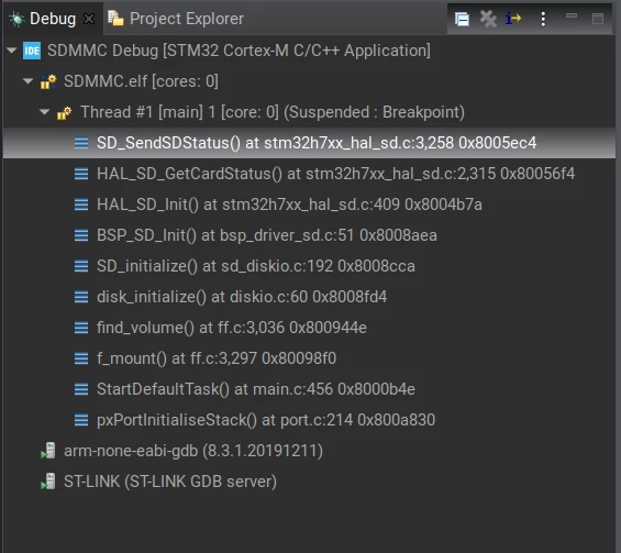

The second problem is much more serious. During the initialization the "SD_SendSDStatus" procedure is called (see attachment) and here it doesn't leave the status query loop ("stm32h7xx_hal_sd.c", lines 3258ff):
 /* Get status data */
 while (!__HAL_SD_GET_FLAG(hsd, SDMMC_FLAG_RXOVERR | SDMMC_FLAG_DCRCFAIL | SDMMC_FLAG_DTIMEOUT | SDMMC_FLAG_DATAEND))
 if (__HAL_SD_GET_FLAG(hsd, SDMMC_FLAG_RXFIFOHF))
 for (count = 0U; count < 8U; count++)
 *pData = SDMMC_ReadFIFO(hsd->Instance);
 pData++;
 if ((HAL_GetTick() - tickstart) >= SDMMC_DATATIMEOUT)
 return HAL_SD_ERROR_TIMEOUT;
The code seems to be illogical to me: it should wait until these 4 bits are cleared, but instead it waits until one of these bits is set (one of these errors occurs)! Or am I reading this code wrong? This loop runs with a timeout of about one year ... Really, I don't want to wait so long.
Only the first three are error flags. The last flag (DATAEND) indicates the end of the transfer and is the normal way of exiting that loop.
Agreed that the default timeout seems silly.

About the second problem: Great! Now I know that I have correctly understood the content of Chapter 55.9.11 in the manual "RM0433" about the status register.
But it doesn't solve the problem. Since there were no transfers before the interface was initialized, "DATAEND" (bit 8) cannot be set. This "faulty" state is not caused by my hardware or my code. Or am I still getting it wrong?
