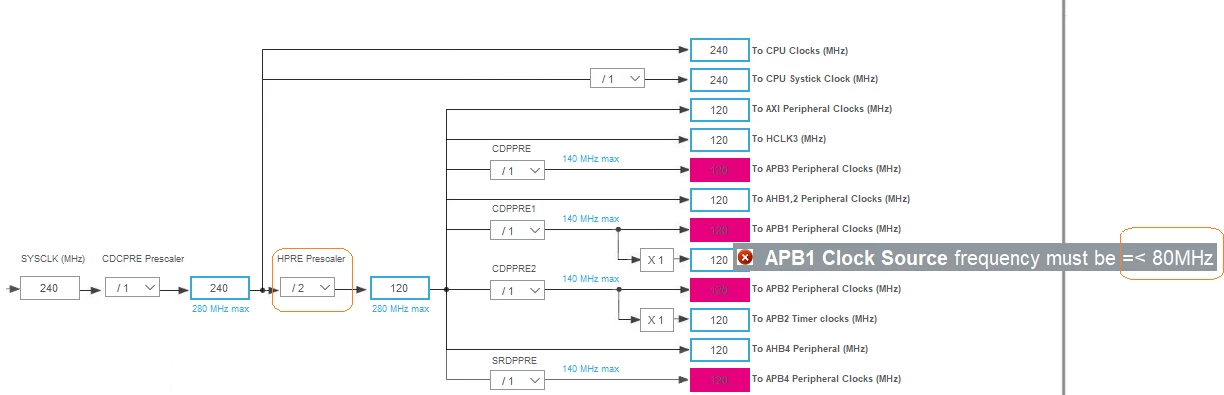

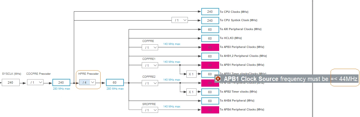

1) When changing HPRE prescaler only CubeMX unexpectedly changes timer clock limits.
I think those limits should depend on VOS voltage which, in turn, depends on SYSCLK, rather than on post-HPRE clock. As a result, lowering timers' clock lowers the max limits - see the screenshots. This does not seem to make sense.
2) Interestingly, AHB1, AHB2, APB1, APB2 and AHB4 clocks do not get the warning.
3) Setting DFSDM1&2 clocks higher than the max allowed 140MHz does not cause any warnings. It is a bit unclear what max DFSDM clock is. In Table 23 on p. 84 DS13195 specifies 140MHz while in Table 107 on p. 162 it states max fDFSDMCLK is fSYSCLK.
