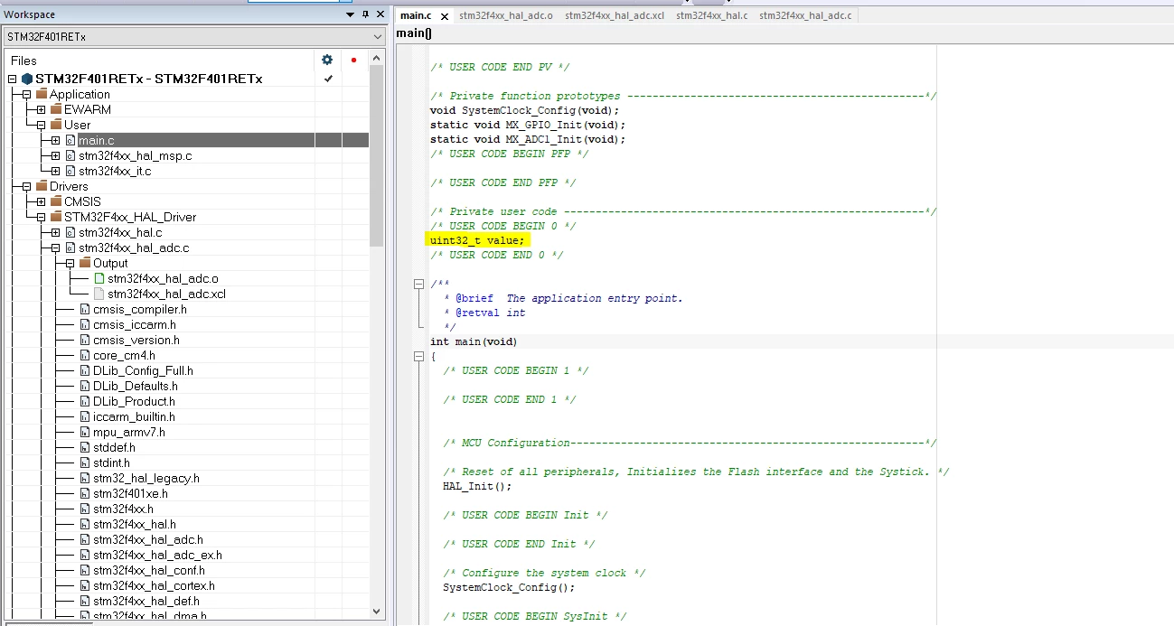

PollForConversion function is supposed to convert analog values. But, after conversion I get only few values i.e maximum minimum and mid values. Could anyone help me in this regard.

Hello @RPOOJ​
Thanks for the feedback.
I test it with using STM32F401RETx then i had no problem.

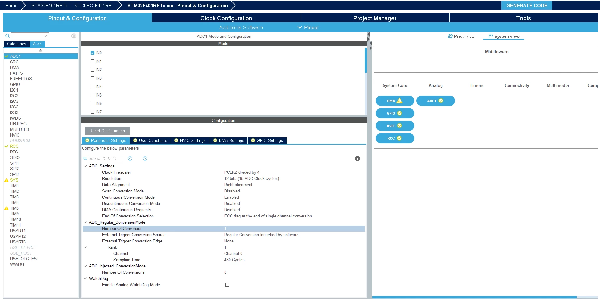

How to reproduce:
  1. Open CubeMX the select board :STM32F401RETx
  2. Select ADC: IN0 ==> * Go to Parameter Setting: Enable Continuous Conversion Mode, *Go to Rank: Sampling Time: 480 Cycles
  3. Activate RCC==> High Speed Clock (HSE): Crystal/Ceramic Resonator0690X00000983L0QAI.png
  4. Generate code

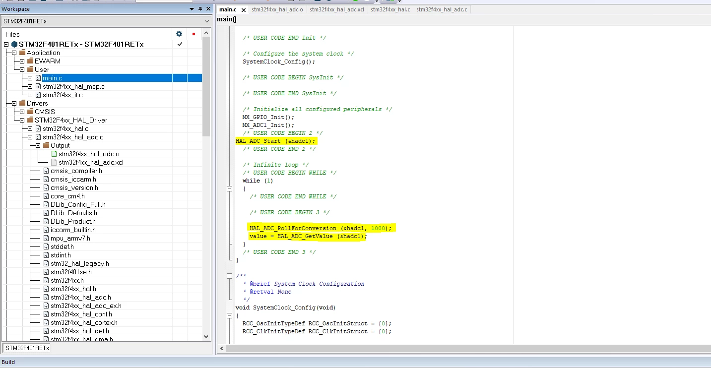

  5. In the main.c file : create a variable to store values from ADC0690X00000983MIQAY.png

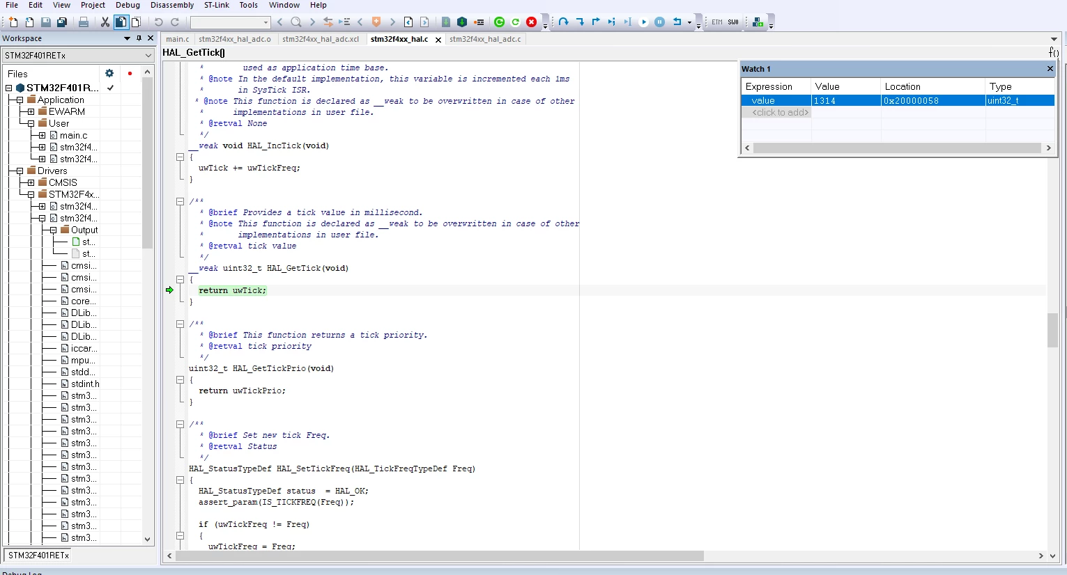

  7. Compile
