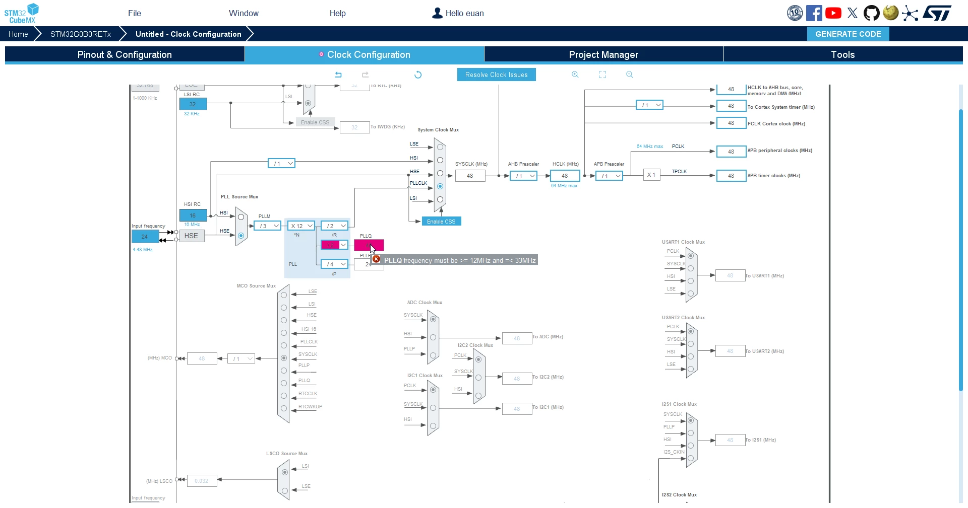

PLLQ maximum frequency reported as 32MHz using STM32CubeMX v6.11.1

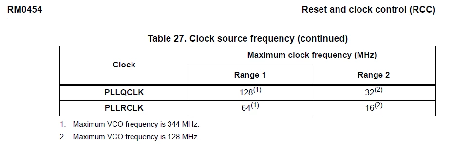

Somewhere between CubeMX 6.9 and 6.11 a bug has been introduced that reports the PLLQ can only be less than 33MHz.
It is not honouring the Voltage scale set in the RCC parameters.
I have set the voltage scale to "Scale 1" but it still reports the PLLQ to be limited to 32MHz which is actually "Scale 2"

Hello @euanbrown and welcome to the ST Community :smiling_face_with_smiling_eyes:.
Thank you for reporting this issue. I've been able to reproduce this issue and I've reported to the concerned team for correction (under internal ticket number 181096).
Best Regards.
