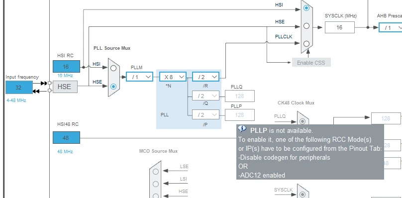

PLLP can't be turned on
I'm working on page 30 of the STM tutorial for the B-G474E-DPOW discovery kit at this link
https://www.st.com/resource/en/application_note/dm00706304-buck-current-mode-with-the-bg474edpow1-discovery-kit-stmicroelectronics.pdf
I get this warning when I try to follow the directions
Can someone explain how to fix this so I can move to the next step in the tutorial.
I've tried looking up codegen in the reference manual and also how to manipulate ADC12.
Thanks

Hello @decook1110
In order to set the [PLLP Clock] or [SYSCLK] as source Clock for the ADC12 or ADC345, just change the clock Prescaler to Asynchronous clock mode in the ADC_Settings.

Thanks for the work around, that fixed the clock so I can move past that,
