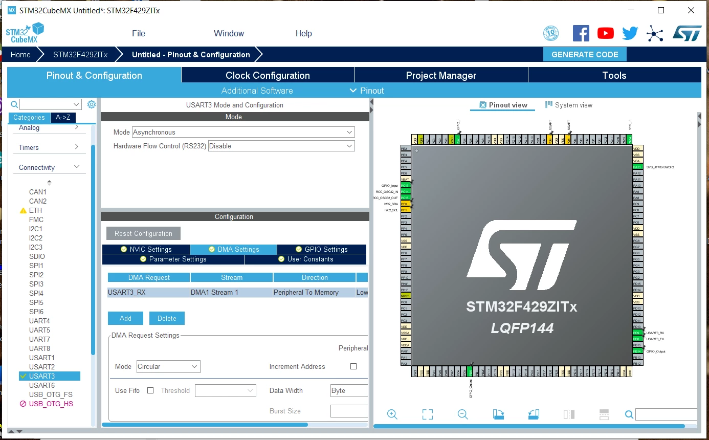

here in cubemx there is a option called FIFO , please help me how to use the option in your code. If there is any tutorial or study (or) reference materials please kindly share that also.

In general it is pretty transparent.
Where things are subtly different is being aware it has depth greater than One, so you'd use while(TXE==1) rather than if (TXE == 1) type constructs.

1.1.9 DMA FIFO mode
Each stream has an independent 4-word (4 * 32 bits) FIFO and the threshold level is software-configurable between 1/4, 1/2, 3/4 or full.
The FIFO is used to temporarily store data coming from the source before transmitting them to the destination.
DMA FIFO can be enabled or disabled by software; when disabled, the Direct mode is used.
If DMA FIFO is enabled, data packing/unpacking and/or Burst mode can be used.
The configured DMA FIFO threshold defines the DMA memory port request time.
The DMA FIFOs implemented on STM32F2/F4/F7 devices help to:
• reduce SRAM access and so give more time for the other masters to access the bus matrix without additional concurrency,
• allow software to do burst transactions which optimize the transfer bandwidth,
• allow packing/unpacking data to adapt source and destination data width with no extra DMA access.
Source: AN4031 Application note Using the STM32F2, STM32F4 and STM32F7 Series DMA controller
