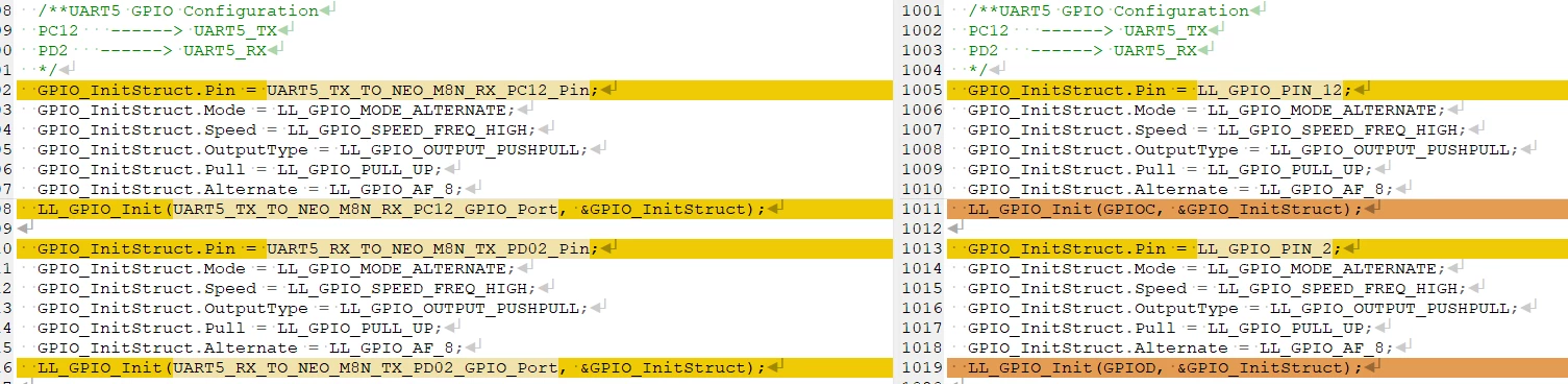

Pin names related macros missing after updating to STM32CubeMX version 6.3.0
Hello @Khouloud ZEMMELI​
Please refer to attachment.
After I installed and used the latest STM32CubeMX version 6.3.0, I am observing an issue. The PIN names that I had used in the IOC file, are now no longer present as macros in the generated code. Without the macro I no longer know the use of the PIN and have to refer to Schematics. The STM32CubeH7 MCU package version in use is unchanged and is 1.9.0
Please suggest a fix.

It appears that under Project Manager -> Advance Settings I had to manually change the settings for GPIO to first HAL, store it and then change it back to LL to get the correct output. I have to do the similar changes for RCC as well. Maybe an issue with the LL selection exists.

Dear @Khouloud ZEMMELI​ ,
You may use the IOC file that I shared with a different query.
My observation is that when I am setting RCC and GPIO to use LL drivers, and let the ETHERNET, FDCAN, (some) USARTs still use the HAL drivers, then this issue is observed:
Example: STM32CubeMX is overwriting exiting code:
   HAL_GPIO_DeInit(GPIOC, ETH_MDC_PC01_Pin|ETH_RXD0_PC04_Pin|ETH_RXD1_PC05_Pin);
   HAL_GPIO_DeInit(GPIOA, ETH_REF_CLK_PA01_Pin|ETH_MDIO_PA02_Pin|ETH_CRS_DV_PA07_Pin);
   HAL_GPIO_DeInit(GPIOB, ETH_TXD0_PB12_Pin|ETH_TXD1_PB13_Pin);
   HAL_GPIO_DeInit(ETH_TX_EN_PG11_GPIO_Port, ETH_TX_EN_PG11_Pin);
with:
   HAL_GPIO_DeInit(GPIOC, GPIO_PIN_1|GPIO_PIN_4|GPIO_PIN_5);
   HAL_GPIO_DeInit(GPIOA, GPIO_PIN_1|GPIO_PIN_2|GPIO_PIN_7);
   HAL_GPIO_DeInit(GPIOB, GPIO_PIN_12|GPIO_PIN_13);
   HAL_GPIO_DeInit(GPIOG, GPIO_PIN_11);
This change is of concern to me, as now I do not know what is the use of GPIO_PIN_1. Instead it it would have still read as ETH_MDC_PC01_Pin, the informative name would have been more helpful.
Please help fix the issue.
Thanks,
Rajeev

Thank you for providing your ioc file, it helped me a lot, I can reproduce the problem using your project and I confirm the issue, you're right.
The problem occurs always when the IP uses a driver different from what GPIO is using.
Many thanks for raising the issue to our attention, it is now under analysis and it will be fixed.
