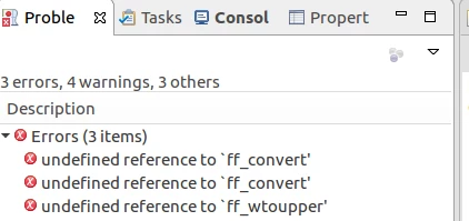

Utkarash Patil
Oct 8, 2019 9:02 AM UTC
Hello All,
Thank You For your Response and suggestion,

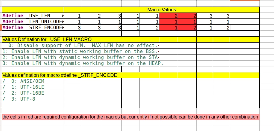

However When i change the macro _USE_LFN my code shows me 3 errors whose screen shot i have attached below, Whereas the errors are from the file "ff.c" where i have not even changed anything
After checking the macros in "ffconf.h" file I understood that i have to change other two macro's also with enabling the _USE_LFN macro.
So as per my application i changed the _USE_LFN and _STRF_ENCODE macro's to the following values
#define _USE_LFN    2  /* Enable LFN with dynamic working buffer on the STACK.*/
#define _MAX_LFN    255
#define _LFN_UNICODE   1
#define _STRF_ENCODE   1 //or 2 /* UTF -16LE or UTF-16BE anything will work
Then Also i faced the same errors which i have mentioned above Hence, i tried all the combinations, of the above 3 macros to resolve this error.
So i request to please help me with this at the earliest,
Also Please let me Known If i am missing out on something,
Thanks and regards
Utkarash
Tesla DeLorean
Guru
Oct 8, 2019 9:21 AM UTC
Suggests that you are missing one of the FatFs middleware files containing these functions. Add it to the project. Not on a PC right now​, will check which later.

Utkarash Patil
Oct 9, 2019 4:32 AM UTC
Hello All,
Thank You for Your Response .
As per your suggestion i checked for the "sycall.c" and "unicode.c" files on the path "Middlewares/Third_Party/FatFs/src/option/", I was able to find syscall.c but i do not have "unicode.c" on the above mentioned path.
Please help me with how to find this unicode file and link it with my Project.
Also possible to review docs, and "grep" the libraries to find the files required for linkage to complete.
Sorry but i didn't understand the above Comment, Can please explain a little, also is there any library which i am missing out and need to download and link.
Please help at the earliest
Thanks and Regards
Utkarash
Tesla DeLorean
Guru
Oct 9, 2019 5:26 AM UTC
>> with "STM32Cube FW_F7 V1.9.0" firmware package.
That's some antiquated release
STM32Cube_FW_F7_V1.15.0\Middlewares\Third_Party\FatFs\src\option\unicode.c
STM32Cube_FW_F7_V1.9.0\Middlewares\Third_Party\FatFs\src\option\unicode.c
Perhaps you're overly dependent on CubeMX to copy a local instantiation into your project, if that's the case go manually fetch the files from the CubeF7 repository trees.
GREP is a UNIX/LINUX tool for finding things in files, it is a metaphor for going looking for stuff in the places where it might reasonably be found. Consider using a File Manager or similar tool to search files, it doesn't have to be a hunt-n-peck operation with you manually digging through files and directories, computers are good at automating such activities. For example looking at ALL the .C and .H files in the CubeF7 for "ff_convert", or perhaps limiting the search to the Middlewares tree.
