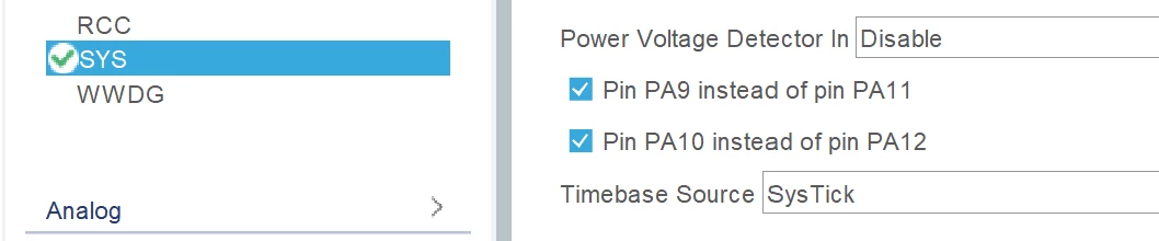

I am using the STM32G031F4P6 (TSSOP20) and have a question regarding the PA11[PA9] and PA12[PA10] remapping.
According to RM0444, PA11_RMP and PA12_RMP remap PA11→PA9 and PA12→PA10. However, in STM32CubeMX, the shared pins PA11[PA9] and PA12[PA10] only expose the Alternate Functions of PA11/PA12 (e.g., USART1_CTS, USART1_RTS/DE/CK), and USART1_TX/RX are not available.
Could you please clarify:
  1. Is this a limitation of STM32CubeMX?
  2. Or is it not possible to use the PA9/PA10 Alternate Functions (e.g., USART1_TX/RX) on the physical PA11/PA12 pins after enabling PA11_RMP/PA12_RMP?
If it is supported in hardware, what is the recommended way to configure it?
Thank you.

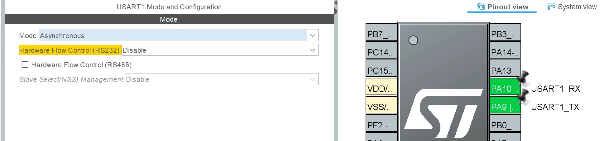

You must first remap the pins in the SYS tab.
After that, the PA9/PA10 functions are available for use.

Jul 28, 2026 9:41 PM UTC
Thank you very much, TDK!
