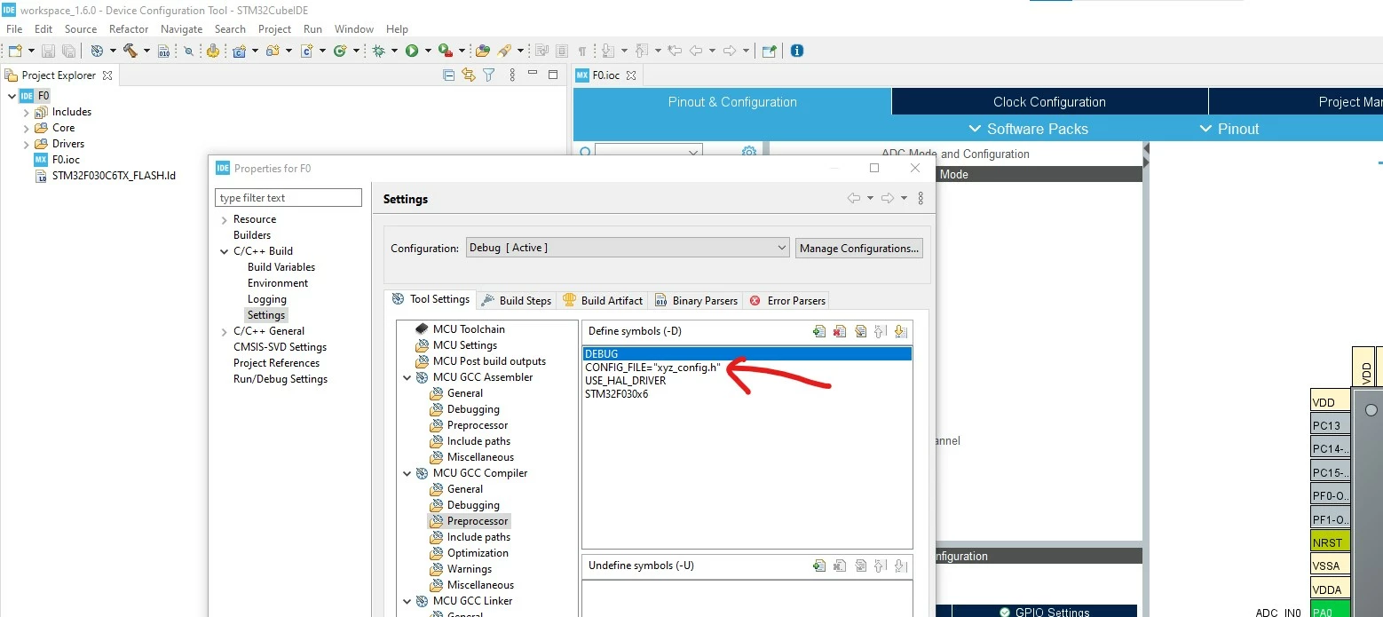

I'm working with CubeMX 6.2 & CubeIDE 1.6.0.
I have several problems with the generated code that I would like to know if I can somehow resolve instead of changing the generated code every time after changing something in the CubeMX project.
This is the list:
  • I have a defined symbol under the CubeIDE GCC Compiler preprocessor settings, for example CONFIG_FILE="xyz_config.h". This setting is override by CubeMX
  • When I use ETH with my H743 based project the CubeMX add to main.c a definition of DMA descriptors. I have those descriptors defined somewhere else in the code based on my application specific needs. Is there a way to make CubeMX not to generate this part in main?

Myself if 1.6.0 I've no issue to keep my sybol definition despite asking for new code generation (because IP setup update or ...)
If expecting to prevent DMA descriptors clash I gues sonly way is to not setup such DMA as part of your device configuration activities. If no set for sure no related code will be generated
