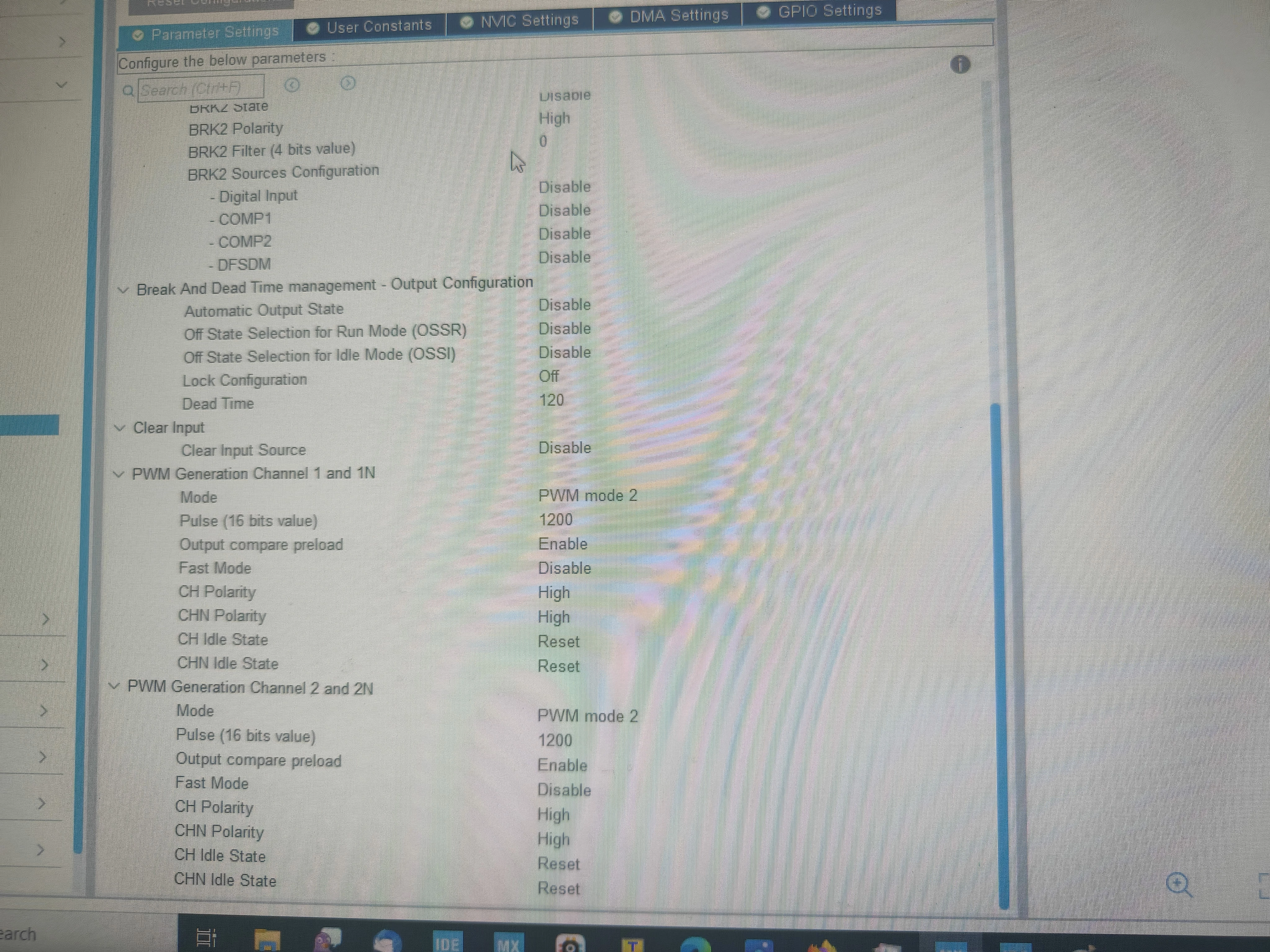

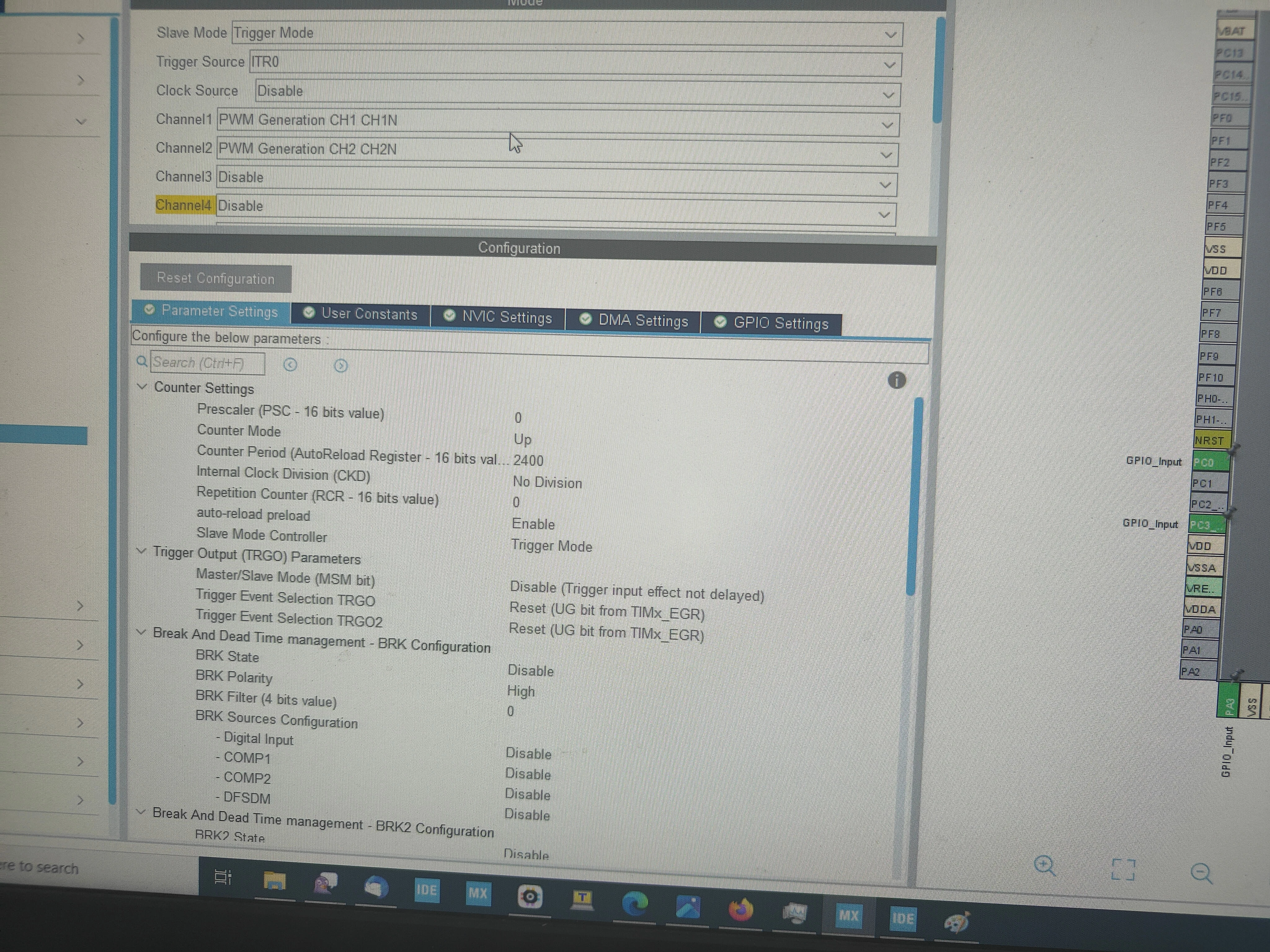

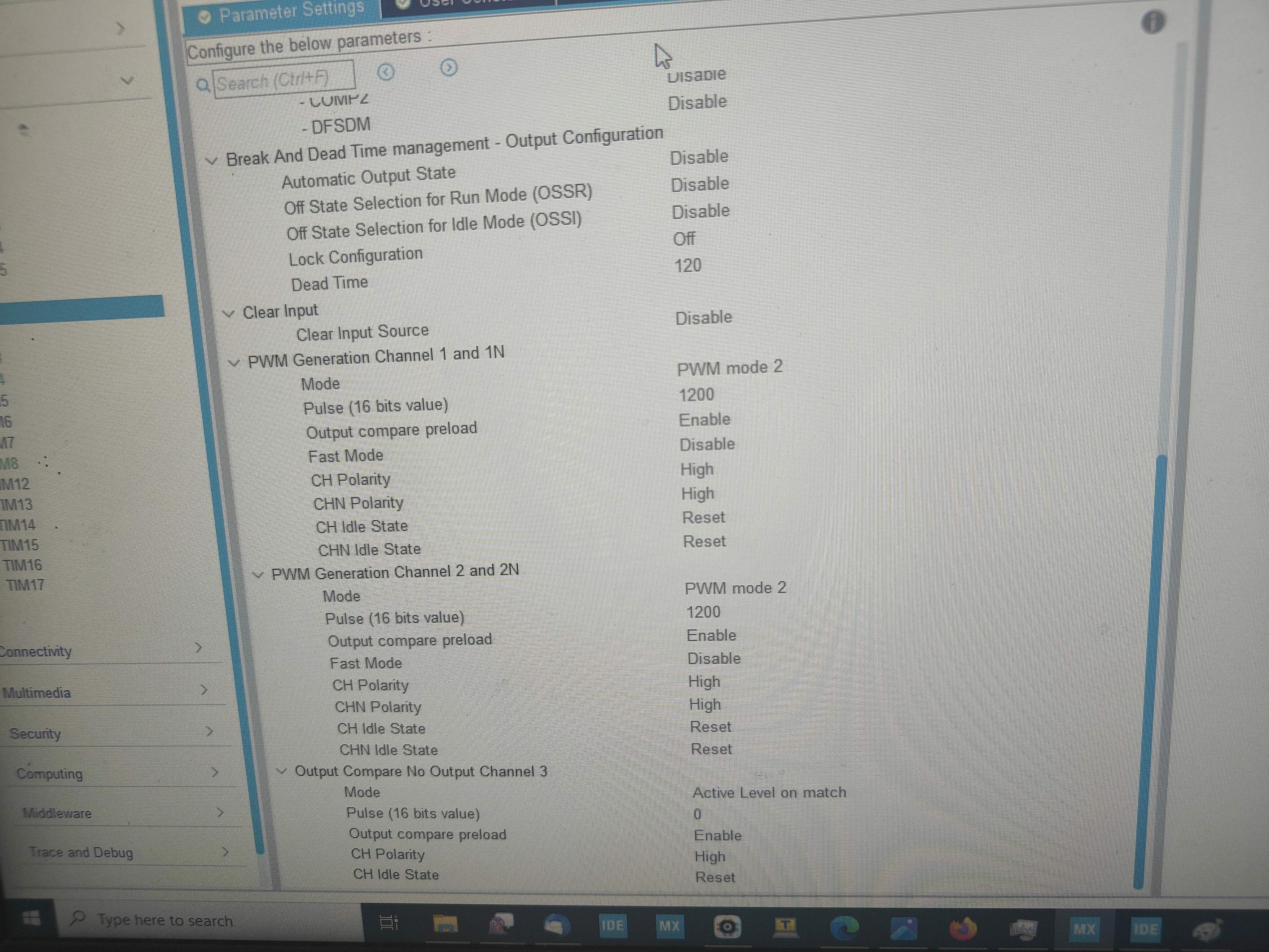

I had taken TIM1 asn Master to Trigger TIM8 here below i had attached the timer configuration IMG20250205175541.jpgIMG20250205175611.jpgIMG20250205175558.jpg
Clock Frequency 480mhz ,timer clock 240mhz
Here Iam Triggering The TIM8 after 2.5us started from TIM1 both are 100khz frequency in TIM->CCR3 register iam loading the 2.5us equavalent value (600) loading in the register where in the output also it came correctly but WHERE iam Incrementing or decrementing automatically in code in the CCR register value loaded correctly but in the output it is not updating why i dont known please anyone help to solve this problem

February 5, 2025
I cant have access to able to attach this so taken photo
