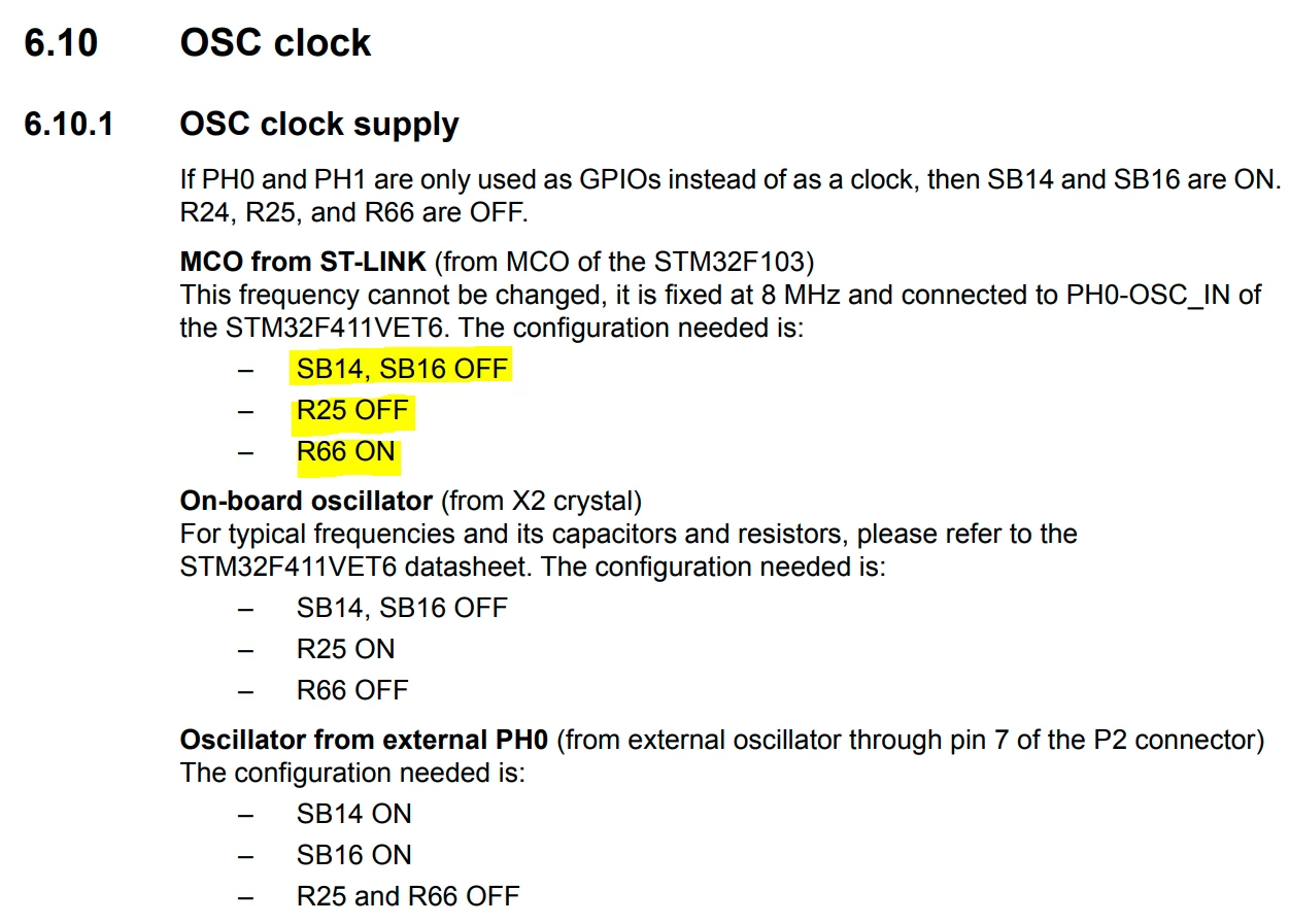

> Before I start manually changing the clock configuration to try and sort this I thought it worth a check to see if anybody else experiences this.
I don't think anybody cares about the gazillion ways of how Cube/CubeMX can and does go wrong.
Just go ahead and program the clock configuration normally. Note, that on the DISCO, you may have to use HSE bypass, if you intend to use the MCO output of STLink.

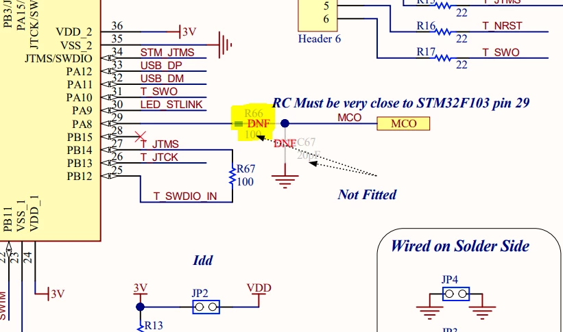

July 4, 2021
It looks like default settings use MCO bypass. Ensure solder bridges and resistors are configured accordingly.
Looks like R66 is not fitted:
waclawek.jan
July 4, 2021
As the pictures show the 8MHz X2 populated, and schematics shows R25 populated, this is clearly CubeMX bug.
July 4, 2021
I agree. Easier to change the default than to get it to work.
YIzAKat
YIzAKatAuthor
July 4, 2021
Thank you both, yep my guess is that this is because the Nucleo boards I have used source the clock from ST-Link MCO (no crystal fitted) by default and the same invalid default has been generated here. I've checked my various Discovery boards and all have crystals fitted.
I'll just change the default and get on.
