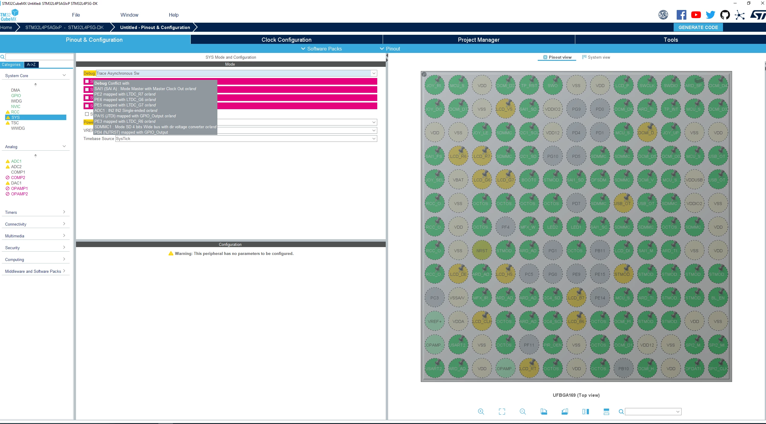

Open Initialize all peripherals with their default Mode after selecting Yes, DEBUG without serial wire option
Ghofrane GSOURI
Ghofrane GSOURIBest answer
May 8, 2023
Hello @�?�兵 何​

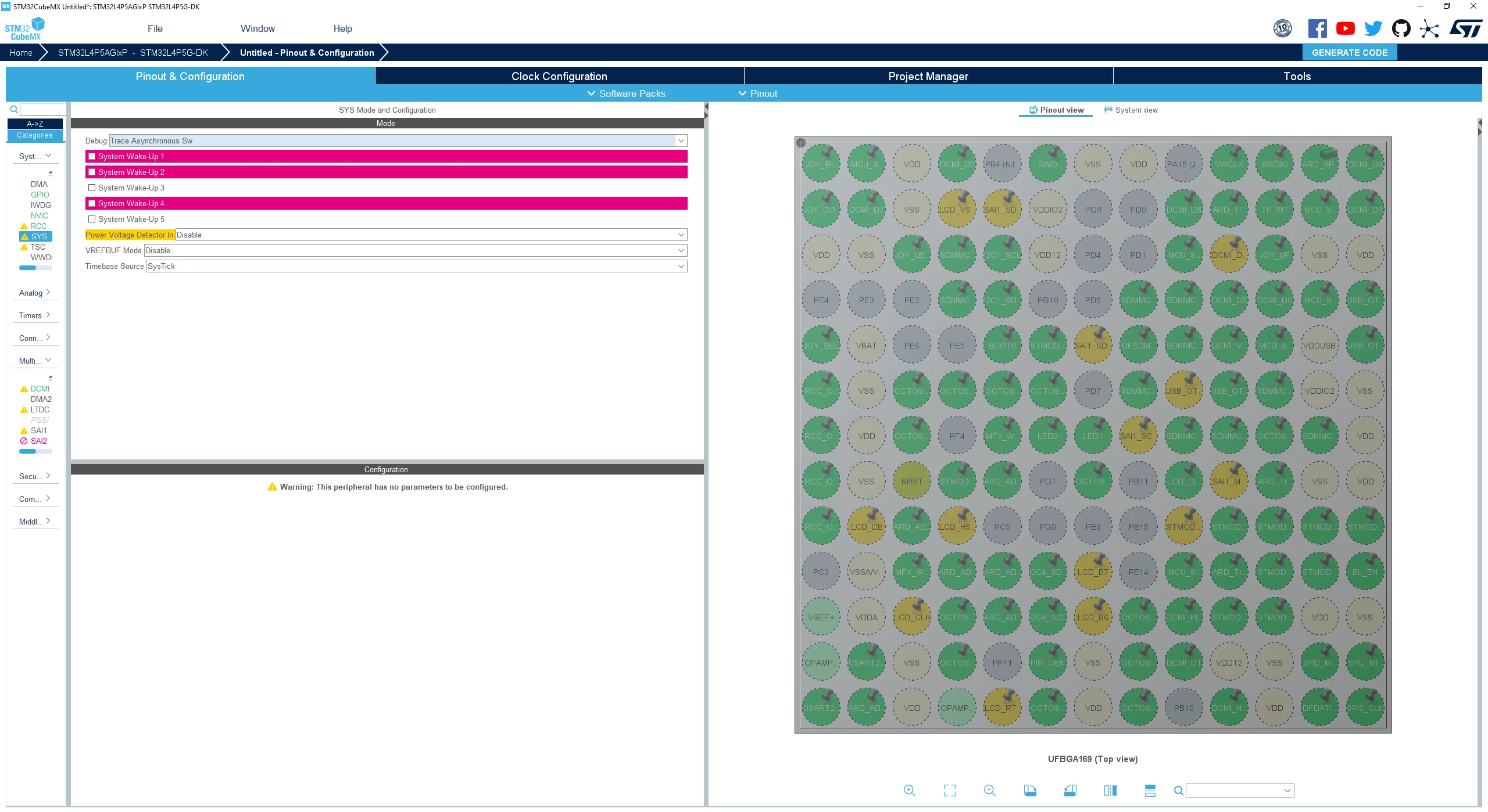

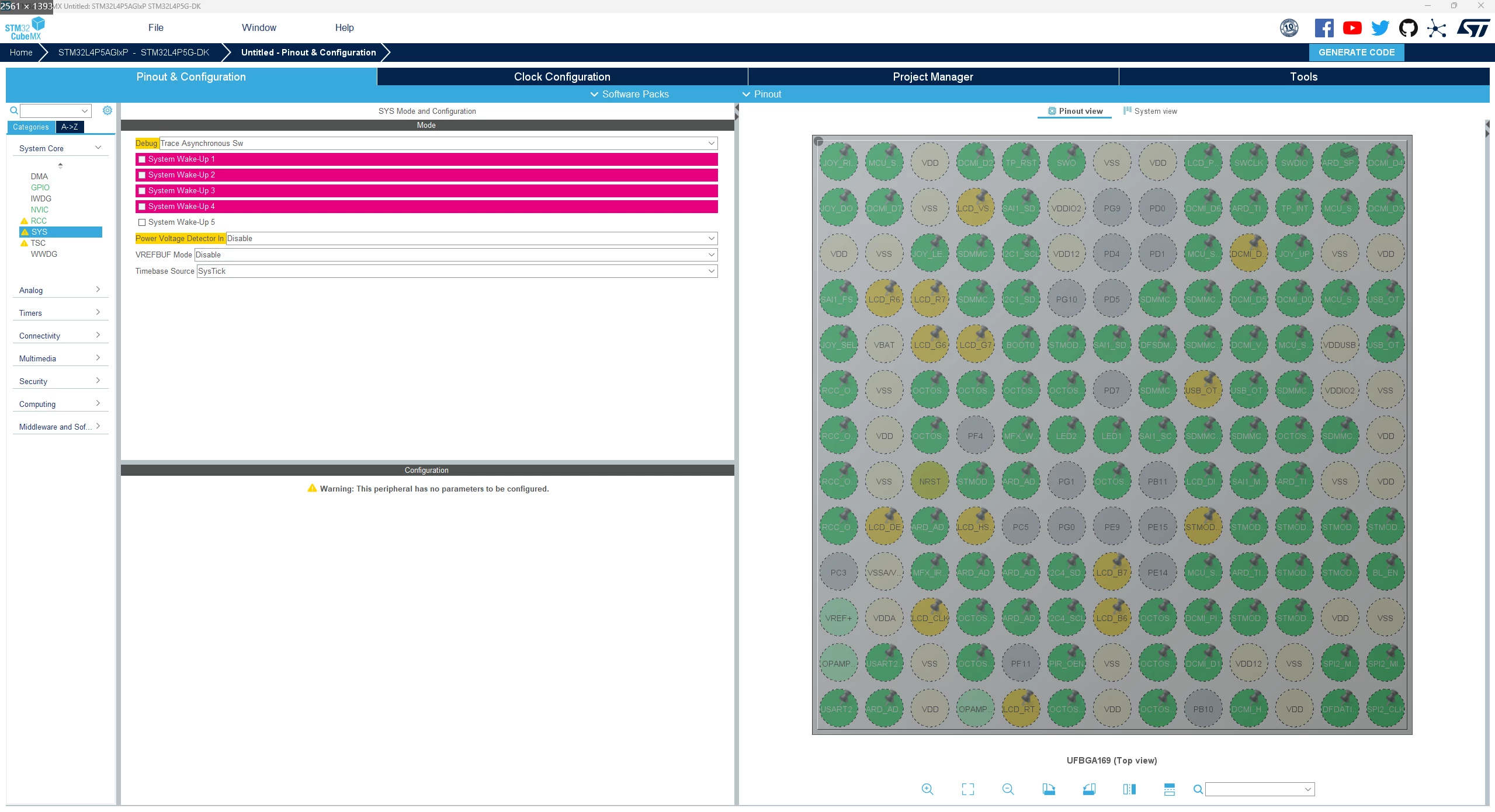

Let's try this solution:
As shown in the screenshot , we need to eliminate the conflicts in order to make the "Trace asynchronous Sw" is the SWD (serial wire), works correctly
_legacyfs_online_stmicro_images_0693W00000bjaZ5QAI.pngAfter solving the conflicts :
I will be waiting for your feedback
Thx
Ghofrane

"Trace asynchronous Sw" is the SWD (serial wire), with additional SWO pin. So this is OK.
The red colored things are not relevant.
XIAOHE
XIAOHEAuthor
May 8, 2023
@Pavel A.​ I understand what you mean, however, I exported to keil via GENERATE CODE and it will not work after burning to the development board in keil.

XIAOHE
XIAOHEAuthor
May 8, 2023
@Ghofrane GSOURI​
Thank you very much indeed, the problem is solved!
