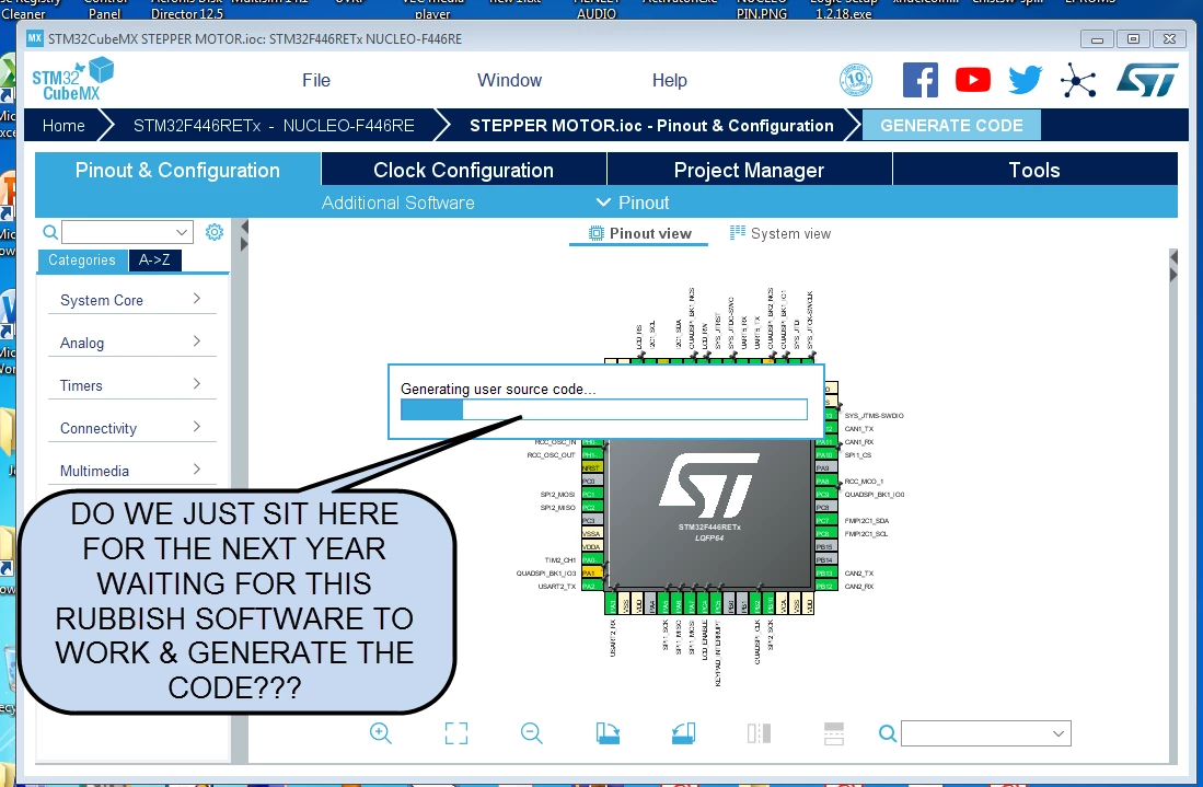

OK SO I AM STUCK AS CUBE MX 5 SOFTWARE JUST LOCKS UP, HOW DO I CONTINUE MY DEVELOPMENT ? ANY HELP ?????

so we know CUBE MX software is total rubbish as it just locks up when generating what should be my project code,

... then you can try and do a move first. Upload the .ioc and other files useful for a repro, so someone can look at it.
Also, please give more details. Windows or Linux? which version? Which Java runtime version? Does the project path contain spaces? etc.
Is any "antivirus" installed?

I can tell you version 4.27 works fine, now I have edited the ioc file changed the version from 5 to 4.27
