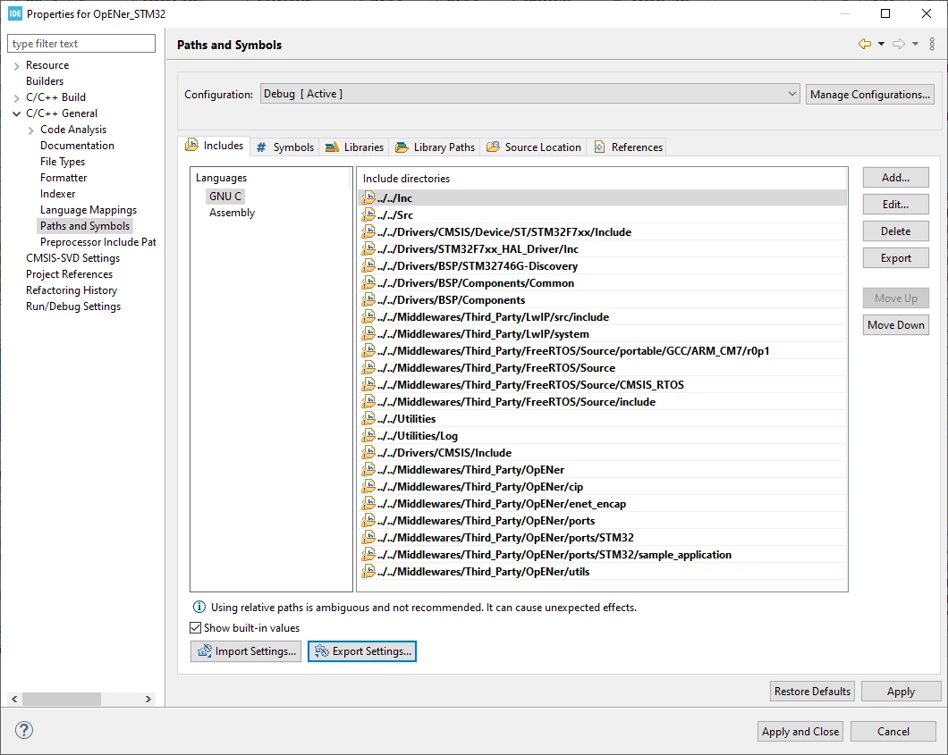

and the in STM32CubeIDE project there are these includes:
0693W00000D1Rk5QAF.pngPeter

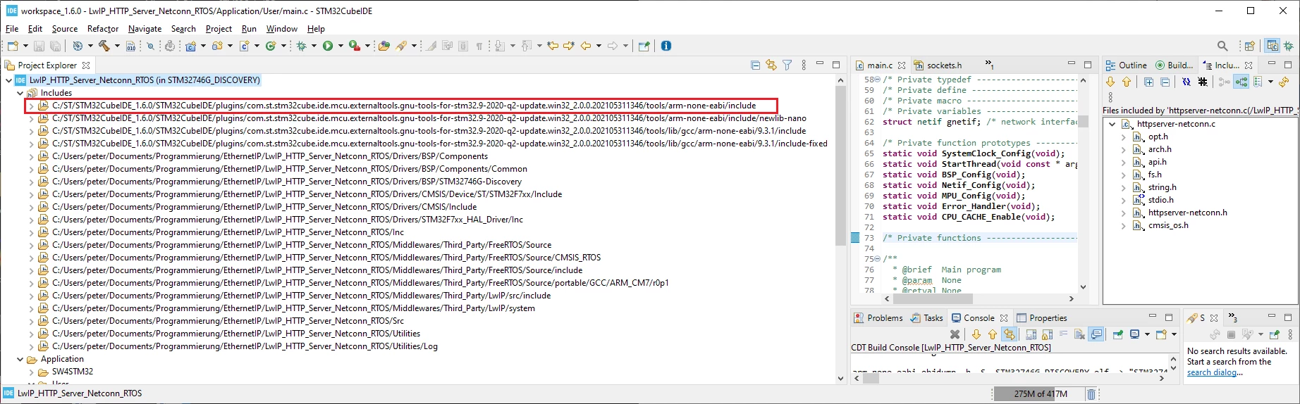

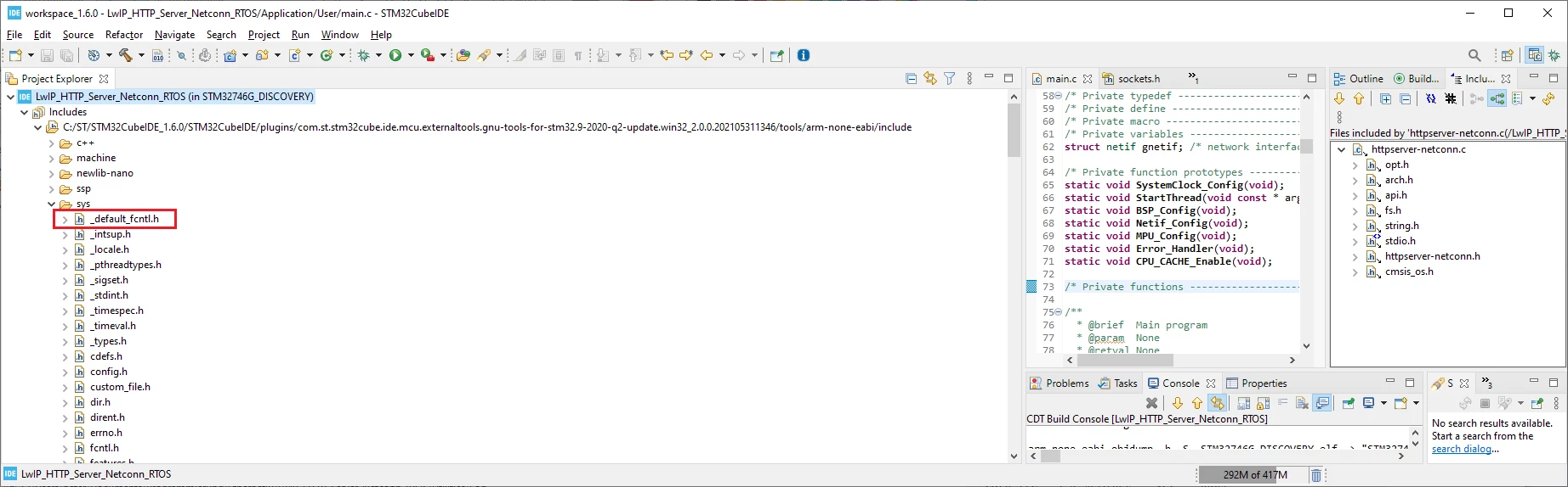

I have some additional informations for you.
The basis for my project is the example application "LwIP_HTTP_Server_Netconn_RTOS" from STM Cube V1.6.0.
There for I had a deeper look there and have seen how the _default_fcntl.h gets incuded into my program. It comes via the includes in the project:
Please check this.
Kind regards Peter
Pavel A.
August 8, 2021
Then ok, the _default_fcntl.h comes from the toolchain includes. Normally this is included via fcntl.h.
Just make sure that LwIP source files are cofigured so that fcntl.h from the toolchain gets included, and #ifndef O_NONBLOCK is false.
