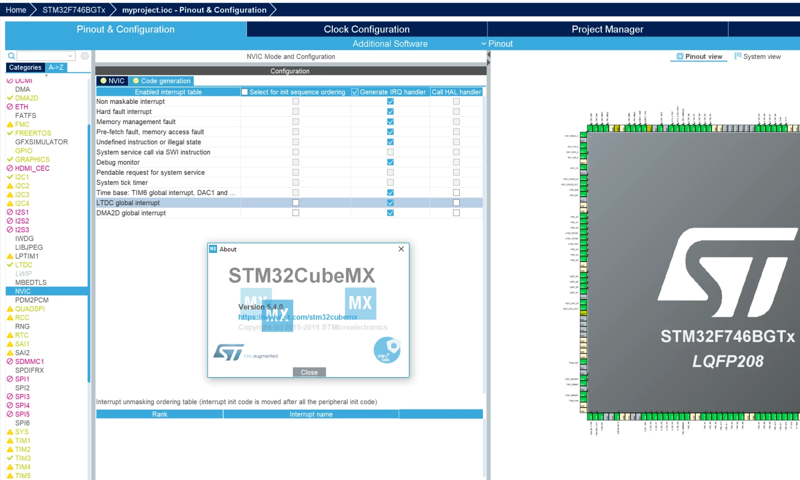

NVIC Code Generation feature does not seem to be working correctly.
I'm using STM32CubeMX 5.4.0.
When I enable LTDC and DMA2 interrupts (for example) in the NVIC tab in NVIC Mode and Configuration, when I switch to the Code Generation tab there are no entries for either LTDc or DMA2D. See attached screenshots.
What is preventing Code Generation ?

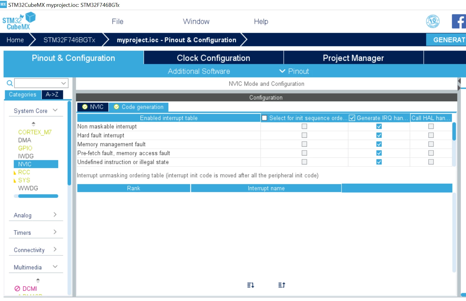

With your ioc file :
please ​move the scroll bar I think they are at the end of the table.

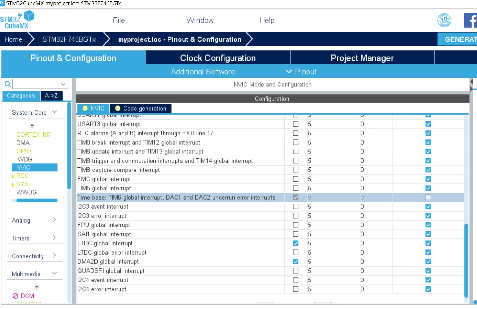

Oct 29, 2019 3:03 PM UTC
Thanks Khoulid,
they weren't there, but when I exited and re-loaded they appeared .
Thank you again,
