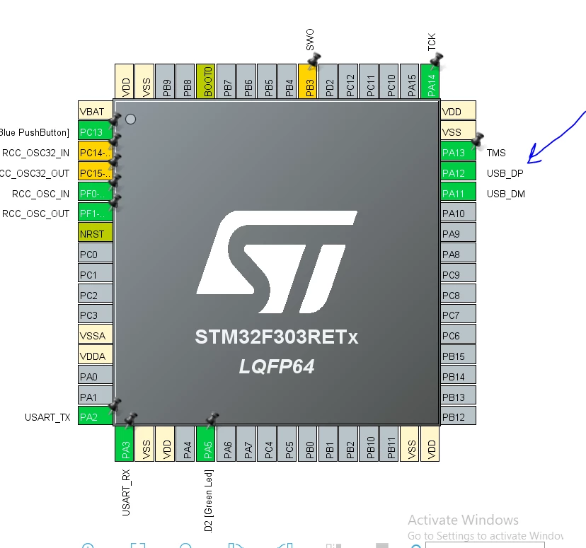

With a nucleo-F401RE, I was able to just create a tiny USB cable that plugged into the female headers on the board, for my cable I used:
PA9 - VBUS
PA11 - USB DM
PA12 - UBS DP
And of course a ground connection.
It was pretty crude but it served its purpose.

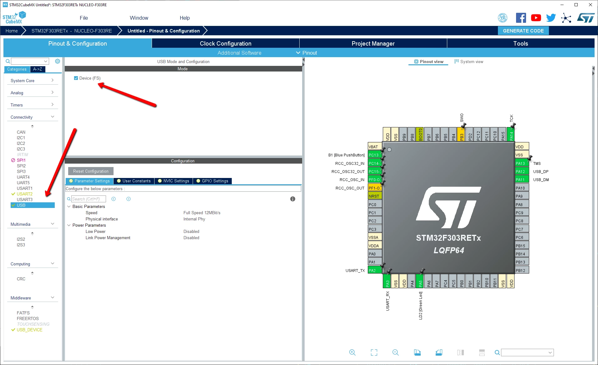

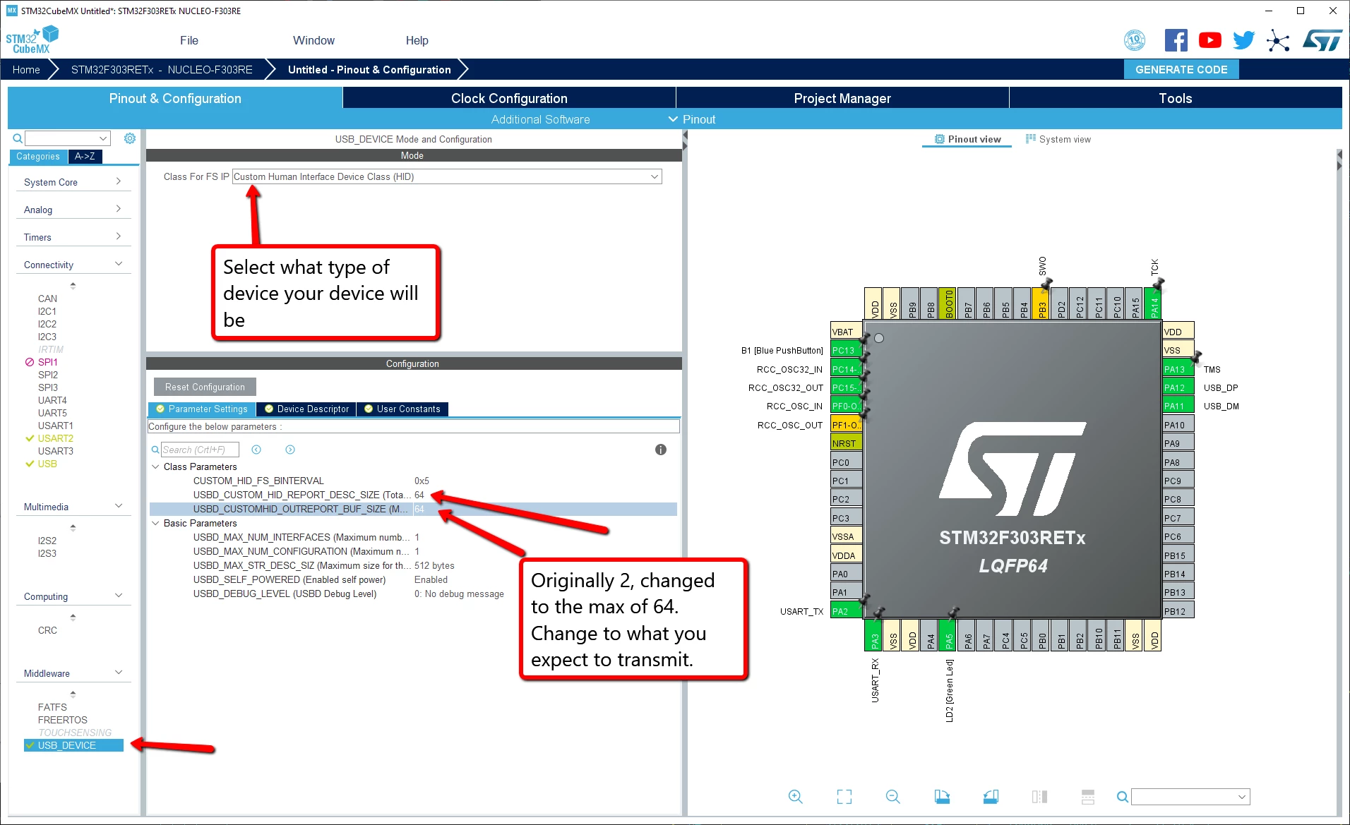

If you are using STM32CubeMX (which I would suggest), did you enable the various USB elements? Take a look at the images. 0690X00000BvkQmQAJ.png0690X00000BvkQXQAZ.png
I created a project in the latest version of STM32CubeMX and attached it. I don't have a F303 to test with so you will have to give it a try.
