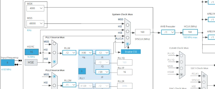

I am currently trying to setup a blink example on NUCLEO-U5A5ZJ-Q and I have a bug using the default configuration from current CubeMX version (6.18.1).
The generated binary ends up in an Error Handler in the SystemClock_Config function. The default clock configuration generated is the following:

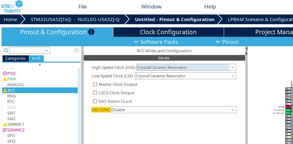

set crystal:

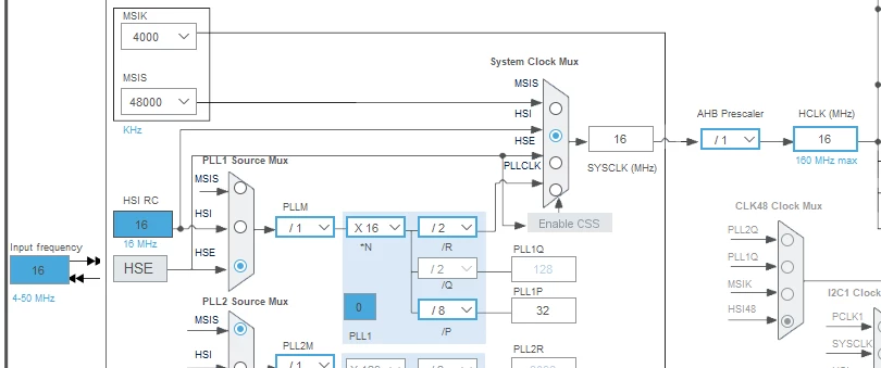

..and clock tree :  pll 1P  to 16 M !
because usb needs it:

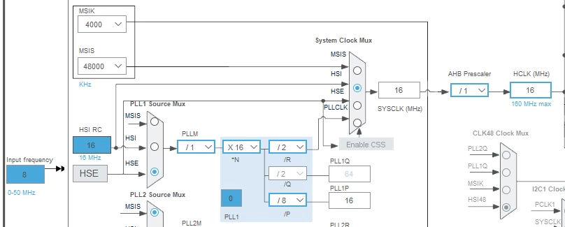

on nucleo U5A5  the clock is coming from the st-link , in first version (?), so 8Mhz , + “bypass” is correct setting.

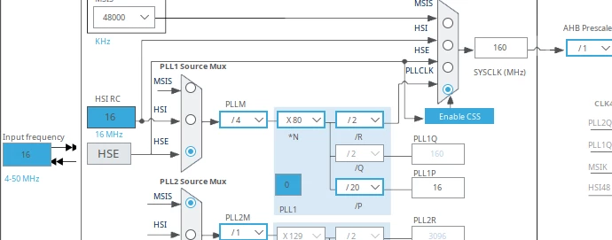

Look, what is really on your board : if the 16M crystal is there, then 16M + “crystal..” is correct, maybe necent version, then clock tree:
and can use it for USB also:

Setting this configuration did solve the issue with the HSE input frequency set to 16 Mhz as mentionned in the previous post. Following clock configuration is working on my side if anyone else encounters the problem:
