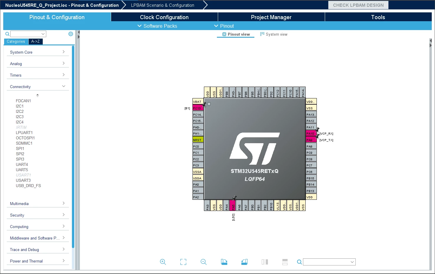

New to STM32. Ordered myself a Nucleo-U545RE-Q Board for software generation used in an embedded project later. Generated a project and started working on it. First it worked just fine. But since mid of last week (start of August), most likely after an update which was installed, it wont crate a working IOC for new projects with the board anymore. New projects for other controllers or other Nucleo-boards work just fine.

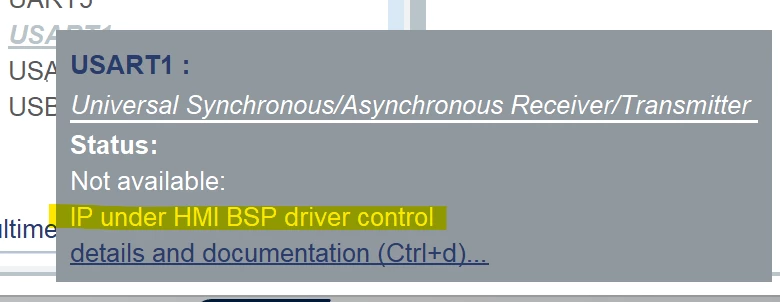

More specifically as seen in following screenshot, all pins which should be pre- configured with a function for the Nucleo board produce a conflict. The USART1 function is fully grayed out and not configurable.

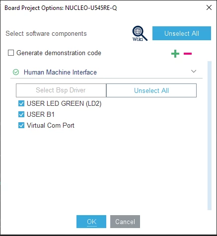

During project creation the options for the USER features are ticked as seen in following picture:
the right pins seem to get configured in a wrong way.

When you use that nucleo board, the peripherals are handled with the BSP, rather than with the typical MX/HAL functions. The "disabled" pins reflect this. Generate the project, you'll see the proper initialization calls are still being made.
If you want a "normal" CubeMX project, create a project from the chip instead of the board and configure these peripherals manually.
Presumably a change in how they've decided to do things, but doesn't appear the be a bug.
