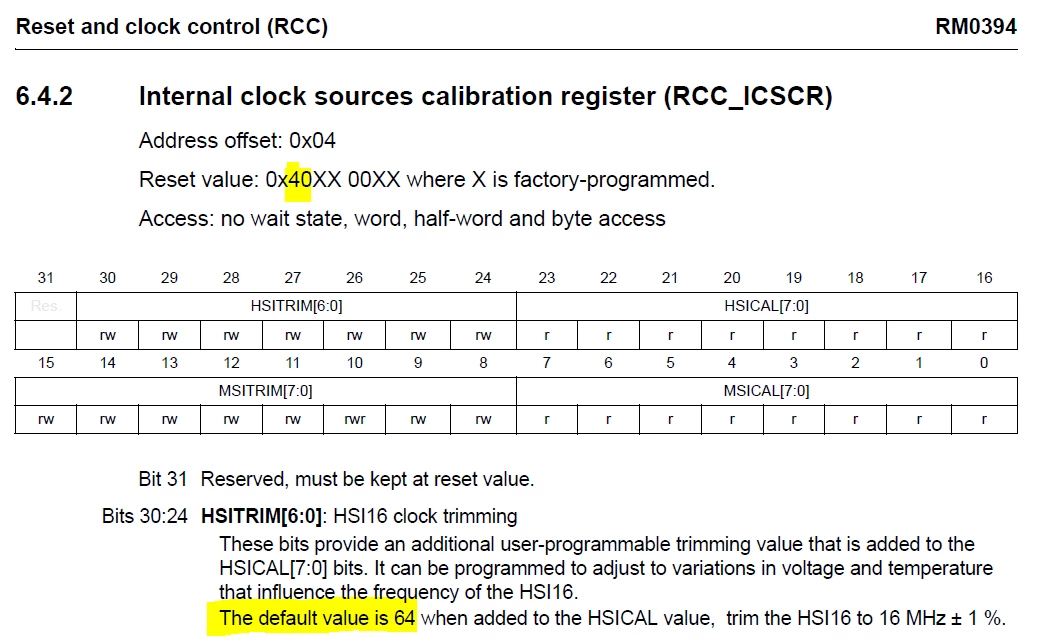

But RM0934 indeed says HSI TRIM is 6 bits... I personally would double-check the reset value, or, better, avoid writing to that register altogether.

August 2, 2020
It's a bummer that the hardware has different defaults. Although there's really no excuse for CubeMX not checking the chip family and revision at runtime. In this case, it could even be done at compile time.
Hmm, actually the L433 reference manual says 0x40 is the default, which agrees with the code. Are you saying the RM is wrong as well? Is the value at reset actually 0x10?
kiwironnie
August 2, 2020
Apparently this is wrong. Having checked the HSI output frequency with an oscilloscope an HSI trim value of 0x10 is required to set the clock to almost exactly 16MHz (no PLL), the required value. Whereas at 0x40 the frequency is around 17MHz! A trim value of 0x00 is significantly under 16MHz.
waclawek.jan
August 3, 2020
And what's the reset value of the trim? What is the HSI frequency without touching the trim (i.e. no call to any function touching RCC)? How do you measure the click frequency?
