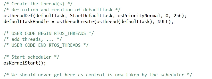

Figure 1: I have not changed these functions that were generated by CubeMX but wanted to post them in case anything looks off. Also curious about where I may put my main functionality of my application if the scheduler prevents the code from going any further? For example if my goal is to blink an LED, turn a servo, or read a sensor, do I now put that code inside of the default task where it loops? Some clarification on that would be wonderful as I was still unsure after reading the article.

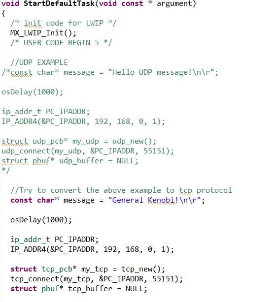

0693W00000DnaBoQAJ.pngFigure 2: Here you can see that I commented the udp example code so that I could use it as reference. I have changed the message as I am trying to get my Pythong GUI to send a tcp message of "Hello There!" and my board to respond with "General Kenobi!". I have kept the IP address the same and used the tcp functions instead of udp. I am aware that these are not a 1:1 translation and that the tcp functions behave differently but I am not sure in what ways and how I may achieve the functionality seen in the code.

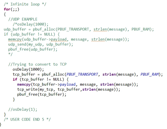

0693W00000DnaByQAJ.pngFigure 3: Similar to figure 2, I have commented udp example code and written tcp replacement. I also replaced udp_send() with tcp_write() as I believe that was the closest to similar functionality but I am not completely sure that is correct.

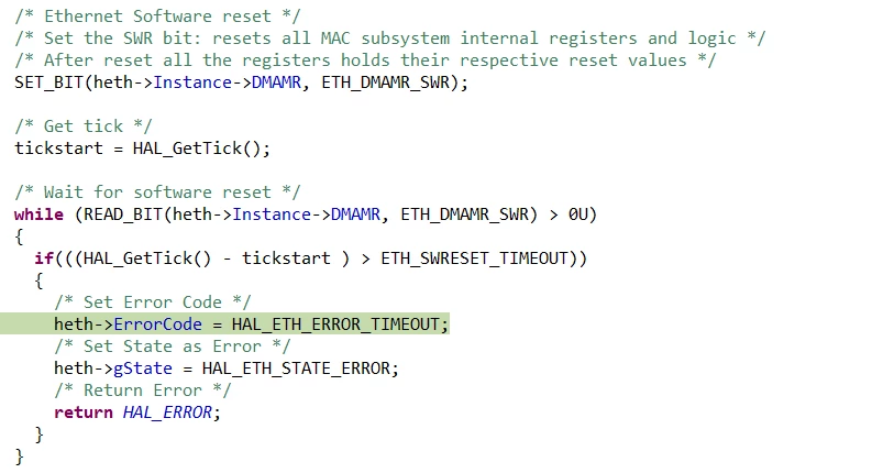

Now there are two separate errors that I am running into. The first (which I believe to be causing the second) is the MX_lwip_init() function is running into a software reset timeout error which is throwing up a HAL_ERROR explained in the figure below:
0693W00000DnaGeQAJ.pngFigure 4: this is in the stm32h7xx_hal_eth.c file that is generated. This triggers the ErrorHandler. I am not exactly sure why the timeout is happening. Whether it be how I am writing my software or how I have initialized things in CubeMX. The other issue that I believe is being caused by this is explained in the figure below:

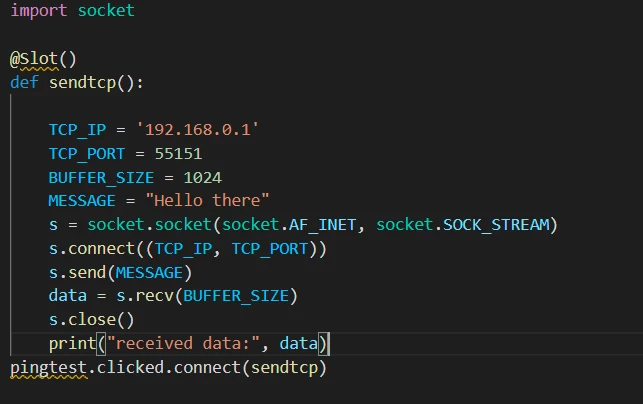

Figure 5: This is part of the code in Python for a pyside6 gui that is supposed to send the tcp message when the button is clicked. Unfortunately there was a version control issue and I had to cut this picture out in a separate file and I will not be able to display pictures of the GUI. However when the button is clicked it seems to go through this protocol and then gives me the error "ConnectionRefusedError: [WinError 10061] No connection could be made because the target machine actively refused it". Not sure if resolving the timeout issue will also fix this or if it I am also doing this wrong.
