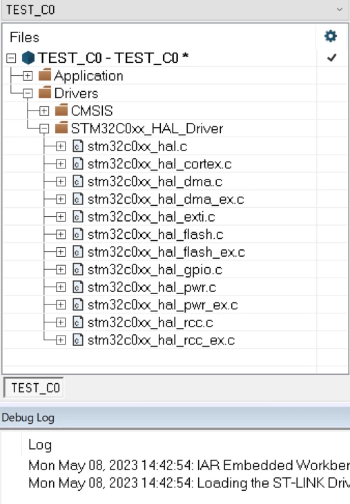

There seems to be an error in the implementation of the NUCLEO-C031C6 when generating code for the project after updating the peripherals. After loading an example project and compiling and testing all is well but once you update the project by adding a peripheral or changing the peripheral parameters the contents of the Driver\STM32C0xx_HAL_Driver are removed. See attached screenshots.

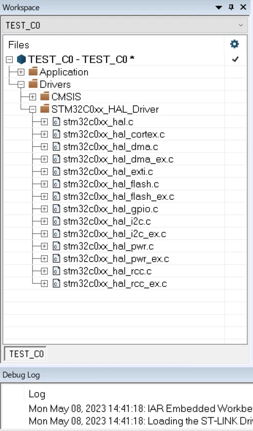

Foued_KH
May 8, 2023 1:47 PM UTC
Hello @CKlib​ ,
I couldn't reproduce your issue.
I've already configure the I2C and generate the code
_legacyfs_online_stmicro_images_0693W00000bjbZGQAY.pngAfter that I re-configure by removing I2C and I've good results :
Foued

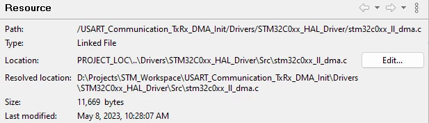

Pavel A.
May 8, 2023 8:49 PM UTC
In your CubeIDE project view, the HAL file are shortcuts.
Have you selected in CubeMX "Add files... as reference", or was the option different and you changed it to "copy..." later? What is the resolved location of missing HAL files?

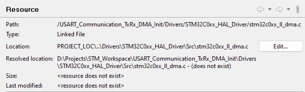

CKlib
CKlibAuthor
May 9, 2023 6:52 AM UTC
Hi Pavel,
Started a new workspace, loaded the example "USART_Communication_TxRx_DMA_Init" for NUCLEO-C031CS. Compiled the project and all ok.
_legacyfs_online_stmicro_images_0693W00000bjev5QAA.pngOpend the "USART_Communication_TxRx_DMA_Init.ioc", changed the Parity to Even and then back to None and saved, when asked to generate code responded "Yes".
As soon as the project is reconfigured the driver files are deleted. Confirmed by checking the directory "D:\Projects\STM_Workspace\USART_Communication_TxRx_DMA_Init\Drivers\STM32C0xx_HAL_Driver\Src\", both the Src and Inc files have been deleted.
No other changes made to the setup.

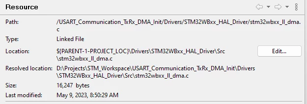

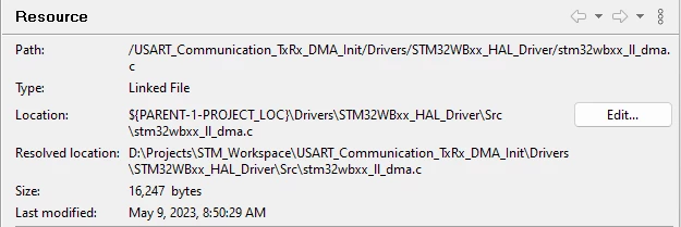

CKlib
CKlibAuthor
May 9, 2023 6:55 AM UTC
To confirm I loaded the same example for the P-NUCLEO-WB55-NUCLEO eval and it works as expected. So I can only assume there is an issue with the C031 implementation.
Before:
_legacyfs_online_stmicro_images_0693W00000bjfDnQAI.pngAfter:
