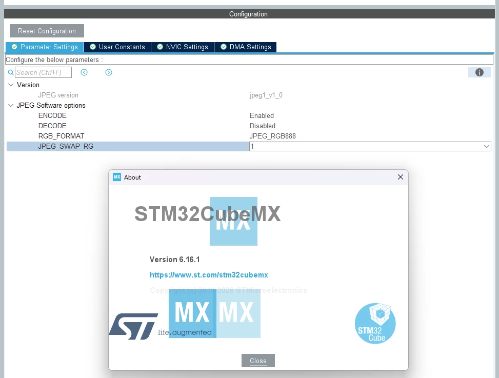

Not fixed JPEG_SWAP_RG macro
Reporting that this bug is sitll present in CubeMX v6.16.1
Solved: We found a bug while using Hardware JPEG. - STMicroelectronics Community
Still JPEG_SWAP_RG, not JPEG_SWAP_RB.
I wish there would be user defined section in jpeg_utils.conf.h to workaround it.
And there's another bug:
Every time I regenerate code, CubeMX erases Utilities/JPEG folder. So the package code has to be manually restored.

February 2, 2026
Hello @Mikk Leini
In order to investigate the problem, could you please attach an IOC that demonstrates the issue?
BR, Souhaib

I would have to make a new IOC file to demonstrate it without other stuff. But there is wrong parameter name in the screenshot and CubeMX v6.16.1 Help -> About window over it. Even if my IOC file is bad the CubeMX should not be wrong.

Hello @Mikk Leini
Which MCU are you using?

STM32N6570

Hello @Mikk Leini
Thanks for your feedback,
The issue has been escalated internally to the dedicated team for further investigation and resolution. (Ticket 226502 This is an internal tracking number and is not accessible or usable by customers.)
Meanwhile, as a temporary workaround, I suggest placing JPEG files in a custom folder other than Utilities to prevent code regeneration from deleting this folder.
KR, Souhaib
