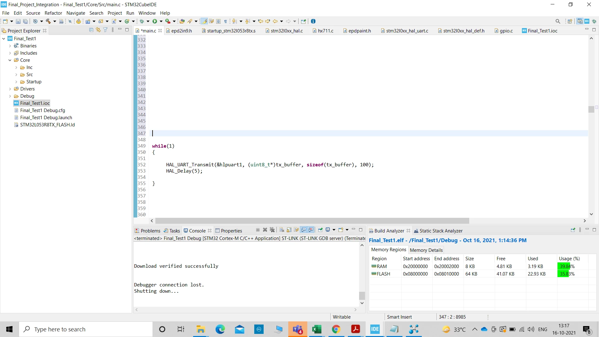

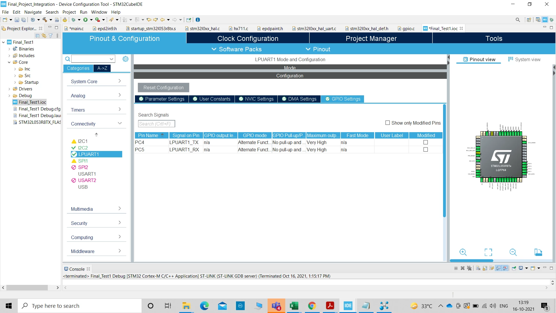

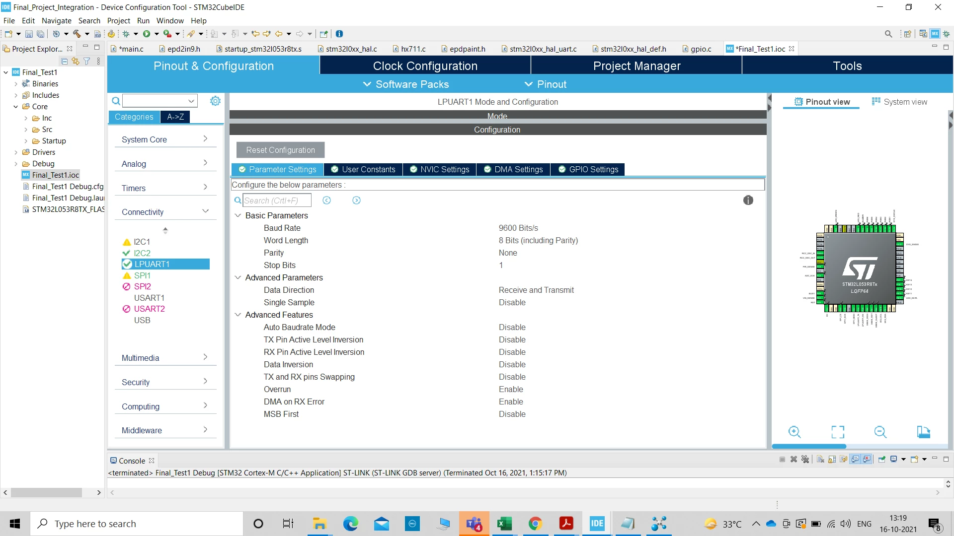

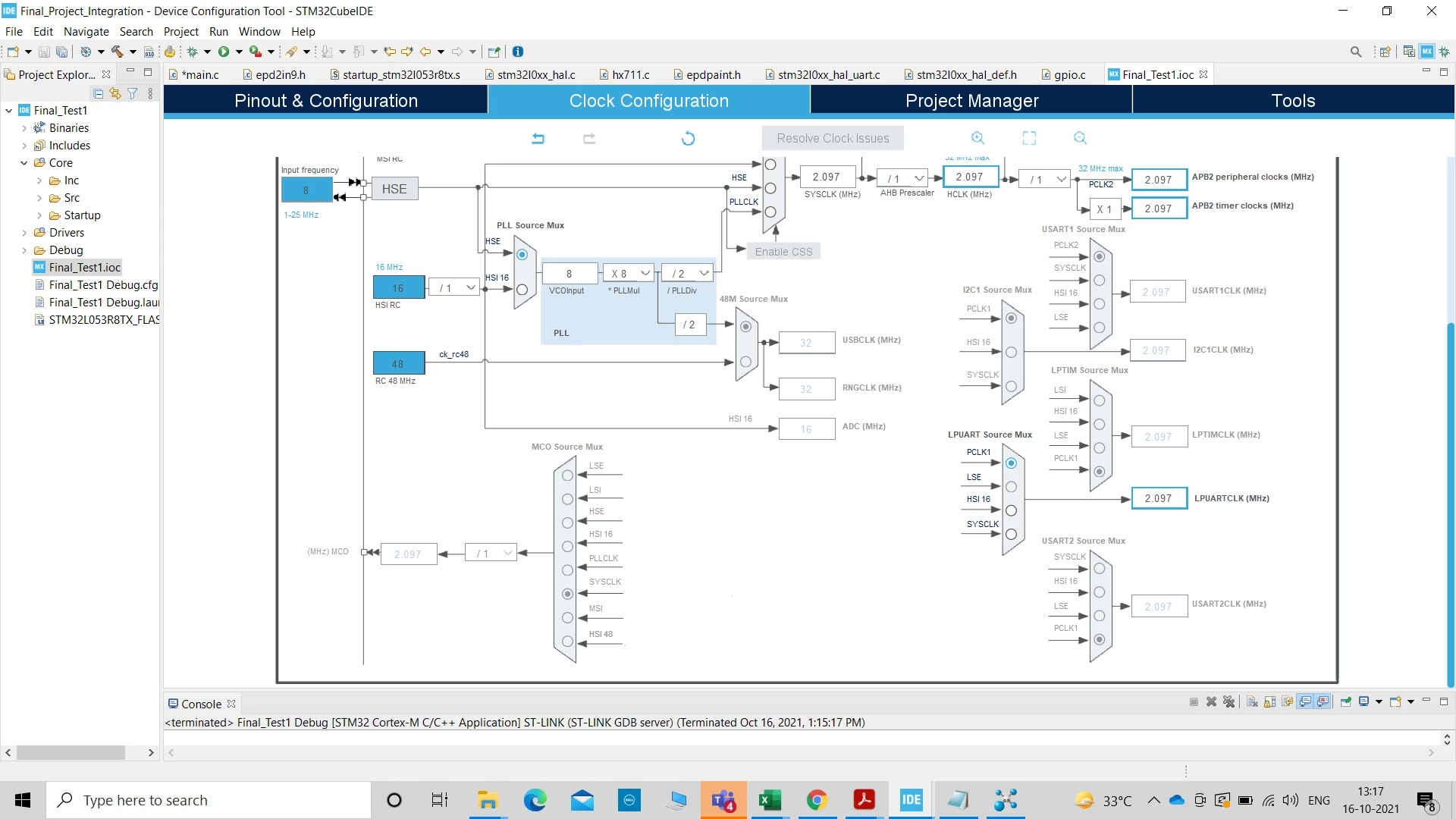

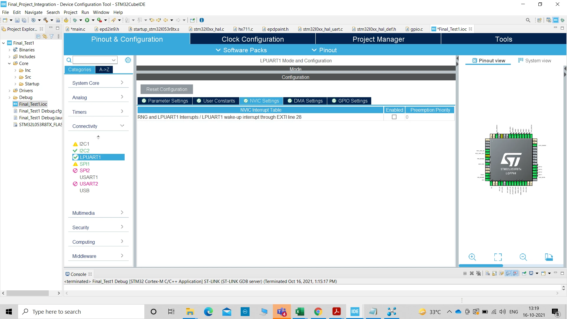

Not able to transmit data using LPUART .
Hey Guys ,
I have stm32l053r8 custom board . I am trying to send the data using LPUART but unable to send any data. I have shared the snapshot of the code and the configuration . Please do let me know what I am doing wrong ?

Is it initialized with HAL_UART_Init?
What is the return value from HAL_UART_Transmit?

All the initialization has been done through CubeMx .
HAL_UART_Transmit returns 0 as value.
One more thing , I have external pull up resistor connected to LPUART TX and RX line of 3.3 v.

Perhaps stop approaching this like a software engineer,and put a scope on the pins (both RX and TX) whilst sending a U character.
Check the signal and the timing.
Perhaps rely less on CubeMX doing the right thing.
What pins are involved?
What are they connecting too to determine the "not working" state?
