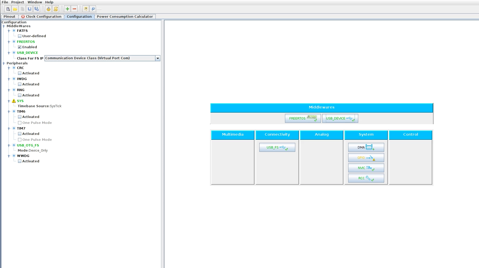

Not able to send via USB_CDC more than 8 characters (code from CubeMX)
Posted on January 13, 2017 at 14:51
edit: previously I wrote that problems occurs with freertos, I checked without it and I am having the same problem (ending in dead loop after sending more than 8 characters).
Steps to reproduce:
Create project in CubeMX for STM32F4DISCOVERY, enable USB_FS Device only. Configure clock: PLL_N = 72, PLL_Q=3, that gives me 48 MHz for usb, other settings remain unchanged. In configuration I enable CDC device with default parameters. Generate code for SW.
I add some led toggle in order to know it it is running.
/* StartDefaultTask function */
void StartDefaultTask(void const * argument)
 /* init code for USB_DEVICE */
 MX_USB_DEVICE_Init();
 /* USER CODE BEGIN 5 */
 /* Infinite loop */
 for(;;)
 HAL_GPIO_TogglePin(LD3_GPIO_Port, LD3_Pin);
 osDelay(500);
 /* USER CODE END 5 */
In file usbd_cdc_if.c I am setting breakpoint at CDC_Receive_FS function.
When I am sending 8 characters or less it works fine. Program enters function above. When I send more than 8 characters, program is not entering CDC_Receive_FS function

zdzichucb
zdzichucbAuthor
Jan 13, 2017 6:56 PM UTC
Posted on January 13, 2017 at 18:56
Nope, I'm not adding anything but one line for blinking led. Beside that pre code generated by CubeMX
https://hastebin.com/ucobocuwih.swift
and here settings from CubeMX:
I will try now to makek it without freertos to see if something will change.
zdzichucb
zdzichucbAuthor
Jan 13, 2017 8:53 PM UTC
Posted on January 13, 2017 at 21:53
By default CubeMX sets rx and tx buffer to 4 bytes (but they remain in user code section.
/* Define size for the receive and transmit buffer over CDC */
/* It's up to user to redefine and/or remove those define */
#define APP_RX_DATA_SIZE 4
#define APP_TX_DATA_SIZE 4�?�?�?�?
further buffers are defined one by one, so while receiving data if you go outside rx buffer, you will be in tx buffer (so kind of safe zone), writing 9 bits will write data further.
