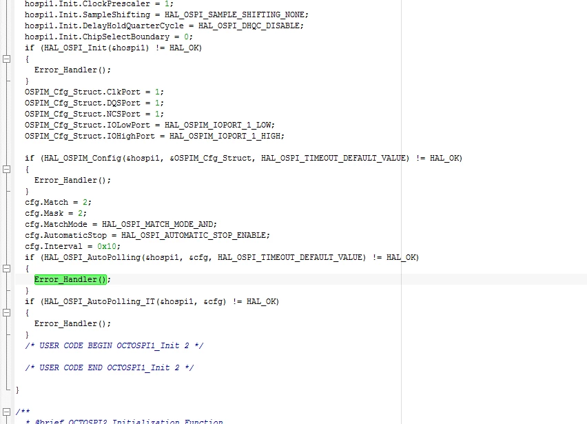

Nor-Flash on Octospi1
I am using the eval board STM32L4R9I-EVAL.
The generated code failde in OCTOSPI1_Init/ HAL_OSPI_AutoPolling:
it runs by
 if ((hospi->State == HAL_OSPI_STATE_CMD_CFG) && (cfg->AutomaticStop == HAL_OSPI_AUTOMATIC_STOP_ENABLE))
else
into HAL_Error.
does any one know why?
CubeMX: V5.1.0
Package for STM32L4: V1.13.0
Octospi2 on Hyperram works fine.

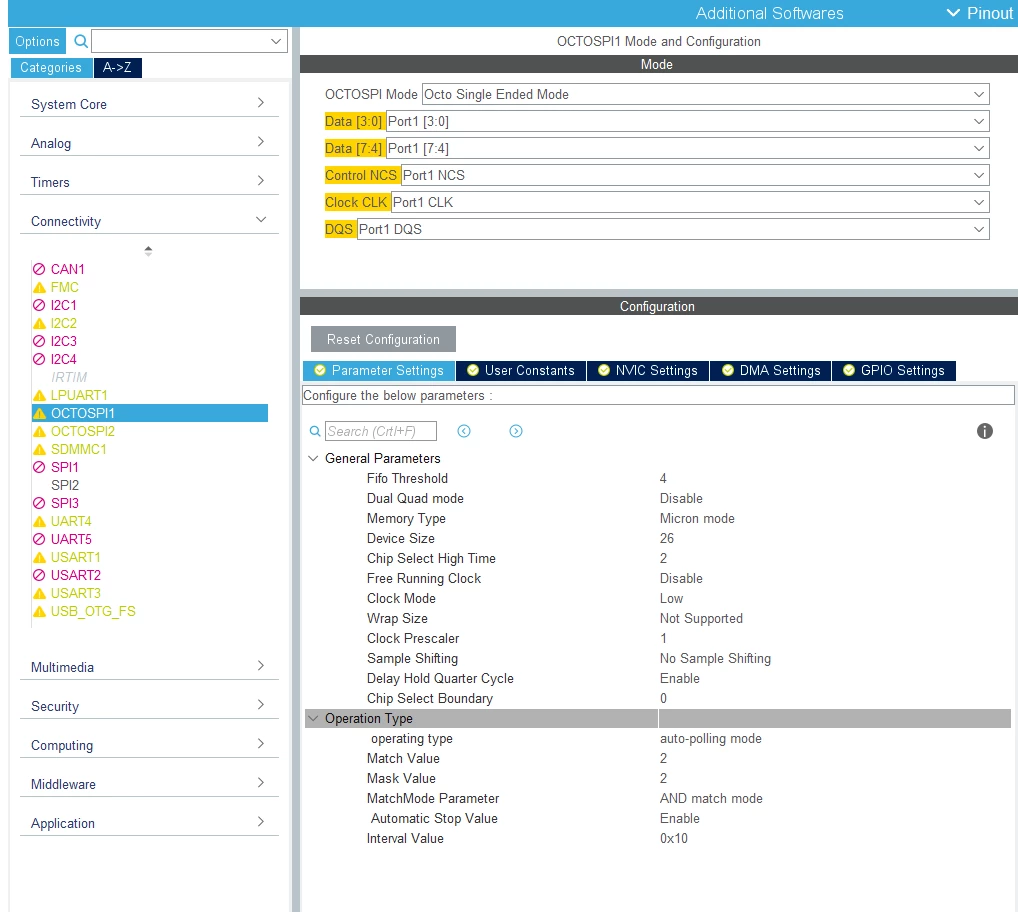

the OCTOSPI1 in CubeMX Config:

Hello @Leo_Panda​ ,
Have a look to the STM32L4Rxxx Errata sheet to check if you have the same conditions as described in the 2.7 OCTOSPI section.
You can share your ioc file or code and provide more details to let community users helping you.

Using L4R9I-EVAL Board. cubemx generate the ini cod for OCTOSPI1:
static void MX_OCTOSPI1_Init(void)
 /* USER CODE BEGIN OCTOSPI1_Init 0 */
 /* USER CODE END OCTOSPI1_Init 0 */
 OSPIM_CfgTypeDef OSPIM_Cfg_Struct = {0};
 OSPI_AutoPollingTypeDef cfg = {0};
 /* USER CODE BEGIN OCTOSPI1_Init 1 */
 /* USER CODE END OCTOSPI1_Init 1 */
 /* OCTOSPI1 parameter configuration*/
 hospi1.Instance = OCTOSPI1;
 hospi1.Init.FifoThreshold = 4;
 hospi1.Init.DualQuad = HAL_OSPI_DUALQUAD_DISABLE;
 hospi1.Init.MemoryType = HAL_OSPI_MEMTYPE_MACRONIX;
 hospi1.Init.DeviceSize = 25;
 hospi1.Init.ChipSelectHighTime = 4;
 hospi1.Init.FreeRunningClock = HAL_OSPI_FREERUNCLK_DISABLE;
 hospi1.Init.ClockMode = HAL_OSPI_CLOCK_MODE_0;
 hospi1.Init.WrapSize = HAL_OSPI_WRAP_NOT_SUPPORTED;
 hospi1.Init.ClockPrescaler = 1;
 hospi1.Init.SampleShifting = HAL_OSPI_SAMPLE_SHIFTING_NONE;
 hospi1.Init.DelayHoldQuarterCycle = HAL_OSPI_DHQC_DISABLE;
 hospi1.Init.ChipSelectBoundary = 0;
 if (HAL_OSPI_Init(&hospi1) != HAL_OK)
 Error_Handler();
 OSPIM_Cfg_Struct.ClkPort = 1;
 OSPIM_Cfg_Struct.DQSPort = 1;
 OSPIM_Cfg_Struct.NCSPort = 1;
 OSPIM_Cfg_Struct.IOLowPort = HAL_OSPIM_IOPORT_1_LOW;
 OSPIM_Cfg_Struct.IOHighPort = HAL_OSPIM_IOPORT_1_HIGH;
 if (HAL_OSPIM_Config(&hospi1, &OSPIM_Cfg_Struct, HAL_OSPI_TIMEOUT_DEFAULT_VALUE) != HAL_OK)
 Error_Handler();
 cfg.Match = 2;
 cfg.Mask = 2;
 cfg.MatchMode = HAL_OSPI_MATCH_MODE_AND;
 cfg.AutomaticStop = HAL_OSPI_AUTOMATIC_STOP_ENABLE;
 cfg.Interval = 0x10;
 if (HAL_OSPI_AutoPolling(&hospi1, &cfg, HAL_OSPI_TIMEOUT_DEFAULT_VALUE) != HAL_OK)
 Error_Handler();
 if (HAL_OSPI_AutoPolling_IT(&hospi1, &cfg) != HAL_OK)
 Error_Handler();
 /* USER CODE BEGIN OCTOSPI1_Init 2 */
 /* USER CODE END OCTOSPI1_Init 2 */
The call to HAL_OSPI_AutoPolling (line 87) runs into error.

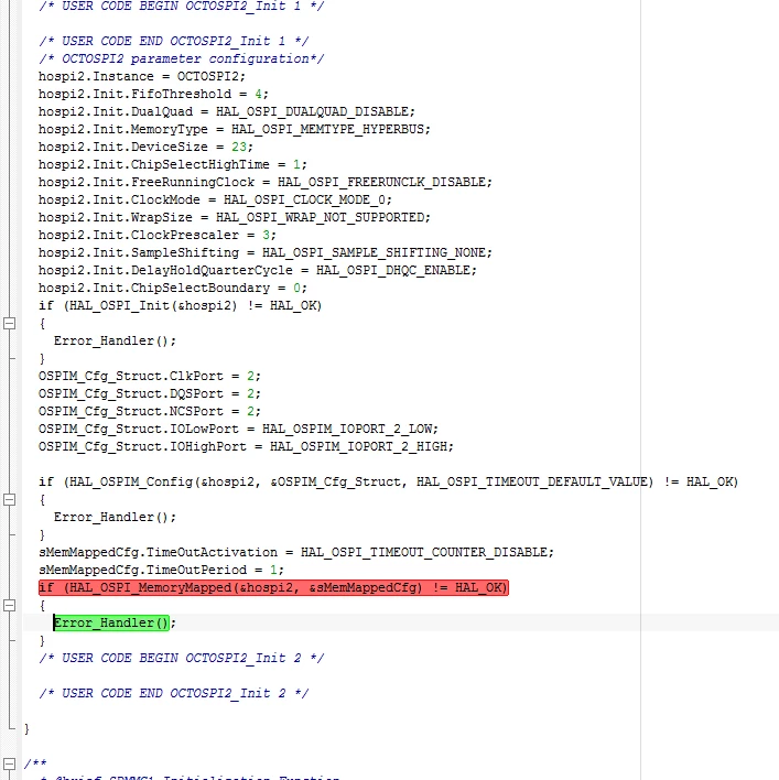

after donwload the cubemx 5.2 and package L4.1.14, the error remains. could you send me your generated code? I need only the project source code.
I test it now with a blank new STM32L4R9I-EVAL Board and without any modification of the code generated from cubemx. Since the standard Error-Handler() is an empty function, one have step into it, otherwise it runs through without any warnings!
With original code it runs into error even in MX_OCTOSPI2_Init / HAL_OSPI_MemoryMapped, but this is a known bug. HAL_OSPI_MemoryMapped() will be called after hyperbus is configured (call HAL_OSPI_HyperbusCfg) and the memory-mapped mode i configured (call HAL_OSPI_HyperbusCmd
with
sCommand.AddressSpace = HAL_OSPI_MEMORY_ADDRESS_SPACE;
 sCommand.AddressSize = HAL_OSPI_ADDRESS_32_BITS;
 sCommand.DQSMode     = HAL_OSPI_DQS_ENABLE;
 sCommand.Address     = 0;
 sCommand.NbData      = 1;)
I wonder why it is still not changed in the new Package L4.1.14

I tried the exsample in OSPI_NOR_MemoryMapped in STM32Cube_FW_L4_V1.13.0\Projects\STM32L4R9I-EVAL\Examples\OSPI\ long time ago, they work fine.
the example OSPI_NOR_MemoryMapped in STM32Cube_FW_L4_V1.14.0\Projects\STM32L4R9I-EVAL\Examples\OSPI\ works fine without any errors also.
The example has another structure and call first a few extra commands (enable write cmd and autopolling configuration command) before calling the function HAL_OSPI_AutoPolling. Now I hope with new release of L4-Packages cubemx could generate code which is usable. otherwise i have to modify it every time when i use cubemx to regenrate code.
I have the same problem with generated code für hyperram on octospi port 2. The generated code didn't work because it called the function HAL_OSPI_MemoryMapped to early, it should call it after the hyperbus is configured and the chip is set into memory-mapped mode, so i have to modify this section every time i regenerate code using cubemx.
How to report this to ST so it get corrected in the next release?
