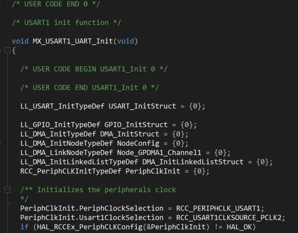

I want to manage a uart in reception with a DMA in circular mode using "low level" functions on a STM32U575ZITxQ processor. The initialization of my code is done with STM32CubeMx 6.13.0.
In the "Project Manager->Advanced Settings", I chose "LL" for "GPIO", "GPDMA", "TIM" and "USART".
In "Sytem Core->GPDMA1" channel1 is configured in circular mode with a "request" = USART1_RX.
When I generate the code, the following code is generated for the uart initialization function:
Unfortunately, as we can see, the node "Node_GPDMA1_Channel1" is declared local to the function, which makes its effective use impossible (unlike the "HAL" functions which make the node global).
For my code to work (and it does), it is necessary that I take the node declaration out of the function and make it global.
Of course, I have to repeat this change every time I regenerate the code with STM32CubeMx...
Is there something I didn't do correctly, or is this an STM32CubeMx issue?

By checking the generated code using CubeMx 6.13.0 :
LL_DMA_LinkNodeTypeDef Node_GPDMA1_Channel1;
LL_DMA_LinkNodeTypeDef Node_GPDMA1_Channel0;
/* USER CODE BEGIN PV */
/* USER CODE END PV */
Node_GPDMA1_Channel0 and Node_GPDMA1_Channel1 are global variables ,they are declared outside of any function.
Could you provide more details to push further the investigation.

I did other tests (using CubeMx 6.13.0), and I realize that the faulty behavior that I see occurs in the case where we select the option "Project Manager->Code Generator->Generate peripheral initialization as pair..."
In this case, the node "Node_GPDMA1_Channel1" is indeed declared locally:

void MX_USART1_UART_Init(void)
 /* USER CODE BEGIN USART1_Init 0 */
 /* USER CODE END USART1_Init 0 */
 LL_USART_InitTypeDef USART_InitStruct = {0};
 LL_GPIO_InitTypeDef GPIO_InitStruct = {0};
 LL_DMA_InitTypeDef DMA_InitStruct = {0};
 LL_DMA_InitNodeTypeDef NodeConfig = {0};
 LL_DMA_LinkNodeTypeDef Node_GPDMA1_Channel1 = {0};
 LL_DMA_InitLinkedListTypeDef DMA_InitLinkedListStruct = {0};
 RCC_PeriphCLKInitTypeDef PeriphClkInit = {0};
 /** Initializes the peripherals clock
 PeriphClkInit.PeriphClockSelection = RCC_PERIPHCLK_USART1;
 PeriphClkInit.Usart1ClockSelection = RCC_USART1CLKSOURCE_PCLK2;
 if (HAL_RCCEx_PeriphCLKConfig(&PeriphClkInit) != HAL_OK)
 Error_Handler();
 /* Peripheral clock enable */
The code therefore seems different (and faulty in one case) depending on whether we generate separate files or not for the initializations.
The problem seems the same regardless of the device and the direction of the transfer
If you can't see the problem, I can send you my ioc file...Kind regards,
Jean-Louis

Hello @JVERN.18
Your contribution is much appreciated.
A ticket  has been escalated to the development team in order to fix this issue . Internal ticket number 200663
I'll keep you informed about any updates.
