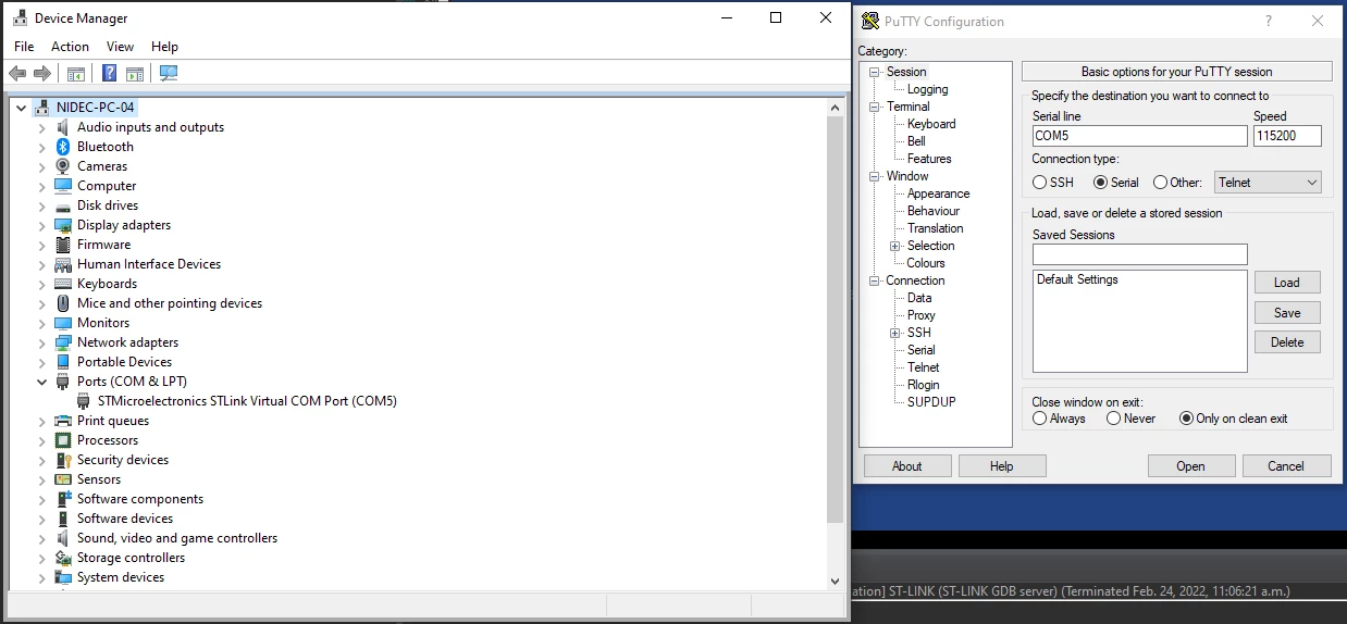

I have no console output for UART;
I am using STM32F429ZI dev-kit CubeMX and STM32CubeIDE
The codes compiles and I can see the light blinking but when I connect to Serial terminal with PuttY, I observe no console output.
What am I missing ?

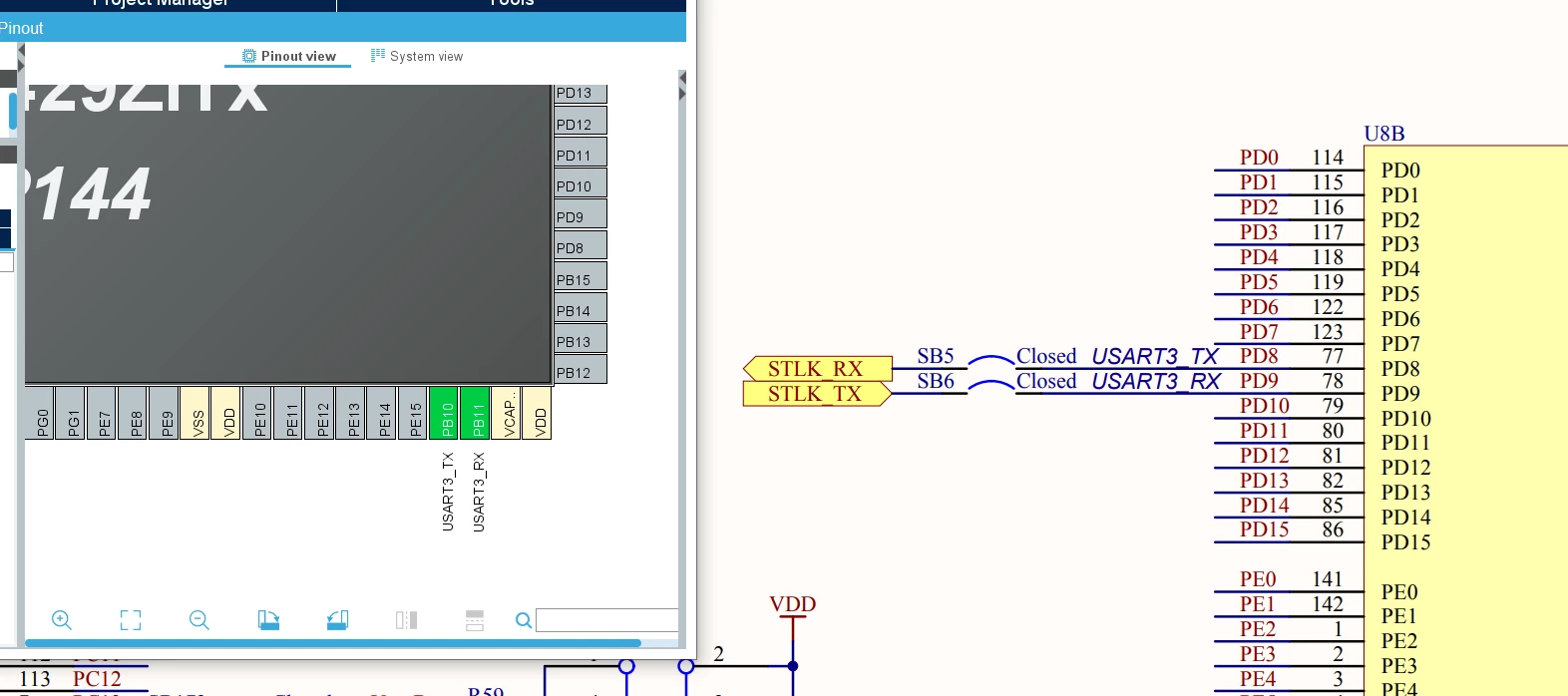

I was able to set up UART5 and observe the bit stream on oscilloscope on PC12 but as I can see on Schematic, the signal doesnt get routed to ST-Link.
PA2 & PA3 are routed to ST-Link (UART2) but no signal on Oscilloscope for PA2 (Tx Pin)
Tesla DeLorean
Guru
February 24, 2022
On the NUCLEO-F429ZI, the ST-LINK VCP is connected to USART3 via PD8/PD9, isn't it?
https://www.st.com/resource/en/user_manual/um1974-stm32-nucleo144-boards-mb1137-stmicroelectronics.pdf
