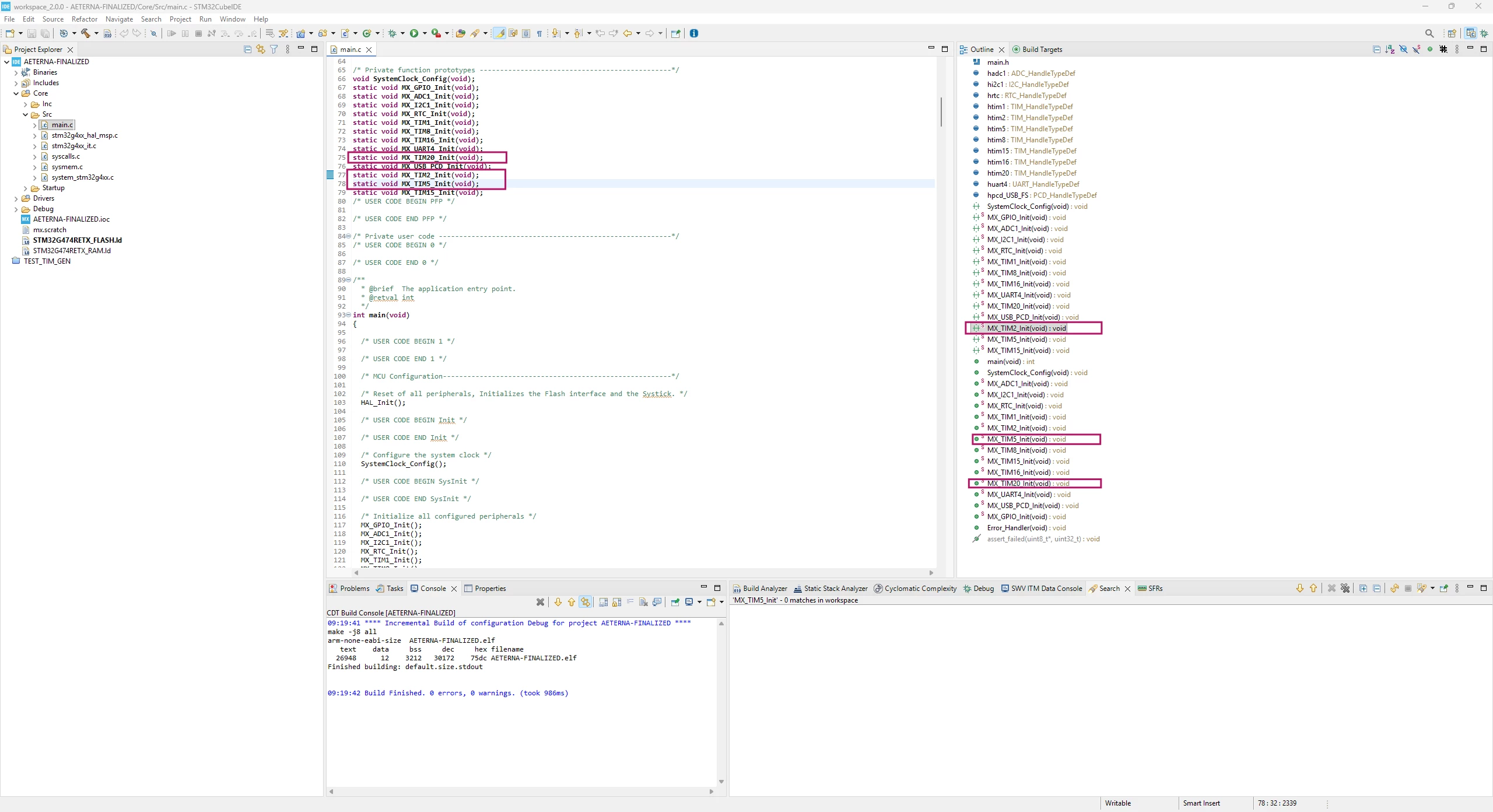

Im using the STM32G474RETx for my project.
I connected some timers for it but most of them warent generated on my main.c file (TIMER1, TIMER8 and TIMER16 were generated there), but TIM2,TIM5, TIM20 warent generated although i initiated them on the cube file.
In addition, the compile button is disabled.
Can someone help me with it please.
Attached is my cube file.

I was unable to reproduce the behavior described; TIM2, TIM5 and TIM20 initialization are well generated correctly with STM32CubeMX 6.18.1.

i also use version16/8.1 but still not getting any initialization of them

It sounds like you haven’t regenerated the code after making the changes.

thanks, but what changes do you mean ?

After you make changes in the IOC file, you need to regenerate the code by pressing the Generate Code button in order for the source code to be updated.
