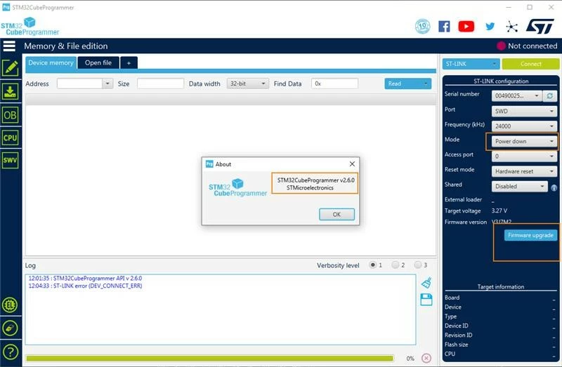

Your STLink FW version is an old version "V3J2M1".
Could you please upgrate your STLink firmware to be at "V3J7M3" version :

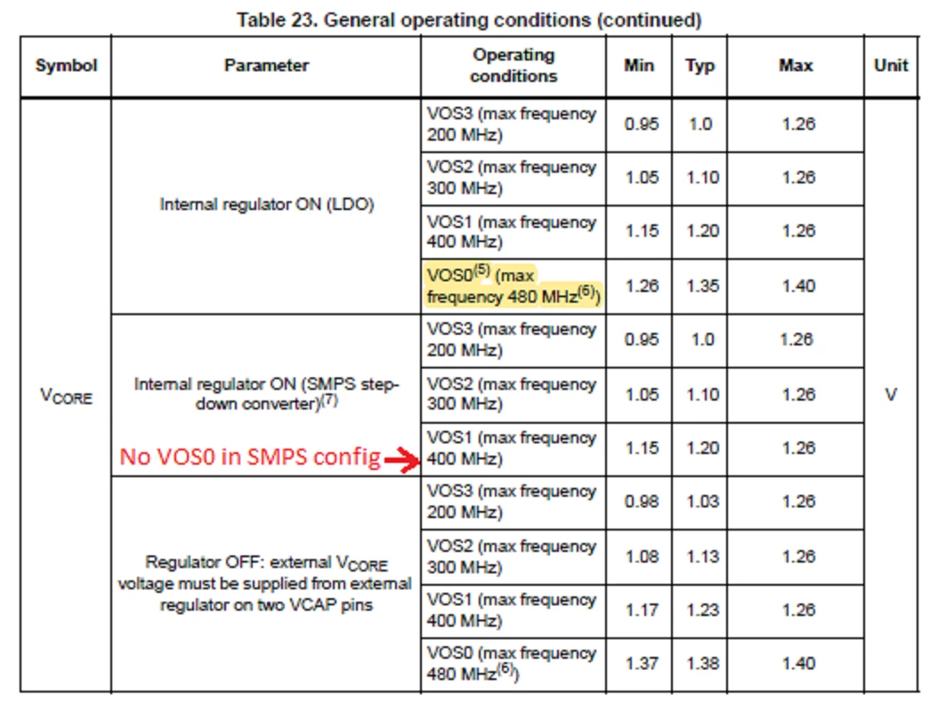

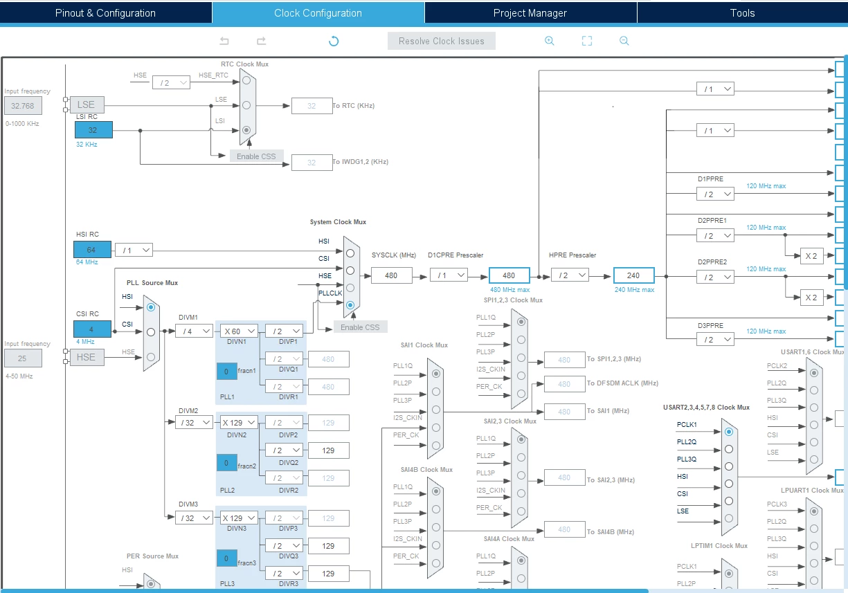

Dear @YVeda.1​ ,
First, the generated code doesn't correspond to the CubeMx config (as shown in your screenshot).

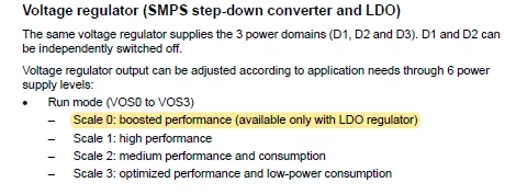

Second, the NUCLEO-H745ZI-Q board supports only SMPS config power supply. To run @480MHz you should select VOS0 (voltage scale 0) as indicated in the datasheet:
But VOS0 is only supported with LDO config not SMPS like indicated in the datasheet:
0693W00000Bd1jYQAR.pngSo you can't run your MCU with this board @480MHz.

Oops you are right the code I shared is wrong, I've updated the correct code generated by CubeMx
I followed some ST examples and set the max to 480 Mhz, now I don't really want to go to max frequency.

So how to recover your board and the MCU?
Please use the latest version of CubeProgrammer and connect the board in "Power down" mode as indicated here in below, then erase the Flash:
PS: once your question is answered, please click on "Select as Best" for the comment containing the answer to your initial question.

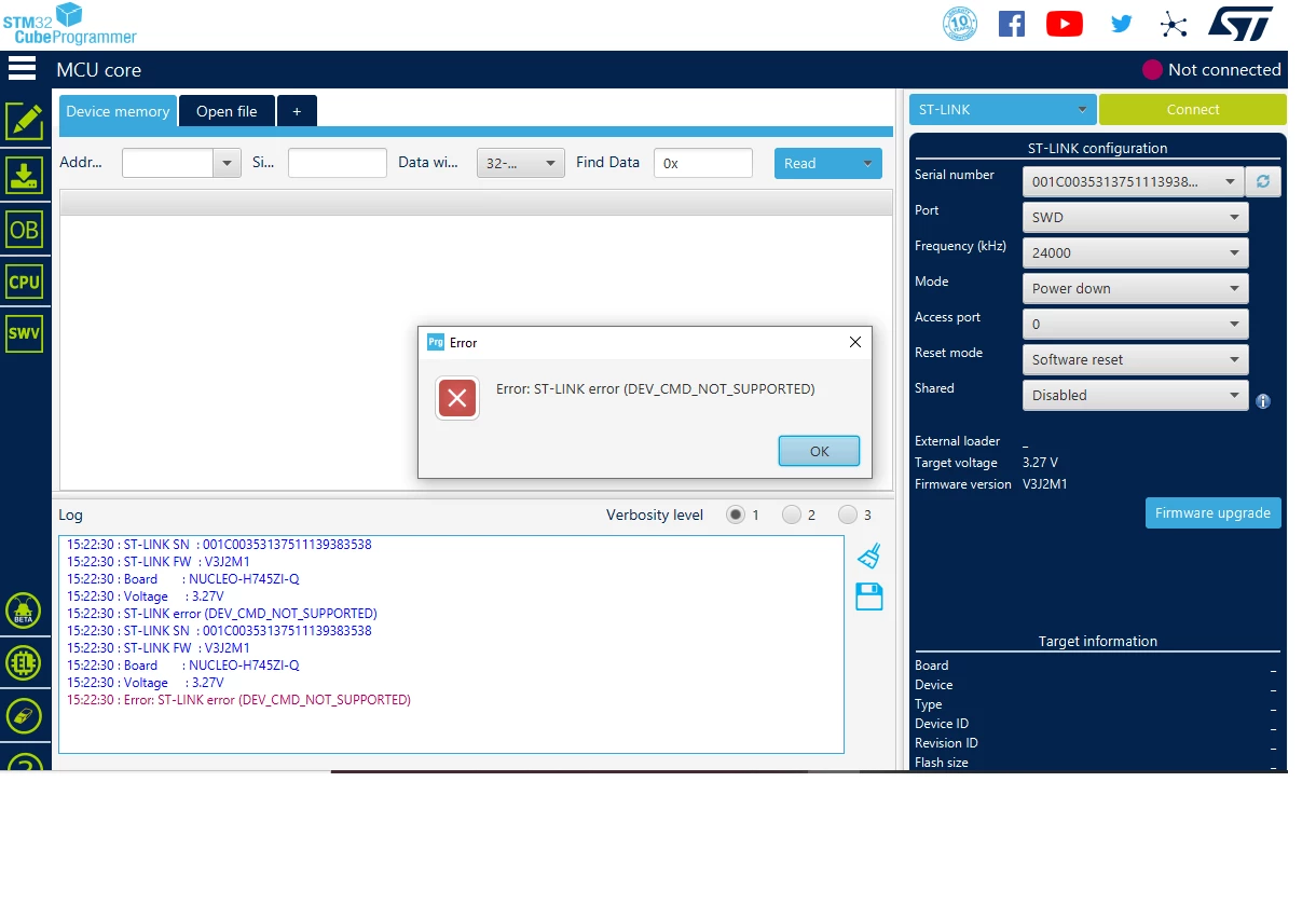

YVeda.1
YVeda.1Author
Jul 7, 2021 9:54 AM UTC
0693W00000Bd2JHQAZ.pngThanks for the quick reply, I've tried the suggestion but getting a different error now. I'm using the latest CubeProgrammer 2.7.0.
mƎALLEm
Jul 7, 2021 10:09 AM UTC
Could you please try to upgrade your STlink firmware:
Connect your board and click on "Firmware upgrade" button ..
mƎALLEm

YVeda.1
YVeda.1Author
Jul 7, 2021 10:24 AM UTC
Awesome, firmware upgrading the ST_LINK to V3J7M3 worked, now I'm able to connect and erase the flash. Thank you very much.
