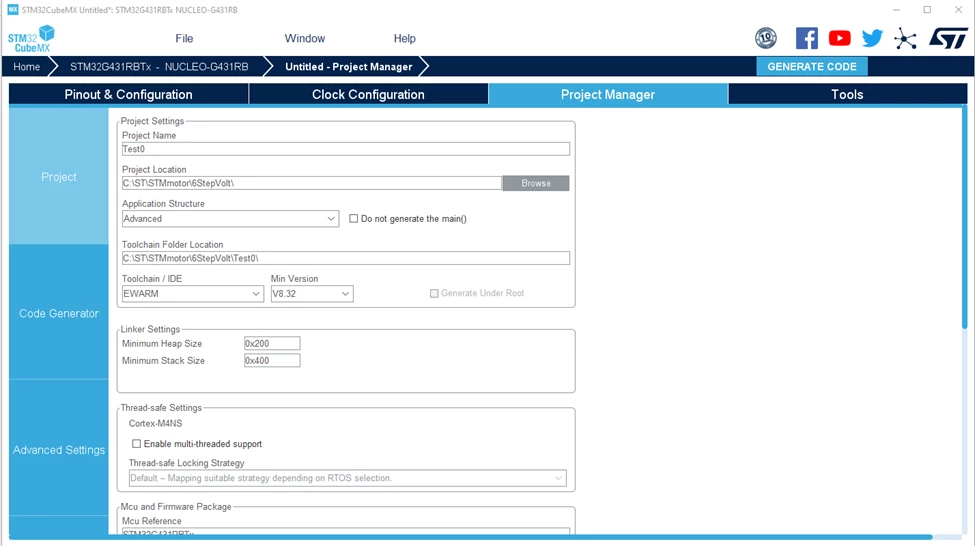

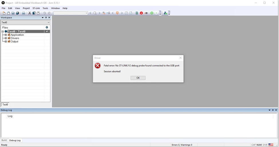

No ST-LINK/V2 debug probe found connected to the USB port I am using stm32CudeMX to generate a FW on a NUCLEO-G431RB board with the IAR workbench for ARM. IAR workbench version is 9.10.1.36323. The code was built without error, but the download faile

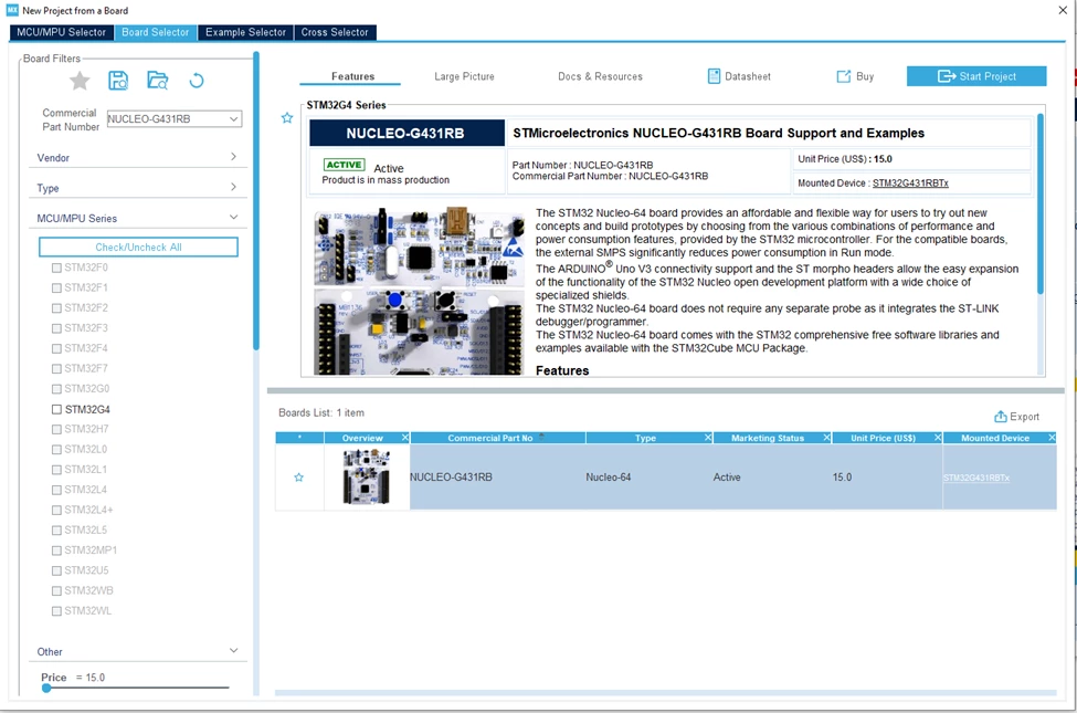

Step1: Start My project from ST Board:
0693W00000JM2j3QAD.pngStep 2: Selected the board and Start Project:

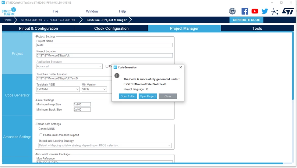

0693W00000JM2jXQAT.pngStep 4: Generate Code and Open Project:

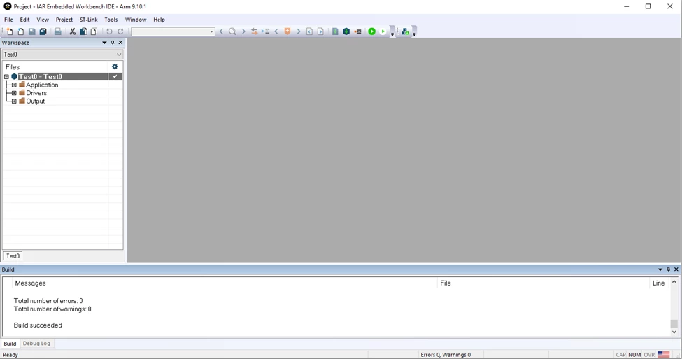

0693W00000JM2jmQAD.pngStep 5: Built the code without errors:
0693W00000JM2jwQAD.pngStep 6: Downloaded the code and got Fatal error:

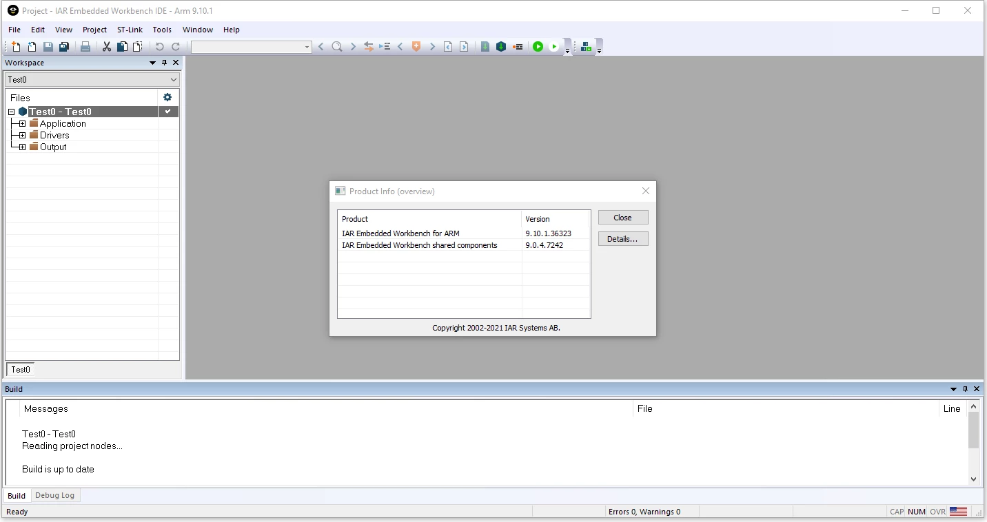

0693W00000JM2k1QAD.pngIAR product info:

G431 is relative new, you need new stlink fw and tools to flash. I have similar troubles with first use this nucleo with IDE . Need upgrade stlink GDBserver and fw onboard stlink too.

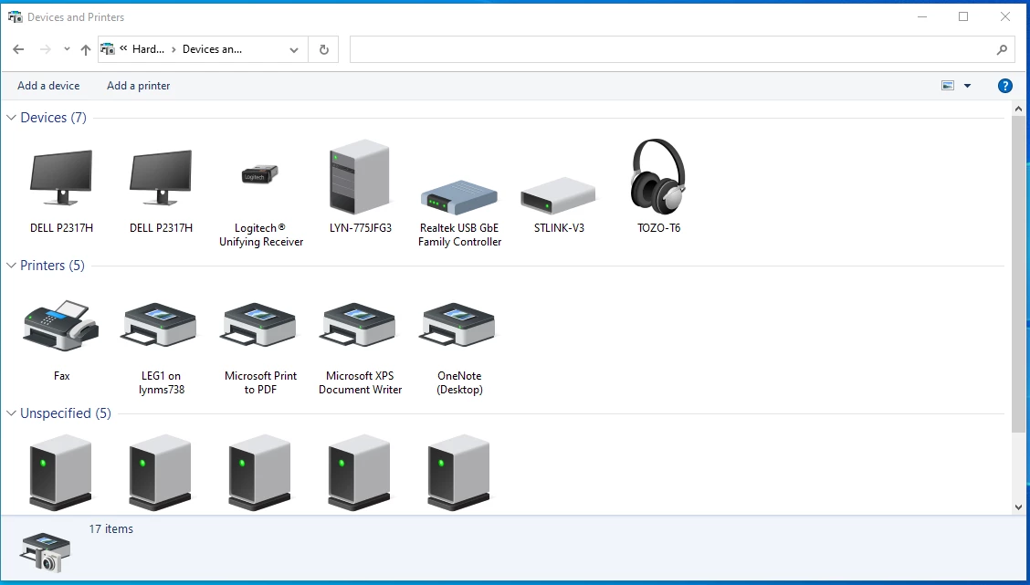

Can you connect with STM32CubeProgrammer? Does it show up in device manager?

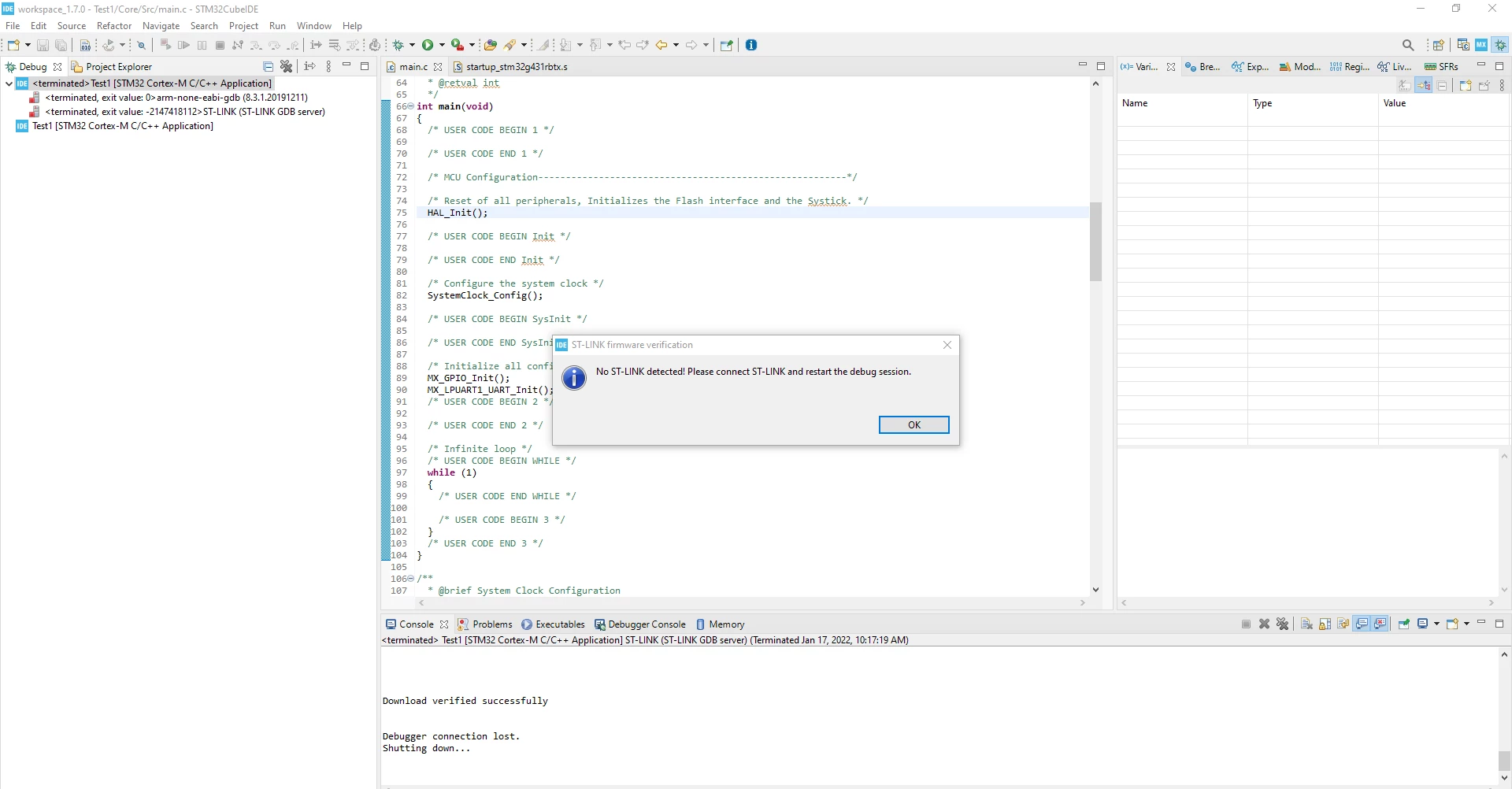

The STM32CubeProgammer download OK, but still getting the "No ST-LINK detected" problem:
0693W00000JMGRrQAP.pngThe ST link show up in the device manager OK:
MM..1
Jan 17, 2022 5:10 PM UTC
Download install and run STM32CubeProgammer after build in IAR
and try load with STM32CubeProgammer. When you done reconfig IAR to use external cmd flash and try STM32CubeProgammer_CLI
And your IDE screenshot have download success displayed, then your stlink is disconected by code run maybe you use SWD in code , then no debuger will work.
