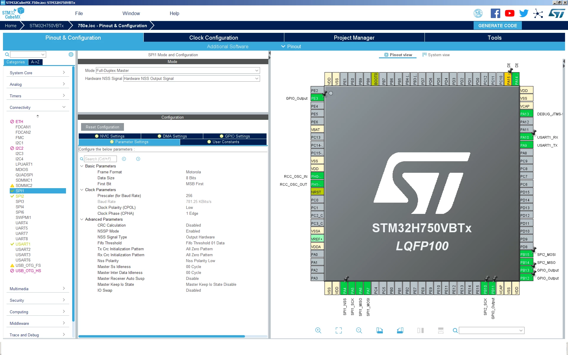

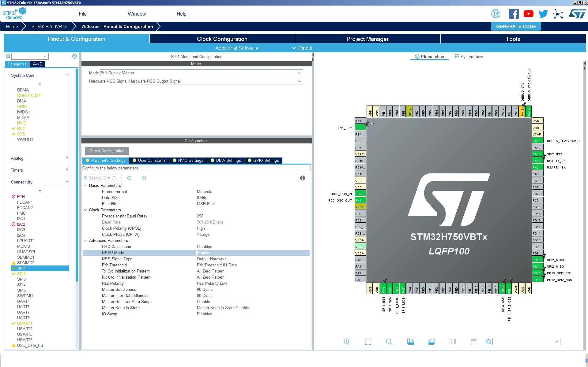

No SPI MOSI and CLK without NSS?
I don't need NSS signal or pin, I would rather use it as a real Chip select. But it looks like it there is no SPI at all without NSS? What should I change? CPU is STM32H750.
Edit: Where did my screen capture go? For a short while I thought that I could insert images from clipboard. But no.0693W000000Wfo1QAC.png
7 replies
Apr 29, 2020 3:17 PM UTC
You're changing the wrong thing. Change the "Hardware NSS Signal" pulldown at the top of the page.

Thank you both.
You are sure that this "Change the "Hardware NSS Signal" pulldown at the top of the page." alone is enough? I thought that I have tried that too and many other combinations.
Currently I have a single SPI slave, MAX31865 a PT100 chip, on the bus and I am handling the chip select with a GPIO pin. What I have read the NSS signal tells that it isn't very helpful.
Apr 29, 2020 6:07 PM UTC
Yes, set it to disabled and just go try it. If it doesn't work, post a screenshot.

I got it working, at least I see clock and MOSI. I have some work to do yet, but got forward. Thank you.
