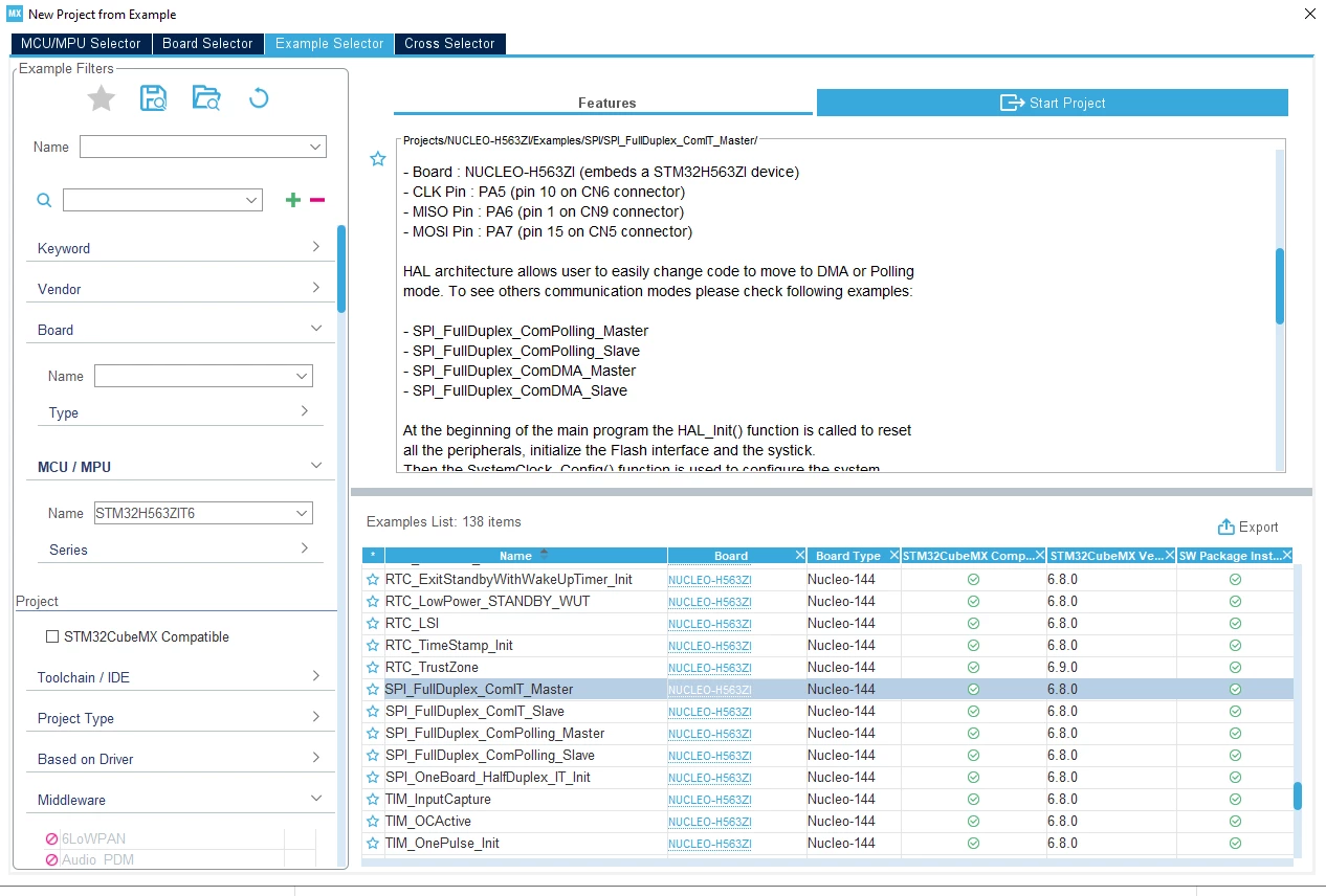

I am unable to find a SPI_FullDuplex_ComDMA_Master/Slave examples for the NUCLEO-H563ZI board in CubeMX (v6.11.0). Can you please point where this example can be found?
Thanks in advance
1 reply
STTwo-32
April 2, 2024
Hello @WCarey
For the NUCLEO-H563ZI we only have SPI_FullDuplex_ComPolling_Master/Slave and SPI_FullDuplex_ComIT_Master/Slave examples. If you are looking for the SPI_FullDuplex_ComDMA_Master/Slave, you can refer to the examples based on the NUCLEO-H503RB. And try to adapt them to the NUCLEO-H563ZI.
