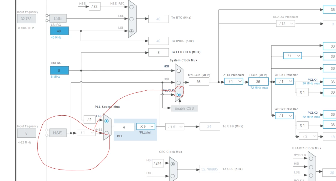

for the since start of year i've been setting up boards with Texas C2000 , and for the past 6 months infineon tri-core processors.  I may be changing jobs and it involves STM32 so i'm getting a head start. I have a STM32373C-EVAL , as i need TFT display and CAN. i have attempted to make a 'blinky ' project. Compiles fine but when it runs it hangs on the oscilator start up . Fresh install of STM32CubeIDE so used the config tool and let it do all the defaults.. The dev kit has solder bridges for crystal - they are open , but i've let it use the PLL.  it wont let me
When running in debug it 'hangs' on stopping the code , its in the error handler from the system clock settings , if i comment out the error handler it runs .

Sep 15, 2024 5:11 PM UTC
Hello @John_S and welcome to the community,
According to your Clock config and the screenshot you shared, you are using the internal clock HSI as clock source for the system not HSE (for external crystal usage):
And from your code:
RCC_OscInitStruct.OscillatorType = RCC_OSCILLATORTYPE_HSI;
RCC_OscInitStruct.PLL.PLLSource = RCC_PLLSOURCE_HSI;
RCC_OscInitStruct.PLL.PLLMUL = RCC_PLL_MUL9;
That's strange!
Could you please attach your ioc file?

I don't see anything that stands out as a problem. It has been a while since I worked with an STM32F3. Are you sure that the sysclock is actually running at 36MHz when it returns with an error?
I recommend stepping through the code in the debugger to see where it is returning with an error.
Set a breakpoint on the line that calls HAL_RCC_ClockConfig() and step into that function until an error is returned. It should provide a bit more information on what is triggering the failure.
Andrew Neil
Sep 16, 2024 2:48 PM UTC
Not quite sure what you mean here?
As shown (as @mƎALLEm said) you are using HSI - is that the case which fails?
Or are you trying to use HSE, and that's the case which fails?
To use HSE, you'll need an external crystal connected - ie, the solder bridges closed

mƎALLEm
Sep 16, 2024 3:30 PM UTC
That config is different from what you posted in the first post:
The first one is using HSI and now it is using HSE. Please try to not induce us to confusions during the discussions.
Are you sure X2 crystal is mounted on its socket? Is R38 soldered?

mƎALLEm
Sep 16, 2024 3:43 PM UTC
And if you revert o the first config: HSI (remove USB function for the moment), do you get the same behavior?

mƎALLEm
Sep 16, 2024 3:54 PM UTC
First, in next time please use </> button to share your code. I'm editing your post then .
Second, as with HSI is working, I'm pretty sure it's something related to the crystal. Be sure the crystal has contact in the socket. Maybe to apply a bit pressure on it with your finger.
John_SAuthor
Sep 18, 2024 9:32 AM UTC
after some messing , i've took the board in to work were we have some spare crystals ... we didnt have a spare 8mhz but we did have some 16's so i've tried one of those ... low and behold after changing the setup and clock config it looks like its working.  More checking as i've only quickly hooked the crystal up to try it. i'll buy a 8meg when i get chance and this will prove the point.

mƎALLEm
Sep 18, 2024 9:39 AM UTC
Hello @John_S ,
This feedback proves my assumption: the issue was on the crystal itself ;);)
