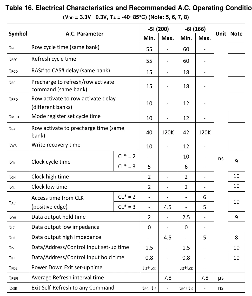

I've migrated to a new custom board, which uses a STM32F746IE and a new SDRAM model, NDS36PT5-20ET by Insignis. And although I could make a MT48LC16M16A2 by Micron work in the previous board, I have no luck with the Insignis SDRAM.

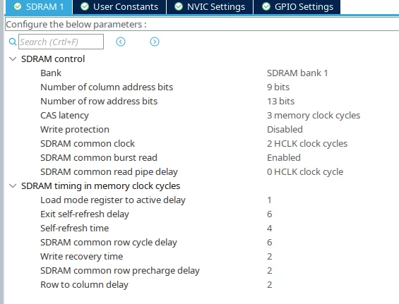

The Insignis SDRAM is rated for 200 MHz. I'm using a system clock of 200 MHz, so the SDRAM is clocked at 100 MHz. Based on the timings in the datasheet, I configured CubeMX like this:
0693W000006GvOuQAK.pngEach FMC cycle is 10 ns, so I divided the datasheet time by 10 ns and rounded up. The Write recovery time would be 1 cycle, but CubeMX sets this to 2. I also chose a CL of 3, since the datasheet doesn't list any Clock cycle time for CL 2.

Since I still don't know how to deal with the fact that the 200 MHz SDRAM IC is only clocked at 100 MHz, I tried to double all timings and recalculate the clocks needed in CubeMX. I couldn't enter the Write recovery time value of 2, since that violates the internal working of SDRAMs, and had to enter 5 instead.
Alas, my updated values still don't work; again, the 16-bit value at address 0xc0000000 is 0x3ffe instead of 0.
