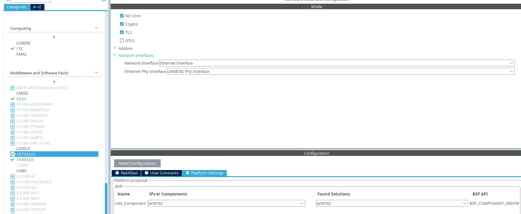

Dear community,
we're using a Makefile Project with STM32H5xx and NetX Duo using the LAN8742
When the code is generated, CubeMX is adding the line:
.../STM32Cube/Repository/STM32Cube_FW_H5_V1.1.1/Drivers/BSP/Components/lan8742/lan8742.c \
twice to the Makefile which leads to multiple definition errors in Compile.
The line has to be removed by Hand afterwards.
I think this is malicous behaviour here.
Best Regards
Pascal

I'm using CubeMX 6.1.0 and CubeIDE 1.13.2 but the version of IDE should not matter as bug is already in the cubemx-generated code. Below you see the cubemx configuration part of NETXDUO:
In ProjectManager I selected:
It seems that this one is only appearing in Makefile-Mode. Nevertheless this is needed for our project.

When I now "generate code" the produced Makefile has twice the source file of the network driver:
/home/pascal/STM32Cube/Repository/STM32Cube_FW_H5_V1.1.1/Drivers/BSP/Components/lan8742/lan8742.c \
which leads to:
usr/lib/gcc/arm-none-eabi/10.3.1/../../../arm-none-eabi/bin/ld: ../../Build/Release/lan8742.o: in function `LAN8742_RegisterBusIO':
lan8742.c:(.text.LAN8742_RegisterBusIO+0x0): multiple definition of `LAN8742_RegisterBusIO'; ../../Build/Release/lan8742.o:lan8742.c:(.text.LAN8742_RegisterBusIO+0x0): first defined here
Please tell me If I can post more needfull information. If you can't still reproduce I would generate a new project where I can post the corresponding files.
