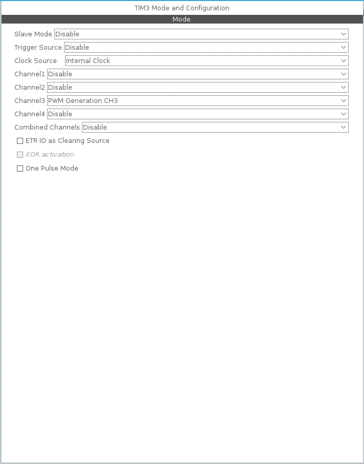

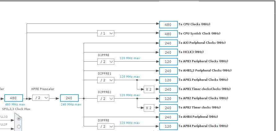

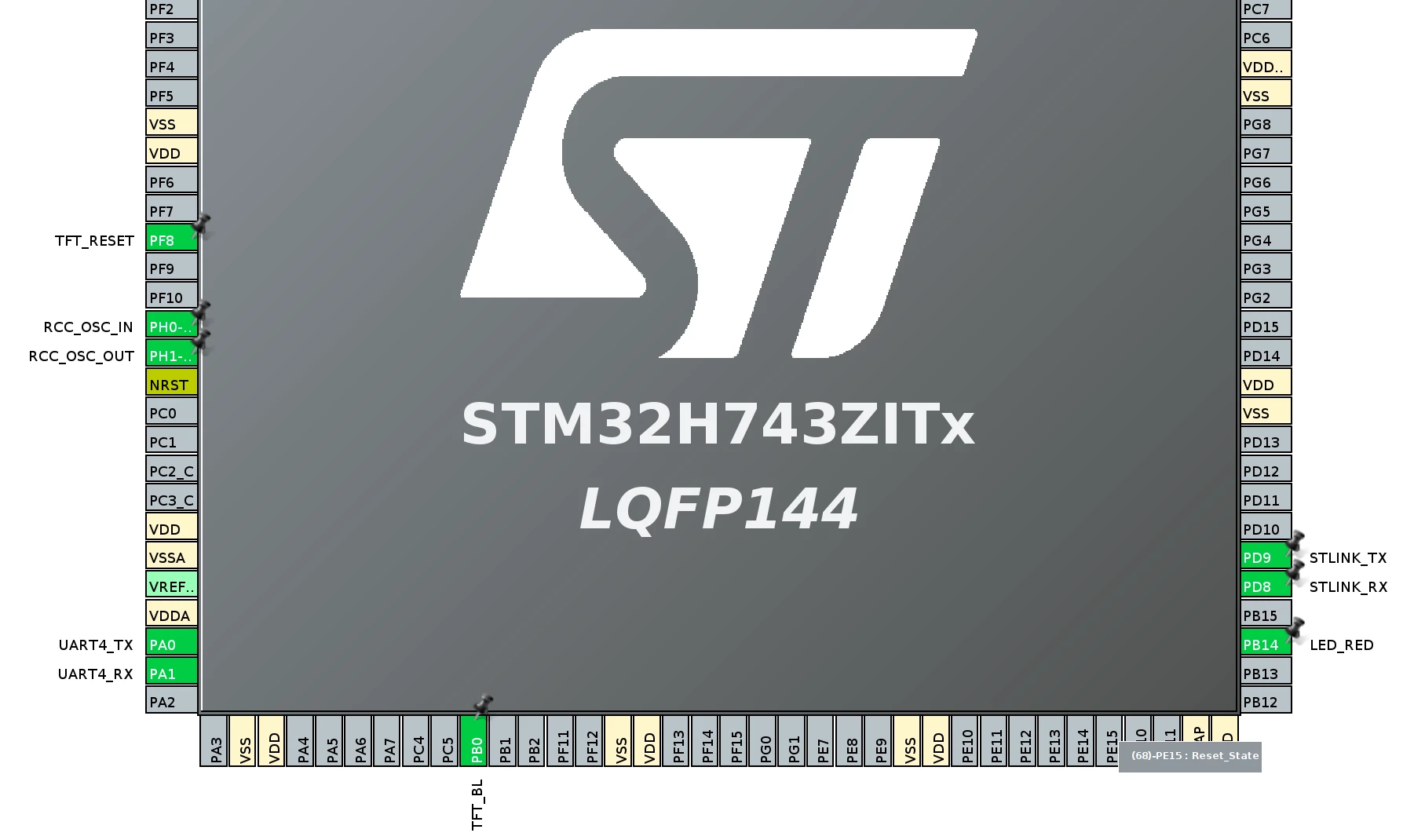

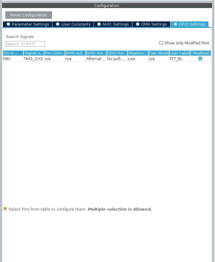

Need help to get PWM running with NUCLEO-H743ZI2 board

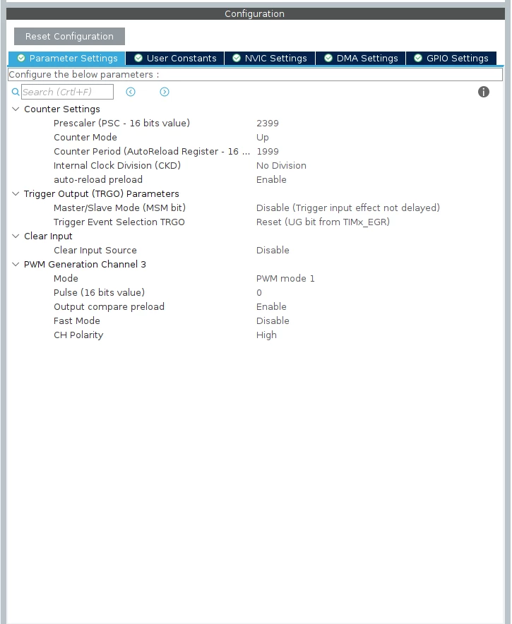

I am trying to generate a PWM signal with the help of several guides from internet that ultimately contain the same thing, but it does not work, I'm doing something wrong, but I cannot see what. As a result, I only see a zero line in the display of a digital analyzer.
I have included the most important settings in the appendix below.
With the values for Prescaler = 2399 I would like to achieve a timer clock of 100 kHz and for Period = 1999 a PWM frequency of 50 Hz. However, it is not entirely clear to me what the change in Pulse does. Is it the duty cycle?

static void MX_TIM3_Init(void)
 /* USER CODE BEGIN TIM3_Init 0 */
 /* USER CODE END TIM3_Init 0 */
 TIM_ClockConfigTypeDef sClockSourceConfig = {0};
 TIM_MasterConfigTypeDef sMasterConfig = {0};
 TIM_OC_InitTypeDef sConfigOC = {0};
 /* USER CODE BEGIN TIM3_Init 1 */
 /* USER CODE END TIM3_Init 1 */
 htim3.Instance = TIM3;
 htim3.Init.Prescaler = 2399;
 htim3.Init.CounterMode = TIM_COUNTERMODE_UP;
 htim3.Init.Period = 1999;
 htim3.Init.ClockDivision = TIM_CLOCKDIVISION_DIV1;
 htim3.Init.AutoReloadPreload = TIM_AUTORELOAD_PRELOAD_ENABLE;
 if (HAL_TIM_Base_Init(&htim3) != HAL_OK)
 Error_Handler();
 sClockSourceConfig.ClockSource = TIM_CLOCKSOURCE_INTERNAL;
 if (HAL_TIM_ConfigClockSource(&htim3, &sClockSourceConfig) != HAL_OK)
 Error_Handler();
 if (HAL_TIM_PWM_Init(&htim3) != HAL_OK)
 Error_Handler();
 sMasterConfig.MasterOutputTrigger = TIM_TRGO_RESET;
 sMasterConfig.MasterSlaveMode = TIM_MASTERSLAVEMODE_DISABLE;
 if (HAL_TIMEx_MasterConfigSynchronization(&htim3, &sMasterConfig) != HAL_OK)
 Error_Handler();
 sConfigOC.OCMode = TIM_OCMODE_PWM1;
 sConfigOC.Pulse = 0;
 sConfigOC.OCPolarity = TIM_OCPOLARITY_HIGH;
 sConfigOC.OCFastMode = TIM_OCFAST_DISABLE;
 if (HAL_TIM_PWM_ConfigChannel(&htim3, &sConfigOC, TIM_CHANNEL_3) != HAL_OK)
 Error_Handler();
 /* USER CODE BEGIN TIM3_Init 2 */
 /* USER CODE END TIM3_Init 2 */
 HAL_TIM_MspPostInit(&htim3);
/* USER CODE BEGIN 4 */
void pwm_setValue(uint32_t br)
 TIM_OC_InitTypeDef sConfigOC;
 bzero(&sConfigOC, sizeof(TIM_OC_InitTypeDef));
 sConfigOC.Pulse = br;
 if (HAL_TIM_PWM_ConfigChannel(&htim3, &sConfigOC, TIM_CHANNEL_3) == HAL_OK)
 HAL_TIM_PWM_Start(&htim3, TIM_CHANNEL_3);
/* USER CODE END 4 */
Can someone help me get PWM working? Where is my mistake?

First, try setting the pulse fom the beginning (In the init function).
Then run PWM_START and do nothing else. No updating, no changes.
That should work.
No need to run again HAL_TIM_PWM_ConfigChannel and HAL_TIM_PWM_Start.
If you already started PWM, just update the CCRx value:
__HAL_TIM_SET_COMPARE(&htim3, TIM_CHANNEL_3, br);
If you want to update the timer period:
__HAL_TIM_SET_AUTORELOAD(&htim3,period);
Also, ensure that the PWM output is CHx type, not CHxN.
If its's CHxN then the PWM should be started with:
HAL_TIMEx_PWMN_Start(&htim3, TIM_CHANNEL_3);

Mick P. F.
Apr 9, 2021 11:19 AM UTC
Hello David,
Many thanks for your help, it works now!
