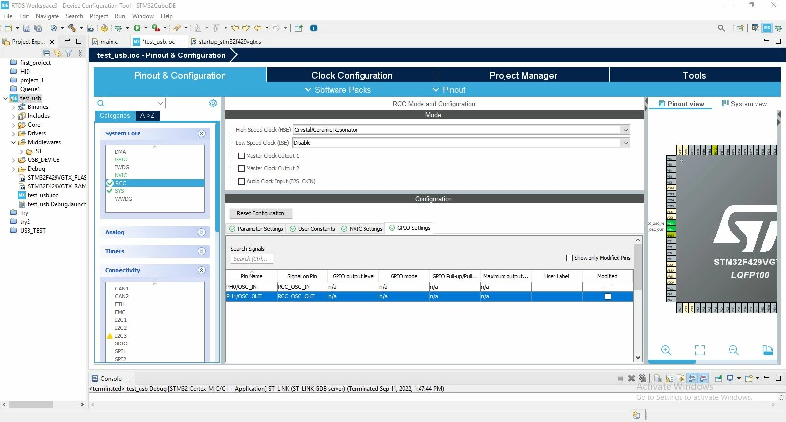

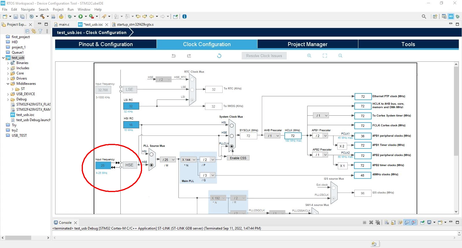

My STM32F429z Board USB HID is not detected by PC.I am totally new to this USB. Please help me out.
  • September 11, 2022
  • 7 replies
  • 3436 views
Hello all,

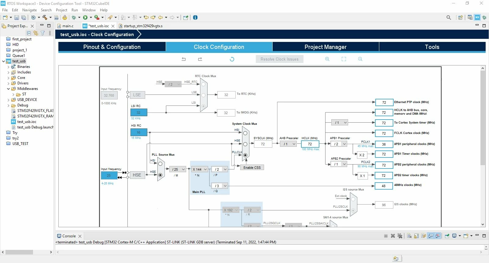

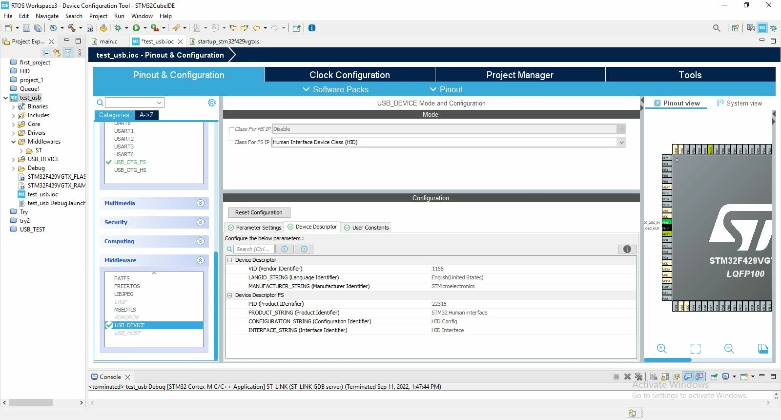

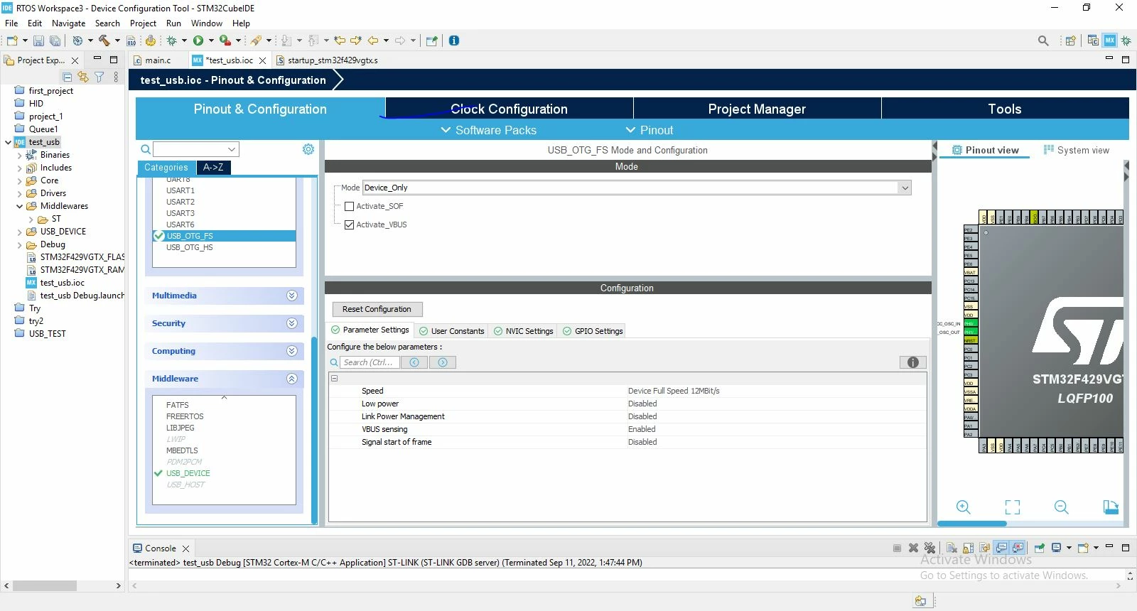

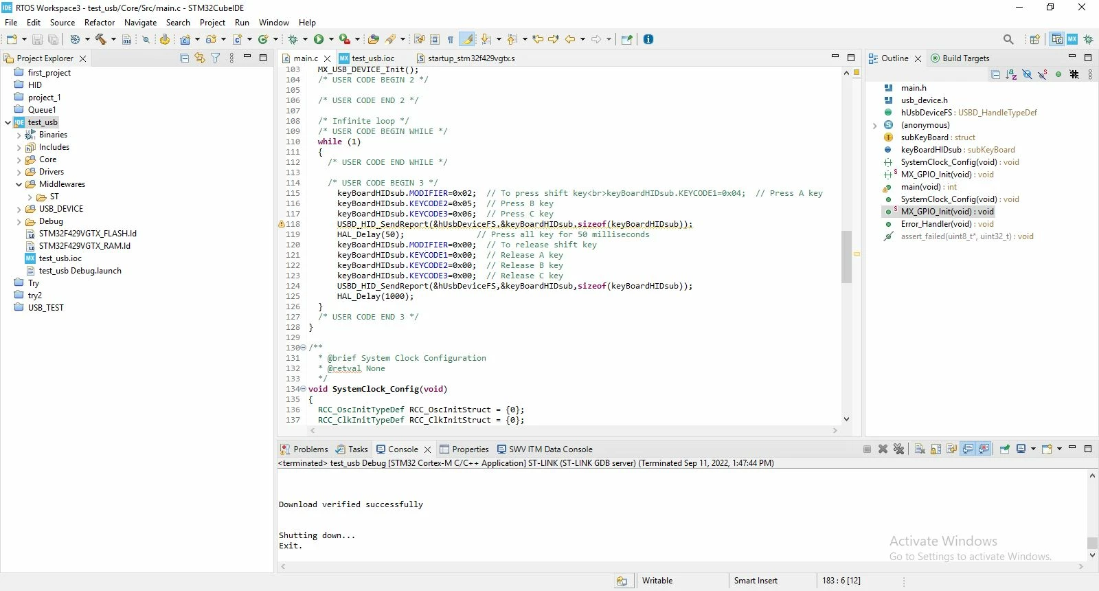

I have just write the code on newly buyed STM32F429z board of sending 3 characters continuously through USB HID but is not being detected on PC. Same code i fired on STM32F407 board then it is detected but Device descriptor error is occurring. I am tired of all solutions. Attaching the images for your reference. Please help me out

USB isnt so simple. Try use example codes from repository folder. (version change to your)
c:\Users\***\STM32Cube\Repository\STM32Cube_FW_F4_V1.26.2\Projects\STM32F429ZI-Nucleo\Applications\USB_Device\HID_Standalone\

I see that you configured the clock as HSE ( crystal /Ceramic Resonator ) but try verify the exact frequency for your board (8MHz expected value)
This does not look as 8MHz to me.
Ghofrane GSOURI
September 19, 2022
Hi @Community member​
I meant by "try verify the exact frequency for your board (8MHz expected value)" to change the value of the input frequency from 25 MHZ to 8 MHZ and regenerate the code .
