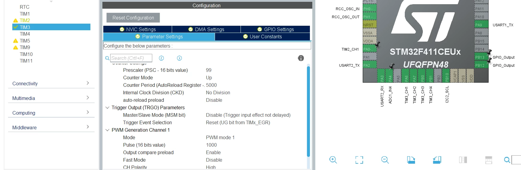

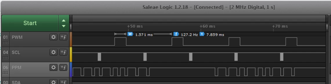

I have migrated some Code from a STM32f103 to my new STM32f411CEU6 Microcontroller. While configuring the Timers for the PWM generation I ran into a problem, namely the pulses are about 1500us, when they should be 1000us.

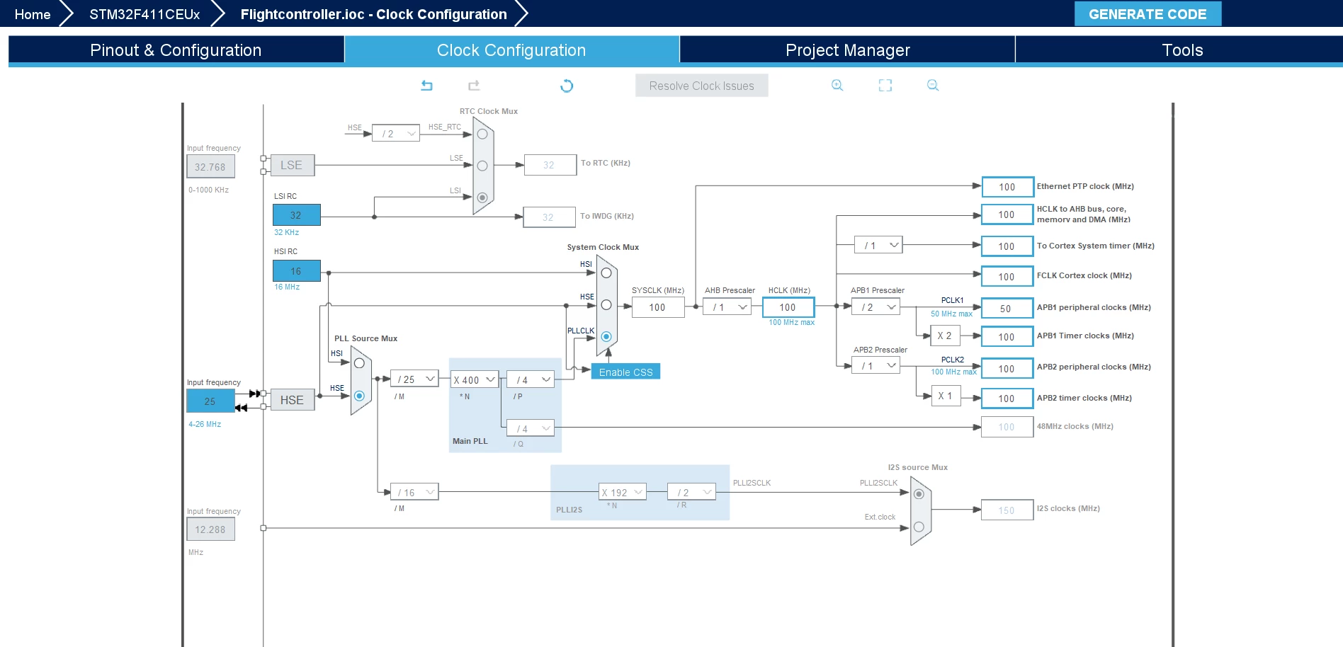

Here are my Clock and Timer configurations from the STM32CubeMX:
Clock configuration:
My PWM Setup:
The Measured Signals:
So I think i have configured the systemclock to have a frequency of 100Mhz, which gets fed to Timer3. A Prescaler of 99 should divide this pulse to 1us and a Pulse of 1000 should then result in Pulses with a width of 1000us.
I do not call any functions in my code, other than
HAL_TIM_PWM_Init(&htim3);
HAL_TIM_PWM_Start(&htim3, TIM_CHANNEL_1);
The from the CubeMX generated initialisation code for timer 3 looks like this and is called at the start of my program:
static void MX_TIM3_Init(void)
 /* USER CODE BEGIN TIM3_Init 0 */
 /* USER CODE END TIM3_Init 0 */
 TIM_MasterConfigTypeDef sMasterConfig = {0};
 TIM_OC_InitTypeDef sConfigOC = {0};
 /* USER CODE BEGIN TIM3_Init 1 */
 /* USER CODE END TIM3_Init 1 */
 htim3.Instance = TIM3;
 htim3.Init.Prescaler = 99;
 htim3.Init.CounterMode = TIM_COUNTERMODE_UP;
 htim3.Init.Period = 5000;
 htim3.Init.ClockDivision = TIM_CLOCKDIVISION_DIV1;
 htim3.Init.AutoReloadPreload = TIM_AUTORELOAD_PRELOAD_DISABLE;
 if (HAL_TIM_PWM_Init(&htim3) != HAL_OK)
 Error_Handler();
 sMasterConfig.MasterOutputTrigger = TIM_TRGO_RESET;
 sMasterConfig.MasterSlaveMode = TIM_MASTERSLAVEMODE_DISABLE;
 if (HAL_TIMEx_MasterConfigSynchronization(&htim3, &sMasterConfig) != HAL_OK)
 Error_Handler();
 sConfigOC.OCMode = TIM_OCMODE_PWM1;
 sConfigOC.Pulse = 1000;
 sConfigOC.OCPolarity = TIM_OCPOLARITY_HIGH;
 sConfigOC.OCFastMode = TIM_OCFAST_DISABLE;
 if (HAL_TIM_PWM_ConfigChannel(&htim3, &sConfigOC, TIM_CHANNEL_1) != HAL_OK)
 Error_Handler();
 sConfigOC.Pulse = 0;
 if (HAL_TIM_PWM_ConfigChannel(&htim3, &sConfigOC, TIM_CHANNEL_2) != HAL_OK)
 Error_Handler();
 if (HAL_TIM_PWM_ConfigChannel(&htim3, &sConfigOC, TIM_CHANNEL_3) != HAL_OK)
 Error_Handler();
 if (HAL_TIM_PWM_ConfigChannel(&htim3, &sConfigOC, TIM_CHANNEL_4) != HAL_OK)
 Error_Handler();
 /* USER CODE BEGIN TIM3_Init 2 */
 /* USER CODE END TIM3_Init 2 */
 HAL_TIM_MspPostInit(&htim3);
So my question is: What is wrong with the my setup, that i get ~1500us Pulses instead of 1000us?

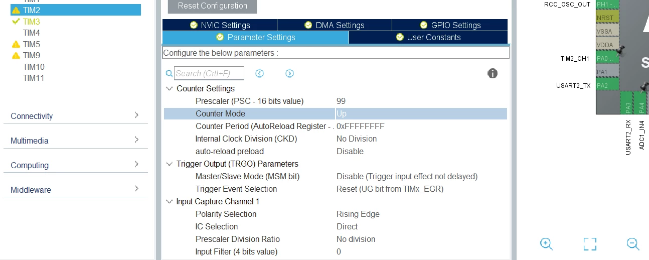

I have the same Problem with Timer2, where i measure pulsewidths via interrupt, which differ by the same factor.
My HSE Crystal has a frequency of 25MHz, changing the clocksource to HSI and the /M divider to 16 doesnt affect the result.
I also generate a I2C Clock with 400kHz. The generated signal is correct, making me believe, that the systemclock should be correct.
(My htim2 setup)

Mar 18, 2020 10:38 PM UTC
Your readings are off from the expected by a factor of 16/25. I would guess you're assuming you're using a 25 MHz crystal, but instead are using a 16MHz crystal or the 16 MHz HSI as the PLL source. This is by far the most likely explanation.
If you want to be super sure, output MCO an add that to your scope trace.

TKöhl.1
TKöhl.1Author
Mar 19, 2020 10:46 AM UTC
Thank you, for pointing me in the right direction!
I now configured the PLL to take the HSI as an Input, PLLM = 16, PLLN = 400 and PLLP = 4.
This does also reflect in the generated code:
void SystemClock_Config(void)
 __HAL_RCC_PWR_CLK_ENABLE();
 __HAL_PWR_VOLTAGESCALING_CONFIG(PWR_REGULATOR_VOLTAGE_SCALE1);
 /** Initializes the CPU, AHB and APB busses clocks
 RCC_OscInitStruct.OscillatorType = RCC_OSCILLATORTYPE_HSI;
 RCC_OscInitStruct.PLL.PLLSource = RCC_PLLSOURCE_HSI;
 RCC_OscInitStruct.PLL.PLLM = 16;
 RCC_OscInitStruct.PLL.PLLN = 400;
 RCC_OscInitStruct.PLL.PLLP = RCC_PLLP_DIV4;
 RCC_OscInitStruct.PLL.PLLQ = 4;
 Error_Handler();
 RCC_ClkInitStruct.APB1CLKDivider = RCC_HCLK_DIV2;
 RCC_ClkInitStruct.APB2CLKDivider = RCC_HCLK_DIV1;
 if (HAL_RCC_ClockConfig(&RCC_ClkInitStruct, FLASH_LATENCY_3) != HAL_OK)
 Error_Handler();
But when i read the PLLCFGR the configuration does not seem to take effect.
It reads 0x08012008 which translates to: PLLM = 8, PLLN = 128, PLLP = 4. Therefore the Sysclock clocks at 64 Mhz, which also explains the difference in timer pulses.
The SystemClock_Config method finishes without error, but does not set the registers correctly.
I the Problem might be, that PLL is already enabled, when SystemClock_Config() is called and I did not see that change, during the HAL_RCC_ClockConfig call.
Do you have any advice for me, on how to fix this or how to maybe configure the clock by myself?

Mar 19, 2020 1:19 PM UTC
Why is the PLL enabled prior to SystemClock_Config? You can't change it while it's enabled and being used as the system clock.
Are you sure this is completing without error? OR is it only completing because Error_Handler() is defined as nothing?

Mar 20, 2020 8:46 AM UTC
I now fixed the error. I am pretty sure, that PLL was configured as system clock prior to SystemClock_Config. While stepping through the code, I also hit the return HAL_OK statement of HAL_RCC_ClockConfig().
The Solution is pretty Simple. I let the CubeMX generate Code for configuring the HSI as System Clock. I copied this Method and called it just before the real SystemClock_Config() method. Now the PLL could be configured and i get the right Pulses as PWM and the peripheral Clocks seem to be right, too.
void SystemClockHSI_Config(void)
	RCC_OscInitTypeDef RCC_OscInitStruct = { 0 };
	RCC_ClkInitTypeDef RCC_ClkInitStruct = { 0 };
	RCC_OscInitStruct.PLL.PLLState = RCC_PLL_NONE;
		Error_Handler();
	RCC_ClkInitStruct.ClockType = RCC_CLOCKTYPE_HCLK | RCC_CLOCKTYPE_SYSCLK
	 | RCC_CLOCKTYPE_PCLK1 | RCC_CLOCKTYPE_PCLK2;
	RCC_ClkInitStruct.SYSCLKSource = RCC_SYSCLKSOURCE_HSI;
	if (HAL_RCC_ClockConfig(&RCC_ClkInitStruct, FLASH_LATENCY_0) != HAL_OK)
		Error_Handler();
This is the Method for configuring the HSI as clock source.
Thanks to everyone for your helpful advices!
