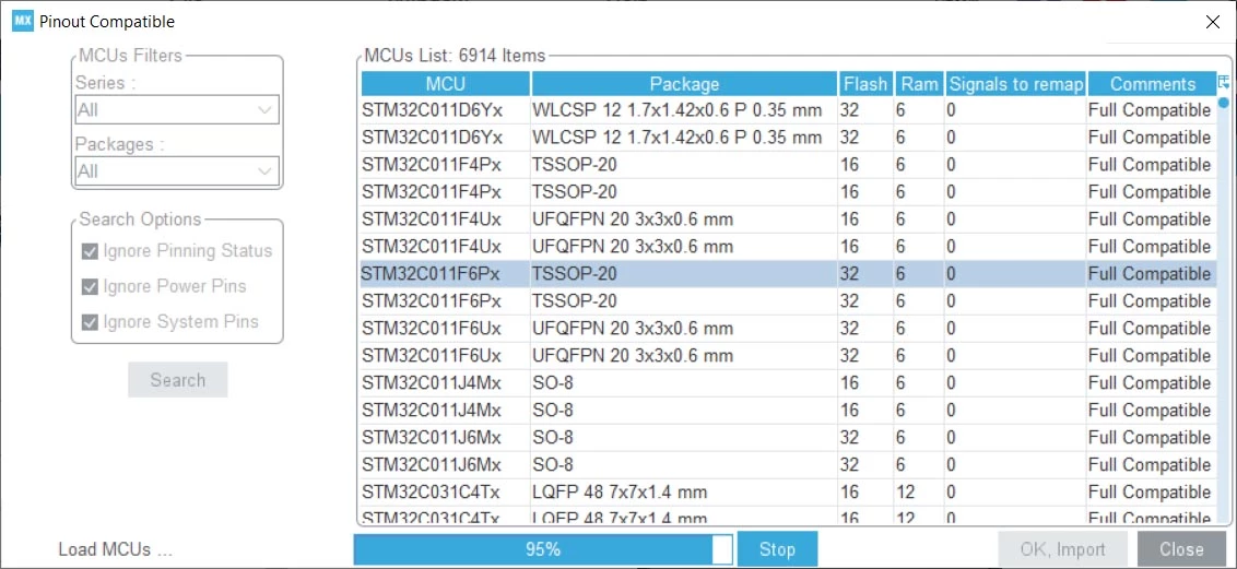

It stops at 95% on two different machines, the Windows Task Manager runs the MX task at 95-100% up until 95% and then goes to 0 "forever". Windows 10 Pro 64bit, all service packs, Intel Core2 and i7, 12GB RAM. Processors used in IOC file STM32F767BIT6 and STM32H750XBH6. EDIT: 6.4.0 seem to behave differently, when i open the List tool it lists a small selection that finishes OK. I can then select another filter, in my case STM32H7, all packages and it then again almost slowes to a halt, giving me a Low Memory warning at about 4M of my 12M total. 6.5.0 defaults to load ALL MCUs and packages which seems to max out java(?) memory at about 3.5MB and then just gives up.

Sara BEN HADJ YAHYA
May 31, 2022
Hello @GoEk​ ,
Thanks for your feedback,
This is a known issue and it will be fixed soon. I will keep you posted.
If your issue is solved, please close this post by clicking the "Select as Best" button. This will help other members of the community find this response more quickly :)
Thanks for your contribution,
Sara.

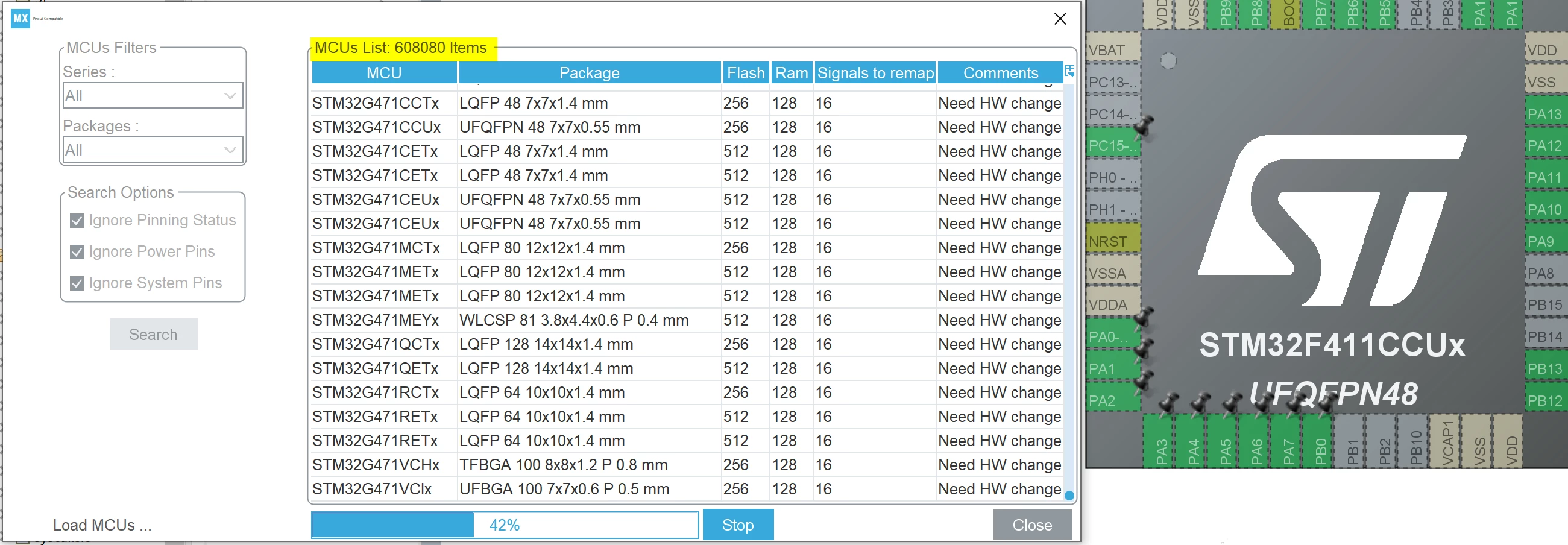

0693W00000NskL5QAJ.jpgAfter a month it is still not fixed.
The processors are extremely difficult to obtain and then this feature fails. The tool finds just over half a million chips in one day. I'm seriously wondering if ST is actually interested in the whole thing.

Hello @GoEk​ , @GLASS​ , @Community member​ ,
This issue is fixed in STM32CubeMX latest release.
V6.6.0 is now available under this Link.
