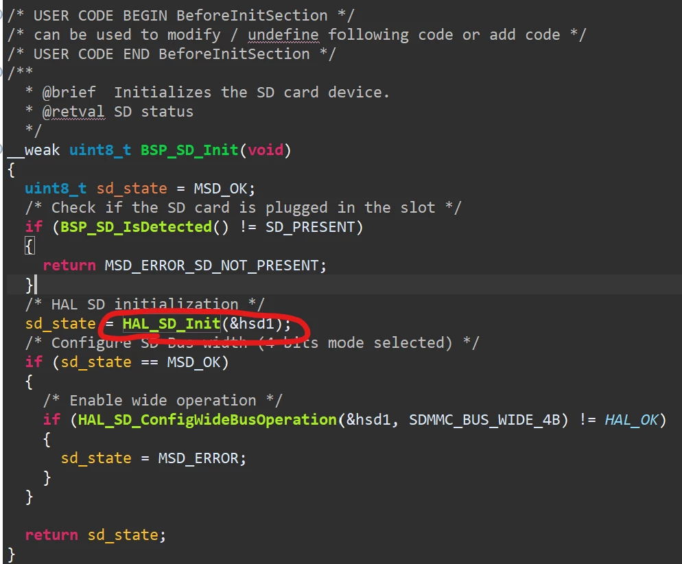

MX_SDMMC1_SD_Init missing HAL_SD_Init
Hi, I'm using STM32CubeMX 6.13.0 and MCU STM32H753VITx.
When initializing the SDMMC1, I am missing the call to function HAL_SD_Init.
void MX_SDMMC1_SD_Init(void)
 /* USER CODE BEGIN SDMMC1_Init 0 */
 /* USER CODE END SDMMC1_Init 0 */
 /* USER CODE BEGIN SDMMC1_Init 1 */
 /* USER CODE END SDMMC1_Init 1 */
 hsd1.Instance = SDMMC1;
 hsd1.Init.ClockEdge = SDMMC_CLOCK_EDGE_RISING;
 hsd1.Init.ClockPowerSave = SDMMC_CLOCK_POWER_SAVE_DISABLE;
 hsd1.Init.BusWide = SDMMC_BUS_WIDE_4B;
 hsd1.Init.HardwareFlowControl = SDMMC_HARDWARE_FLOW_CONTROL_DISABLE;
 hsd1.Init.ClockDiv = 3;
 /* USER CODE BEGIN SDMMC1_Init 2 */
 /* USER CODE END SDMMC1_Init 2 */
Is it a bug? I expected someting like:

TDKBest answer
January 11, 2025
It's done in the BSP initialization here:
3 replies
AScha.3
January 11, 2025
Just write sd init here :
 if (HAL_SD_Init(&hsd1) != HAL_OK)
 Error_Handler();
...if you want init at program start. (Is same on older versions of IDE, so no bug, i suppose.)

Yes, I did, but STM32CubeMX should have generated it on the right place.
