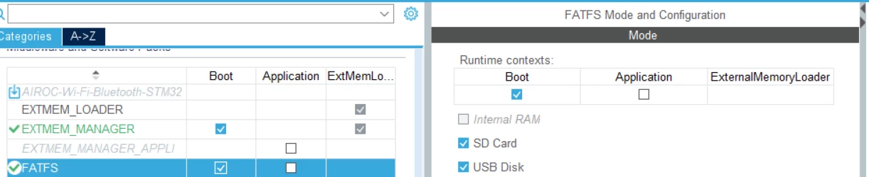

i have enabled FATFS via CubeMX like below
but for some reason in the code generation settings I can’t disable
I want disable it because CubeMX generates a void function; instead, I want the MX_FATFS_Init return a status code if it is generated or not so, I want to have a uint8_t MX_FATFS_Init()

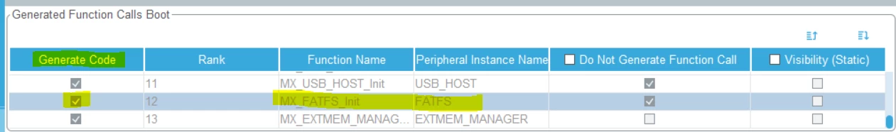

Hi @nico23, and sorry for the late reply.
After checking, this is an expected behavior starting from STM32CubeMX 6.16 version. “Generate Code” option is by default greyed out with the Middleware/Packages function.
Users are able only to activate or disactivate the generation call of the code in the main.c.
There is currently no CubeMX option to independently disable the generation of the MX_FATFS_Init() implementation in fatfs.c while keeping the FATFS middleware enabled.
If you need to use your own implementation, you’ll need to avoid having two definitions of the same function, for example by using a different function name or adapting the generated code within the supported USER CODE sections.
Hope this clarifies the situation.

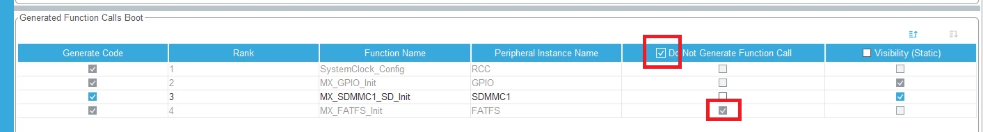

Try the following:

mƎALLEm
Sep 2, 2026 9:30 AM UTC
Check “Do not Generate Function Call” then “Check MX_FATFS_Int” box in the “Do not Generate Function Call” column as I indicated previously. I’ve just tested it and it works.
You need just to check the box for MX_FATFS_Init not others. Uncheck them (others) if they are checked.
This is the generated code:

The FATFs middleware still included in the project.
