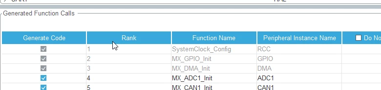

When DMA is used, the MX_DMA_Init shall always be called before any other HAL_***_Init (where *** is any peripheral with a HW dependency on DMA init code).
A regression was detected in the previous STM32CubeMX version 6.3.0 (STM32CubeIDE Version: 1.7.0 ) generating a wrong order of initialization functions.
This issue was fixed in the latest STM32CubeMX version 6.4.0. Thus, newly created project with this version will generate the correct initialization functions order.
Because the calling order is saved into the ioc file, the misplacement call to MX_DMA_Init() remains the same when trying to migrate automatically an old project from a buggy old version to the fixed version. The order stays the same and the generated code will be unfunctional.
For any old ioc file created by any STM32CubeMX version up to 6.3.0 included, hereafter some steps to overcome this misbehavior:
  • Open the saved .ioc file (already created with 6.3.0 version) with any text editor installed in your machine and delete the line: ProjectManager.functionlistsort=....
  • After saving the modification, re-open the .ioc file with latest CubeMX version 6.4.0 ( STM32CubeIDE Version: 1.8.0).
  • Through Project Manager view > Advanced Settings tab, make sure that the initialization functions are correctly ordered and re-generate your project:

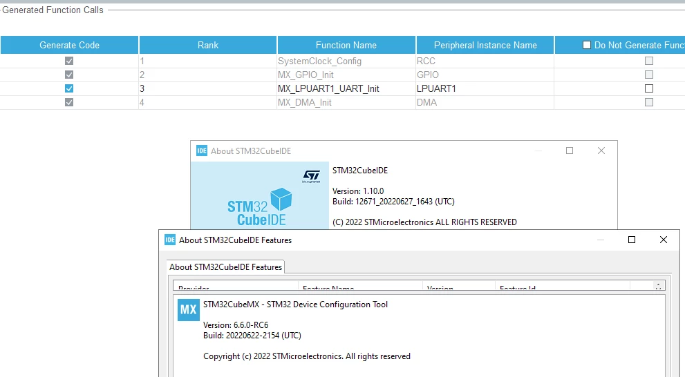

froesel
Jun 30, 2022 2:01 PM UTC
Can confirm, this bug is not fixed in STM32Cube FW_H7 V1.10.0 :

Sara BEN HADJ YAHYA
Jul 7, 2022 9:50 AM UTC
Hello @Florian Rösel​ ,
Did you migrate your project to the latest MX/IDE release (v6.6.0/ v1.10.0) with a wrong order or did you start a new project with the latest version?
Sara.
froesel
Jul 11, 2022 5:59 AM UTC
was able to reproduce this situation in both scenarios - migration AND new project creation.
@Johannes​ 's workaround and his manual editing was the same I did and for now it works. But the original Problem still exists, you have to check manually, if the order is correct.

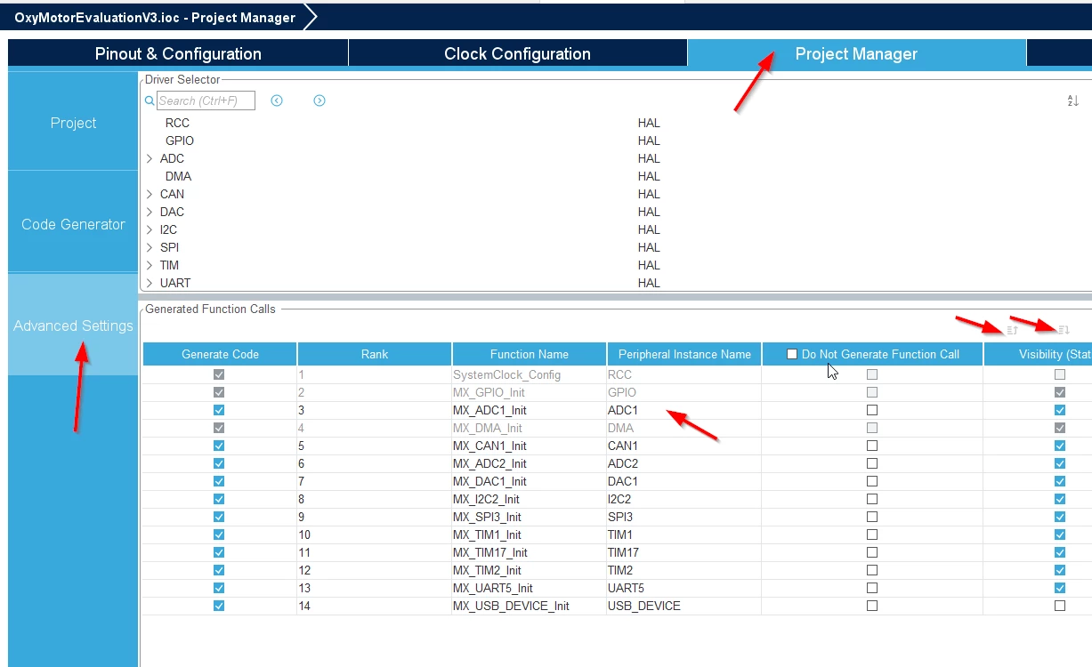

Jul 6, 2022 12:15 PM UTC
The problem still exists with CubeIDE V1.9.0 on STM32L4 V1.17.2
New aspect: I normally can modify the order of initializaiton in IOC file in "Project Manager" / "Advanced settings"
0693W00000QKYosQAH.pngOne can see, that some lines are "fixed" and cannot be modified like "clock" "GPIO" and "DMA".
The Line ADC1 cannot be moved either. For some reason, ADC1 is not allowed to be moved. Others can be moved.
It is possible to edit this sequence though, by editing the IOC-File "by hand".
ProjectManager.functionlistsort=1-SystemClock_Config-RCC-false-HAL-false,2-MX_GPIO_Init-GPIO-false-HAL-true,3-MX_DMA_Init-DMA-false-HAL-true,4-MX_ADC1_Init-ADC1-false-HAL-true,5-MX_CAN1_Init-CAN1-false-HAL-true,6-MX_DAC1_Init-DAC1-false-HAL-true,7-MX_I2C2_Init-I2C2-false-HAL-true,8-MX_ADC2_Init-ADC2-false-HAL-true,9-MX_SPI3_Init-SPI3-false-HAL-true,10-MX_TIM1_Init-TIM1-false-HAL-true,11-MX_TIM17_Init-TIM17-false-HAL-true,12-MX_TIM2_Init-TIM2-false-HAL-true,13-MX_UART5_Init-UART5-false-HAL-true,14-MX_USB_DEVICE_Init-USB_DEVICE-false-HAL-false
 Now it is correct

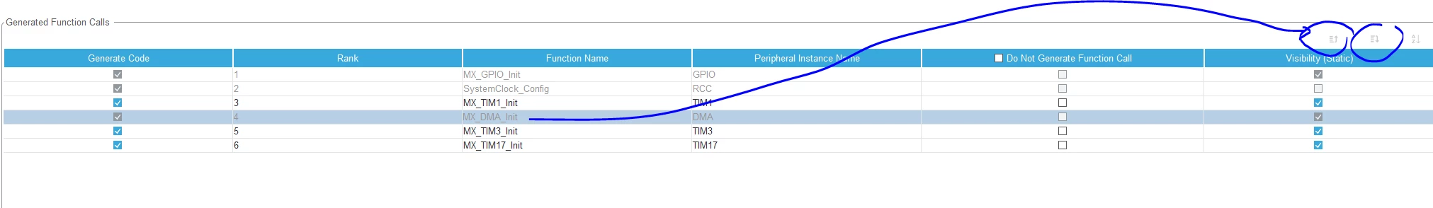

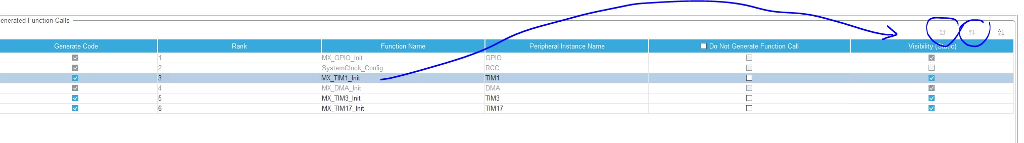

Mar 1, 2023 5:26 PM UTC
@Sara BEN HADJ YAHYA​ I got the same issue with cubeMx 6.6.1
I cannot change the order , for some reason DMa is greyed out and TIM1 cannot be moved neither
For the others TIM3 and TIM17 , i am able to change positions

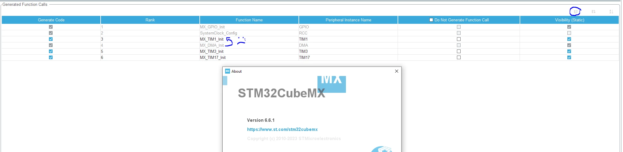

Aug 18, 2022 6:37 PM UTC
This problem STILL exists in CubeMX V6.6.1.
The original workaround of hand editing the .ioc file does correct the issue
Javier1
Principal
Mar 1, 2023 5:30 PM UTC
Not for me, aparently if you migrated the cubeMX from older versions DMA's place in the Advanced Settings menu cannot be changed
