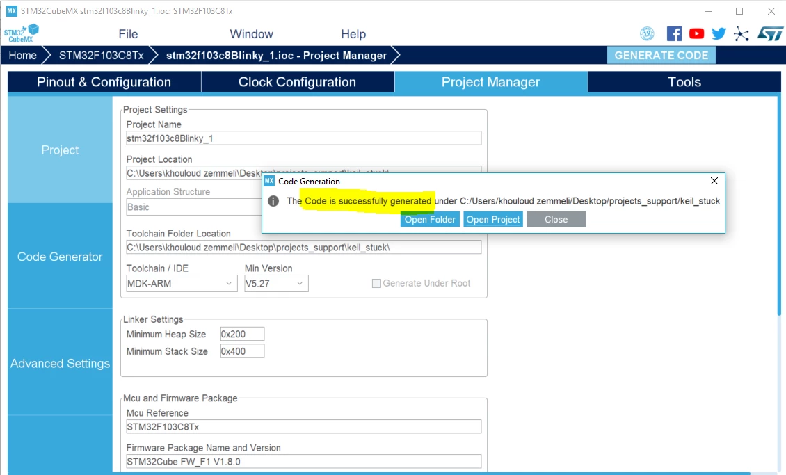

Khouloud ZEMMELI
November 1, 2019
​It works fine for me :

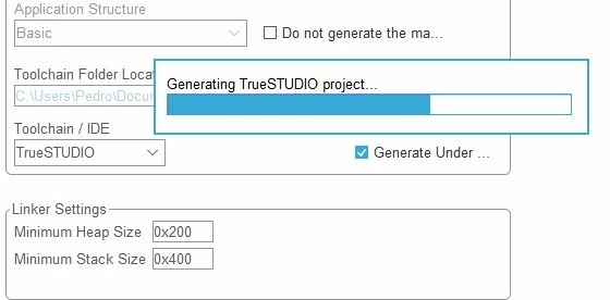

PSant.1
Visitor II
December 29, 2019
0690X00000BvTEFQA3.jpgI have almost the same problem, using version 5.4.0

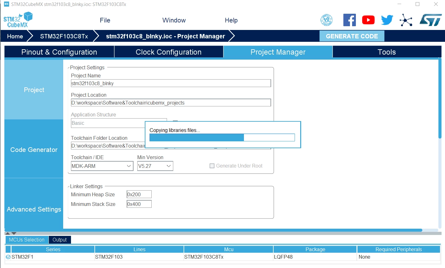

BJunY.1315
Visitor II
February 7, 2020
Do not put & in the file path.
JYan.1570
February 7, 2020
That's it!
I found this problem last night.
Anyway, thank you very much!
