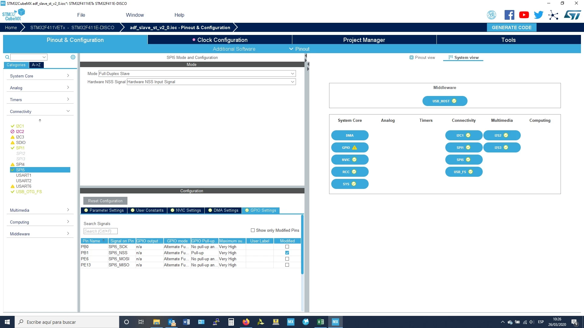

Must I implement the read of the CS signal to receive data in a SPI slave?
  • March 26, 2020
  • 3 replies
  • 1143 views
project details:
  • master: FPGA zynq board, clk freq = 25MHz
  • slave: STM32F411VE board, pull up in CS
  • full duplex tx/rx in both boards
  • slave code generated with cubemx
  • sw4stm32 IDE
  • 20cm jumper cables to connect both boards
  • GND connection beteween the boards
I have understand that in the master (I am using a FPGA) I must select low or high the CS to select the slave (STM32F411VE board), but what about the slave?, do I need to implement something like this to receive the data?

Use the SPI_NSS pin configured in input mode - let the H/W do it for you :)

Hi, I have configured the NSS in this way, so you tell me that when the nss is configured by hardware the function detects it automatically?, I thought this was only when I configure nss in software mode (disabled in cubemx)

void SPI1_IRQHandler(void)
 /* Check OVR/UDR flag value in ISR register */
 if(LL_SPI_IsActiveFlag_OVR(SPI1) || LL_SPI_IsActiveFlag_UDR(SPI1))
 	SET_BIT(SPI1->IFCR, SPI_IFCR_OVRC); //clear over and under run errors
 	SET_BIT(SPI1->IFCR, SPI_IFCR_UDRC);
 	return;
 /* Check RXP flag value in ISR register */
 if(LL_SPI_IsActiveFlag_RXP(SPI1) && LL_SPI_IsEnabledIT_RXP(SPI1))
 /* Call function Reception Callback */
		SPIRxBuf[SPIRxBufHead] = LL_SPI_ReceiveData8(SPI1); // store the byte in the ring buffer
		SPIRxBufHead = (SPIRxBufHead + 1) % CONSOLE_RX_BUF_SIZE; // advance the head of the queue
		return;
 /* Check EOT flag value in ISR register */
 if(LL_SPI_IsActiveFlag_EOT(SPI1) && LL_SPI_IsEnabledIT_EOT(SPI1))
 	 SET_BIT(SPI1->IFCR, SPI_IFCR_EOTC);
 	 LL_SPI_SetTransferSize(SPI1, 1024);
 return;
void GPIOPins_SPI1_Config(void)
 /* (1) Enables GPIO clock and configures the SPI1 pins *******************/
 /* Enable the peripherals clocks of GPIOs */
	 LL_AHB4_GRP1_EnableClock(LL_AHB4_GRP1_PERIPH_GPIOB);
	 LL_AHB4_GRP1_EnableClock(LL_AHB4_GRP1_PERIPH_GPIOA);
 /* SPI1 SCK GPIO pin configuration*/
 GPIO_InitStruct.Pin = SPIx_MASTER_SCK_PIN;
 GPIO_InitStruct.Mode = LL_GPIO_MODE_ALTERNATE;
 GPIO_InitStruct.Pull = LL_GPIO_PULL_DOWN;
 GPIO_InitStruct.Speed = LL_GPIO_SPEED_HIGH;
 GPIO_InitStruct.Alternate = SPIx_MASTER_SCK_AF;
 LL_GPIO_Init(GPIOB, &GPIO_InitStruct);
 /* SPI1 MISO GPIO pin configuration*/
 GPIO_InitStruct.Pin = SPIx_MASTER_MISO_PIN;
 GPIO_InitStruct.Alternate = SPIx_MASTER_MISO_AF;
 /* SPI1 MOSI GPIO pin configuration*/
 GPIO_InitStruct.Pin = SPIx_MASTER_MOSI_PIN;
 GPIO_InitStruct.Alternate = SPIx_MASTER_MOSI_AF;
 /* SPI1 NSS GPIO pin configuration*/
GPIO_InitStruct.Pin = LL_GPIO_PIN_4;
GPIO_InitStruct.Alternate = LL_GPIO_AF_5;
GPIO_InitStruct.Pull = LL_GPIO_PULL_UP;
LL_GPIO_Init(GPIOA, &GPIO_InitStruct);
 /* (2) Configure NVIC for SPI1 transfer complete/error interrupts **********/
 /* Set priority for SPI1_IRQn */
 NVIC_SetPriority(SPI1_IRQn,0);
 /* Enable SPI1_IRQn */
 NVIC_EnableIRQ(SPI1_IRQn);
void SPI1_Config (void)
 /* Configure SPI SLAVE *****************************************************/
 /* Enable SPI1 Clock */
 LL_APB2_GRP1_EnableClock(LL_APB2_GRP1_PERIPH_SPI1);
 /* Configure the SPI1 parameters */
 SPI_InitStruct.BaudRate = LL_SPI_BAUDRATEPRESCALER_DIV2;
 SPI_InitStruct.TransferDirection = LL_SPI_SIMPLEX_RX;
 SPI_InitStruct.ClockPhase = LL_SPI_PHASE_1EDGE;
 SPI_InitStruct.ClockPolarity = LL_SPI_POLARITY_LOW;
 SPI_InitStruct.BitOrder = LL_SPI_MSB_FIRST;
 SPI_InitStruct.DataWidth = LL_SPI_DATAWIDTH_8BIT;
 SPI_InitStruct.NSS = LL_SPI_NSS_HARD_INPUT;
 SPI_InitStruct.CRCCalculation = LL_SPI_CRCCALCULATION_DISABLE;
 SPI_InitStruct.Mode = LL_SPI_MODE_SLAVE;
 LL_SPI_Init(SPI1, &SPI_InitStruct);
 /* Lock GPIO for master to avoid glitches on the clock output */
 LL_SPI_DisableGPIOControl(SPI1);
 LL_SPI_DisableMasterRxAutoSuspend(SPI1);
 /* Set number of date to transmit */
 /* Enable SPI1 */
 LL_SPI_Enable(SPI1);
 /* Enable TXP Interrupt */
// LL_SPI_EnableIT_TXP(SPI1);
 /* Enable RXP Interrupt */
 LL_SPI_EnableIT_RXP(SPI1);
 /* Enable SPI Errors Interrupt */
 LL_SPI_EnableIT_CRCERR(SPI1);
 LL_SPI_EnableIT_UDR(SPI1);
 LL_SPI_EnableIT_OVR(SPI1);
 LL_SPI_EnableIT_EOT(SPI1);
Certainly seems to work. I'm using SPI in receive simplex mode with interrupts buffering the incoming data into a circular buffer and when I disconnect NSS the receive stops as you would expect.
