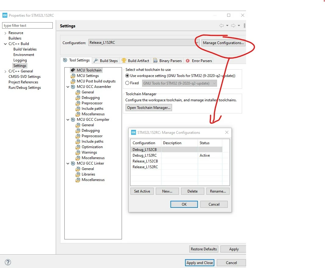

.project & .cproject are Eclipse & Eclipse CDT proprietary files. No way to rename them.
Having one repository per .ioc file is common way of working but yes duplicates material.
Not fully sure about what you're going to achieve but a way if STM32CubeIDE to support multi targets is to be a bit fluent in build configuration setup.
0693W00000FBCqLQAX.jpgTo get some extra help maybe share more details about variation kind you're expecting to support if multi target ?

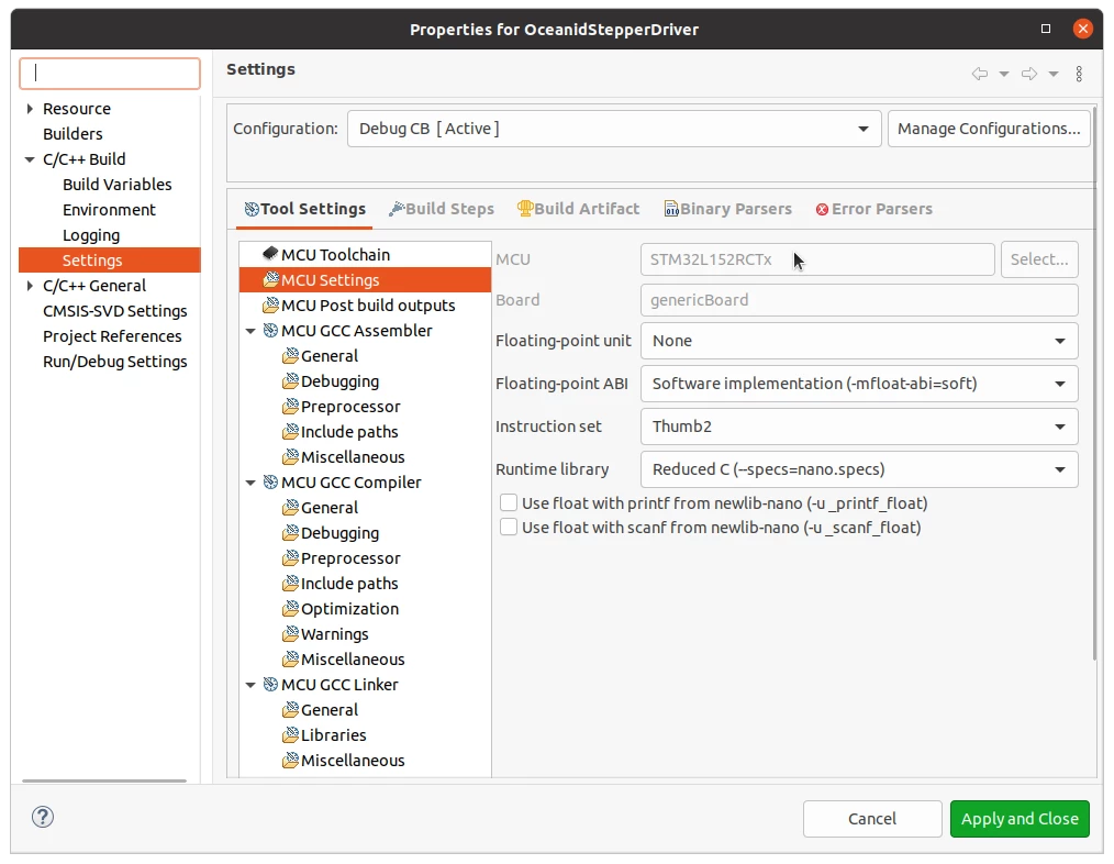

I have a question. The MCU is greyed out. How can I change it? I manually changed the device defines in GCC/preprocessor and MCU G++/Preprocessor, but that didn't change the MCU.0693W00000FBDJ3QAP.png

Update. I was able to get it working. I created targets first (debug and release for my second target, based on those of the first target). Then I manually edited the processor references in the .cproject file. I changed STM32L152xC to STM32L152xB. I changed STM32L152RC to STM32L152CB. I changed the flash load file. I had to add one header file: stm32l152xb.h and one load file: STM32L152CBTX_FLASH.ld.
