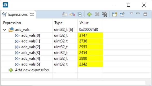

I am trying to perform a multi-channel ADC read from the Nucleo-F091RC board and having difficulties, see attached for my efforts. I observe floating read values for all channels, see attached for description & example -
Attached Debug Info:
  • 'main.c' - main routine from project
  • 'TestKit_ADCDebug - project.zip' - the project
  • 'demo generation notes.txt' - detailed debug description
  • 'Debug Read Example.png' - example debug result
How can I make this successful? What is the issue here?

When installing STM32F0 cube libraries, you'll find projets examples for F0 and one folder shall be ADC.
Get started or windiff your project with closest matching example.
If the ADC input pins are not connected to anything, try to connect it to GND or VDD and see if the values are changing from min to max (0x000 to 0xFFF if 12 bit right shifted ADC)
Currently some examples are not generated from CubeMX (they don't have *.ioc project file in the sample folder). If the example works in debug mode, take a snapshot of the ADC and DMA register settings if you'd like to move to MX later.

 Thank you for your thoughts, I think this is a good approach. I have opened the 'ADC_Sequencer' example, how can I apply an analog voltage to 'ADCx_CHANNELa' and observe the measured result? I have disabled "WAVEFORM_VOLTAGE_GENERATION_FOR_TEST" and am currently observing floating values
Firmware Config:
  • ADC_Sequencer (STM32Cube_FW_F0_V1.9.0)
  • Disabled 'WAVEFORM_VOLTAGE_GENERATION_FOR_TEST' (main.h:55)
Hardware Config:
  • NUCLEO-F091RC (STM32F091RC)
  • Analog Voltage applied to CN7.32 (1.5V, PA4)
Result:
  • Voltage application not working, appears the Nucleo is driving pin to 0.0V
I have tried a multitude of other things and done much research, what is up here, how can I apply a voltage and measure the result? Why is this so hard?
