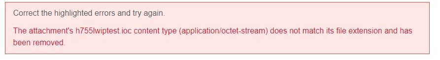

Since forum's form still don't recognize my .ioc I tryied to compress it in a .tar.

@TDK, I would like to attach my .ioc there but I get an error...
Moreover seems there are more then 3 file attached, but I can't clean this section....
I will try in the next post... sorry!
